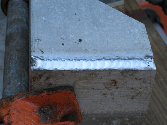

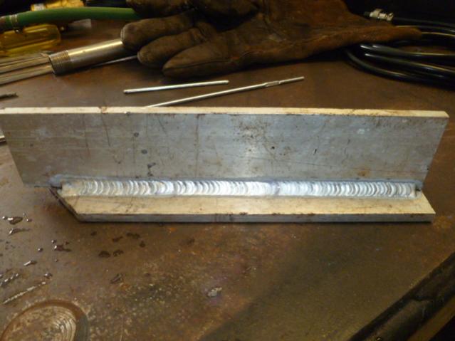

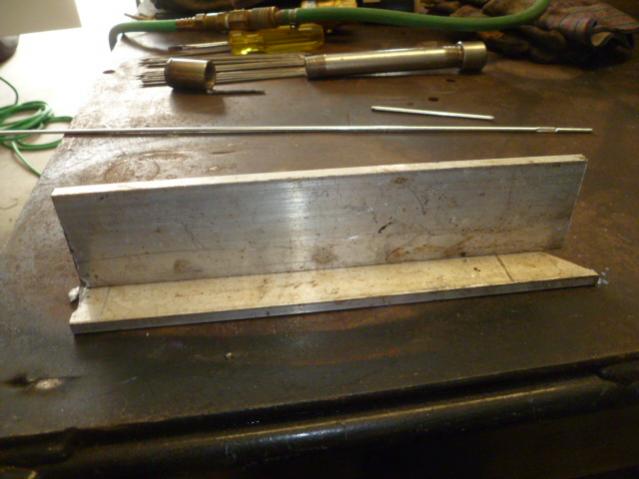

    this is real easy if you let it be.
    1. if the metal is really dirty just weld it the way it is.
    2. if dirty aluminum is not going to work for you then order some new aluminum and weld it up.
    3. or, spend all your time trying to devise a new way to make your welds look better without actually practicing the welding part.

    the long fillet was done as a test after i had drained, cleaned and refilled my cooler; as well as cleaning the torch head and installing a new power cable.
    there are two tie ins, i took the pic while testing my camera.
    just checking for leaks basically. that aluminum has been in bin since 2008 and it was dirty when it went in.
