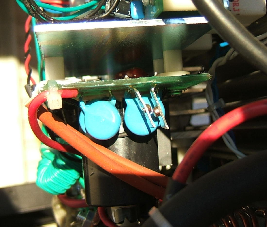

    Well I have not used the plasma part of my power pro 256 until tonight I hooked it up and gave it a try. Usually we just grab the torch or a smaller parker plasma if we need. Since I have not used mine before I figured I would give it a try and ran into some problems. I had it set at 35A then 50A and 60PSI and 80PSI line pressure to cut 3/16 plate. I figured between those settings something should cut this like butter but was denied. In my frustration to get it working I decided that I would take the guide off and I finally got it to cut by pulling the trigger, tapping the tip to the metal and then pulling it back up a tad. If I did not tap it down it would not blow through. At 35A it hardly left a gouge and at 50A it went maybe half way through..
    Now when I got the machine I had weird issues with it not starting up correctly(made a buzzing sound and had an orange? light on).. This went away after turning on and off the machine 3 or 4 times. I did notice that with the stock TIG torch I had a hard time getting the arc to start but also had something funny with the torch going on. I hooked up a WP20 and only had maybe 2 bad arc starts or so..
    My question is, does this sound like its the points or sound like the machine is having a problem some place. I opened it up and did not see anything really wrong in my quick glance. I couldn't locate a set of filler gauges to check the points so I will have to purchase a set here soon.

    It has an arc when pulling the trigger but wont cut unless I tap it and I would rather not do it that way and would like to fix it. Thanks for the tip on the bank card.. I will probably pick up a set of filler gauges as I should have them for building cars and working on machines anyways. I will keep the tip in mind for the next time I am without gauges and need ~30 thous.
    If you have pilot arc, then I would check your ground clamp.
    Which torch? I'd check the clamp too. Take cable loose and shine things up or borrow one from another welder you know is good.
    Did you check the gap on the points? If they are two wide you can get a pilot arc, but the arc transfer for cutting might not happen. You are probably cutting with the pilot arc and not the cutting arc. Next time you are at the unit, give a call into tech support.
    The plasma torch is the upgraded one. I attempted to check the points but could not locate the feeler gauges so I need to get a new set. I will grab some and try all these suggestions. The ground clamp is pretty clean but I will see if I can try and get it better. I am not sure that I will be going to the shop today or for sure this weekend as I will be busy but I might run up just to look into this. If not it will be next week sometime hopefully. If I am still having problems I will give a call to support. Thanks..
    You can use a credit card to set the points, should be a tad loose, that is be able to fall out. Also, clamp in the + side if not labeled.

    It would seem that if you can tig with out problems the gat could be all right. I still would check the gap. Attached is what my points looked like when I opened mine up and after I straightened them up.

    I used the machine in TIG form and managed to get the arc starts on the TIG pretty close to perfect but have not tested the Plasma again yet. The problem I found was extremely hard to spot from the side. The point on the inner side of the machine had a very slight twist but was perfectly inline from the side with the other. I managed to twist it pretty close to straight and set the gap at .040 which seems good enough to me and starts an instant arc almost every attempt. One thing I noticed now is it started to burn an electrically component. I assume that maybe the arc wandered off the points to it...
    Here is a pic.
    I will post back again later after I get to testing the plasma.
