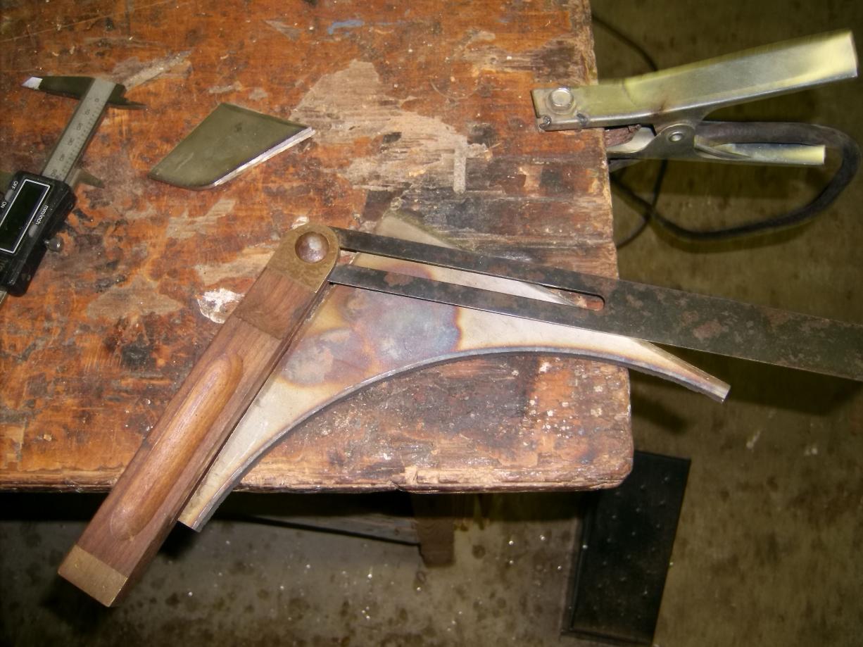

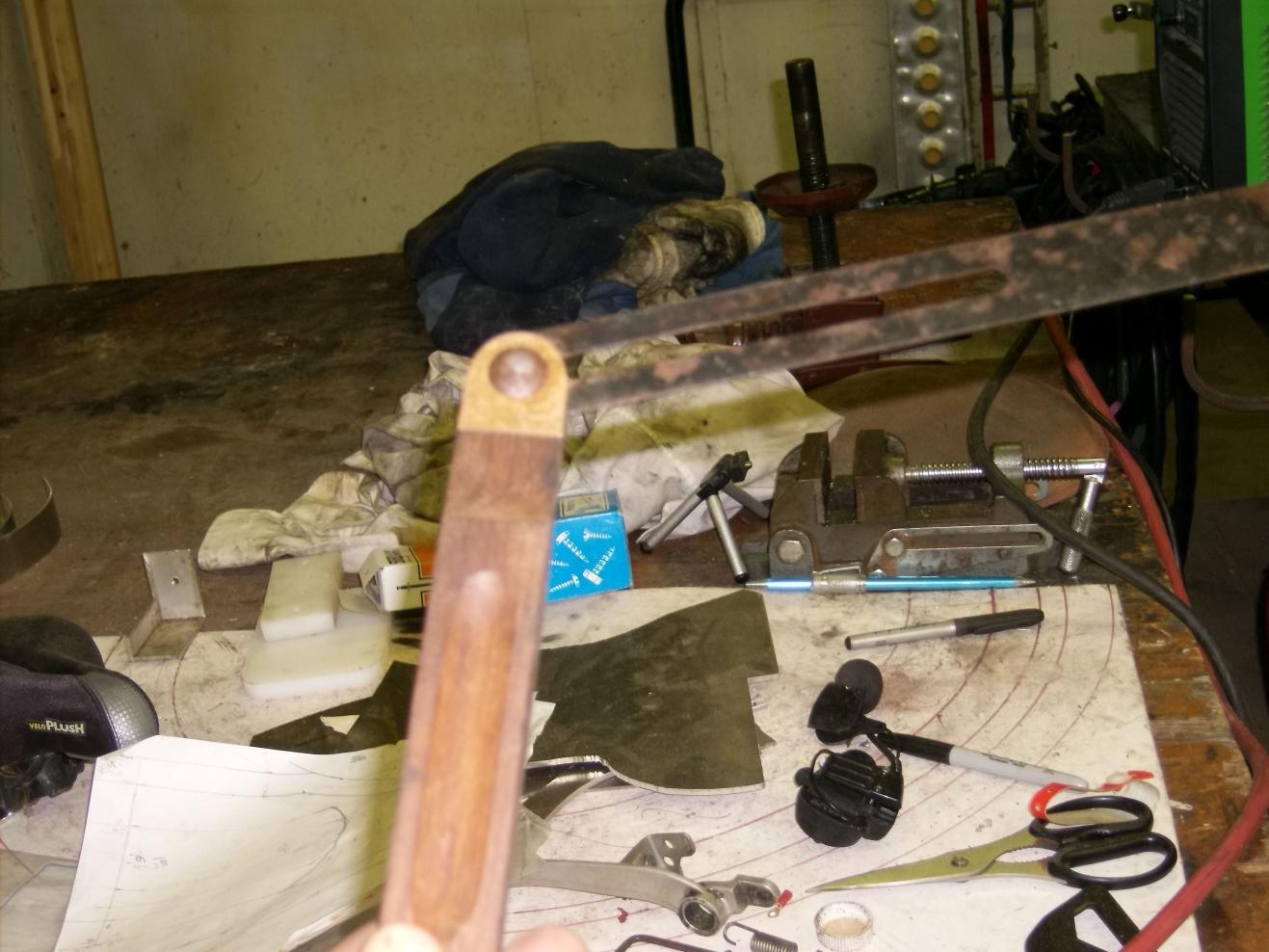

    Here's the start. The bevel square is set to the angle between the horizontal leg of the Ossa Swingarm (top edge of stand bracket) and the front edge of the stand bracket. The stand needs to pivot far enough forward that the spring will over centre and hold the stand firmly in place when down. Same at the up position, the spring over centres again to hold the stand up.

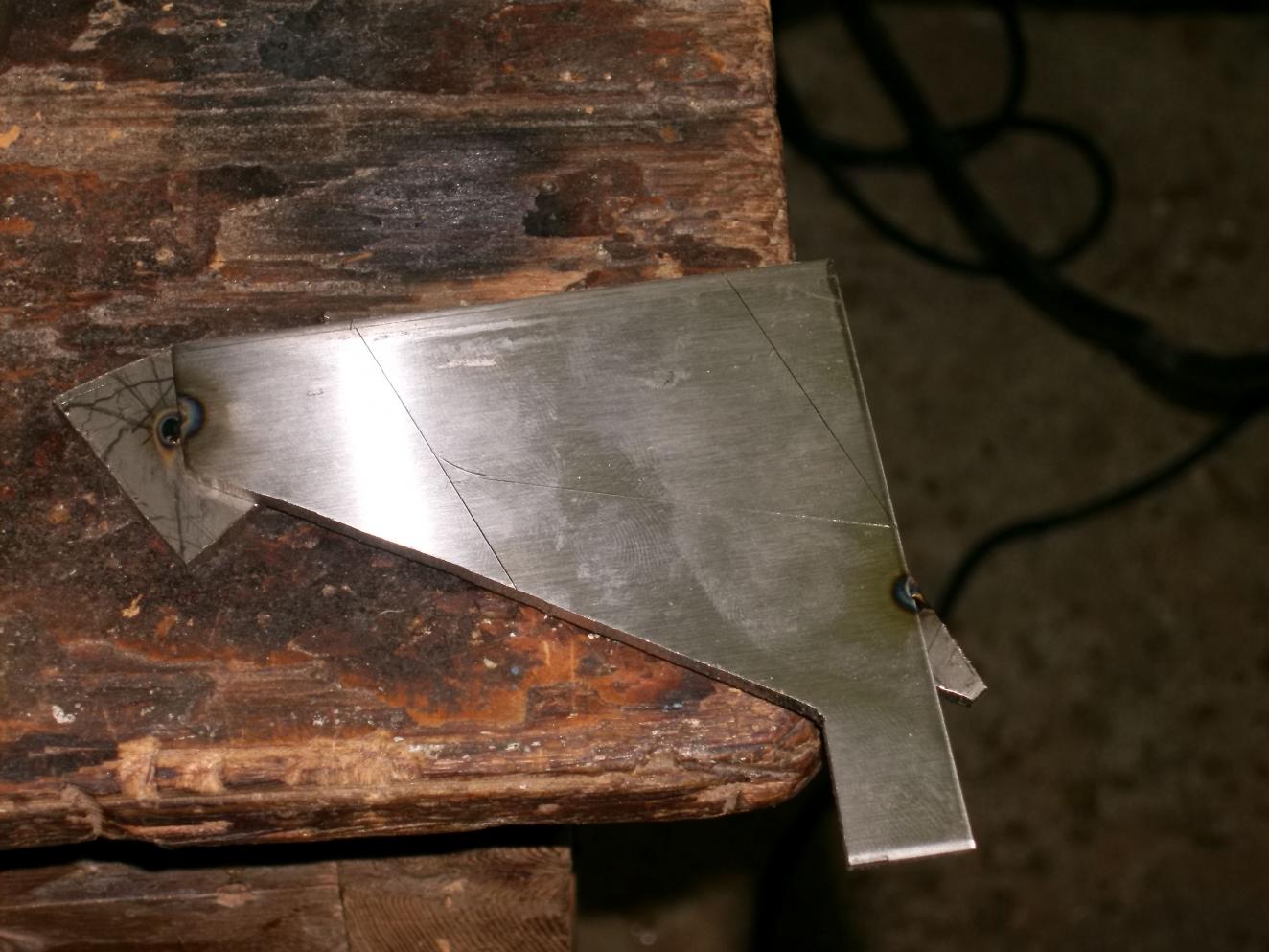

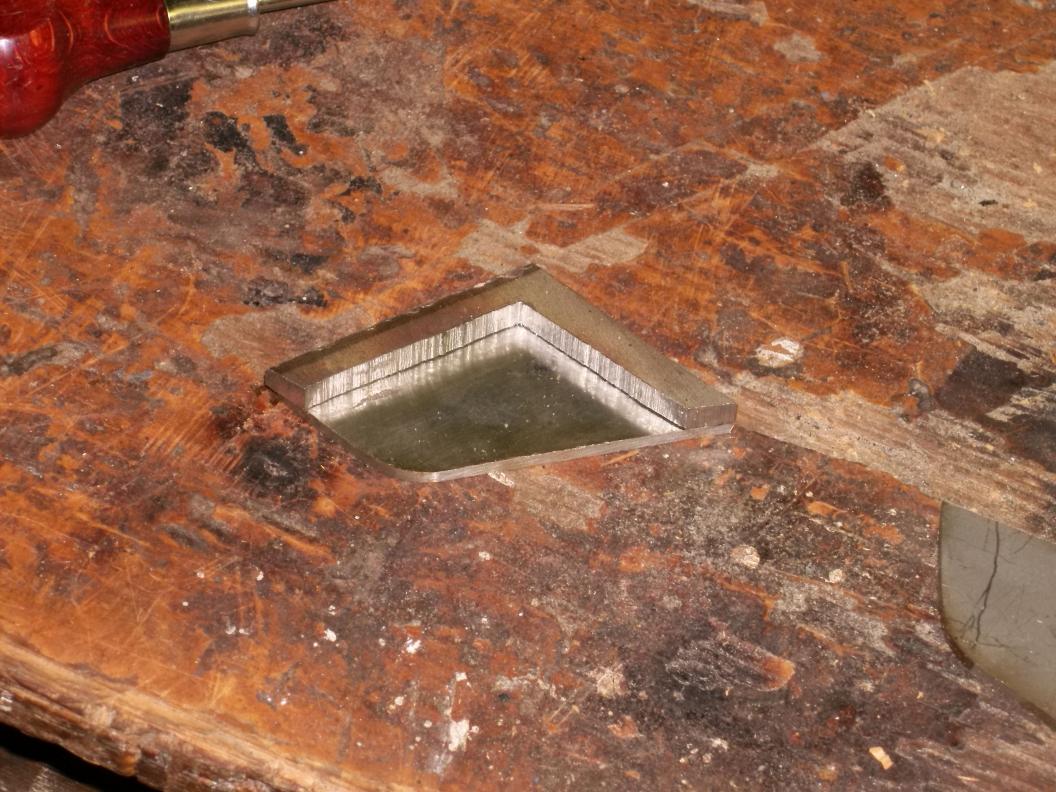

    The first photo shows the side plates for the bracket after cutting. I tack welded two thicknesses (1/8" ea) together and cut them at the same time.
    Sandwiched in between the two side plates is a piece of 1/4" thick stainless that is shown in the second photo. It will form the mortise for the stand top blade to fit into and will also be the up and down stops. I made it 3/8" wide and it has the same angle from front to top as the side plates, which is the angle taken from the Ossa via bevel square.

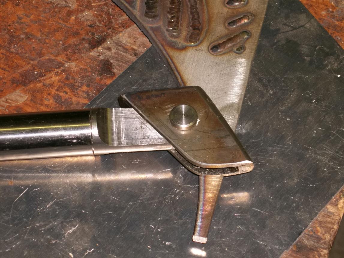

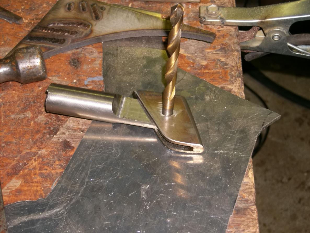

    The first photo shows the 1/4" thick piece being cut to shape. The third and fourth photos show the completed bracket after welding and grinding the front edge round.

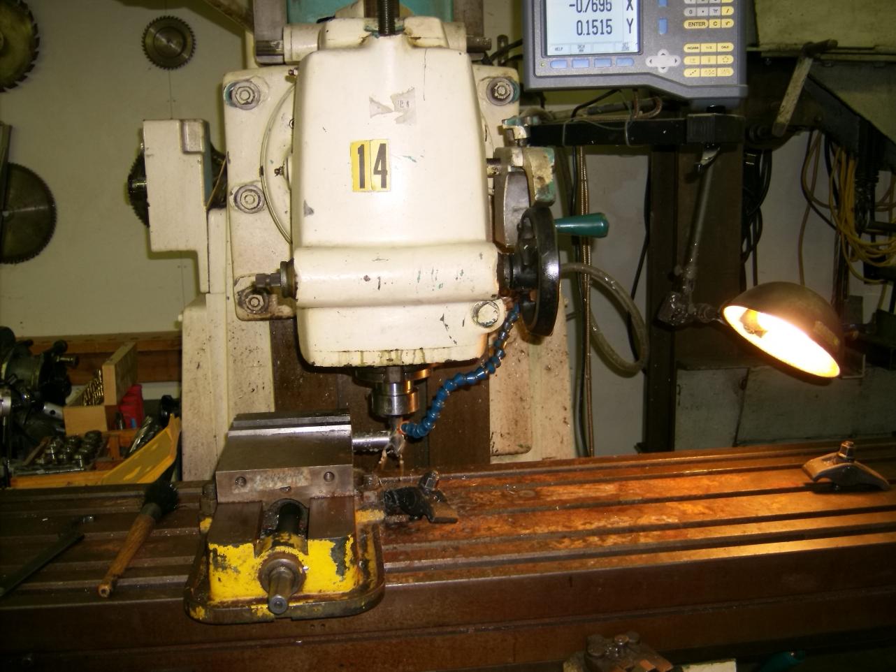

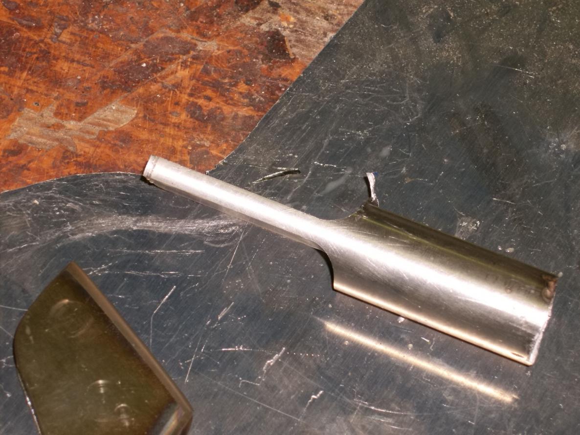

    Next I milled a short piece of 1" thick round SS to form the stand blade. This fits into the bracket as shown in the last photo.

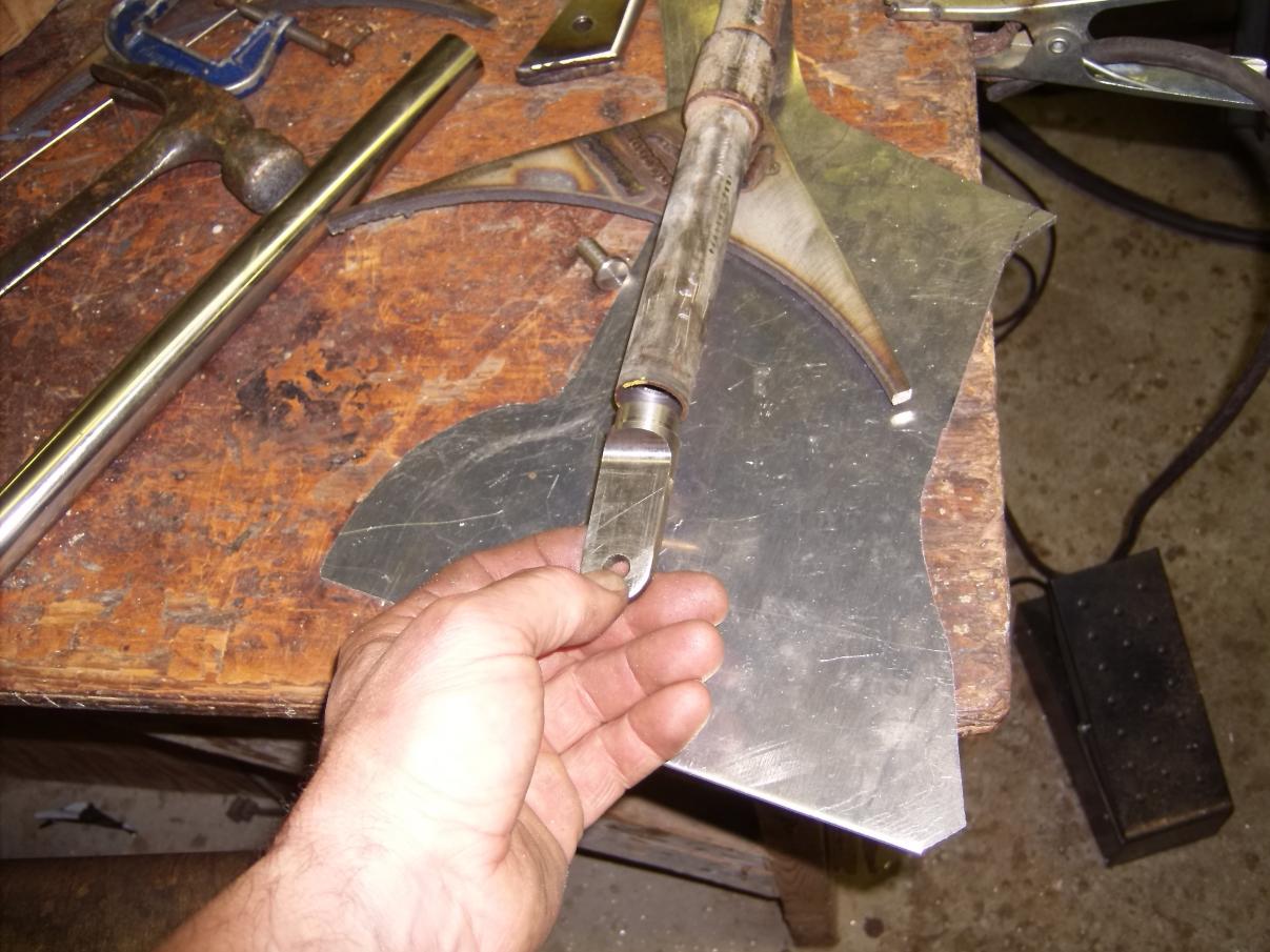

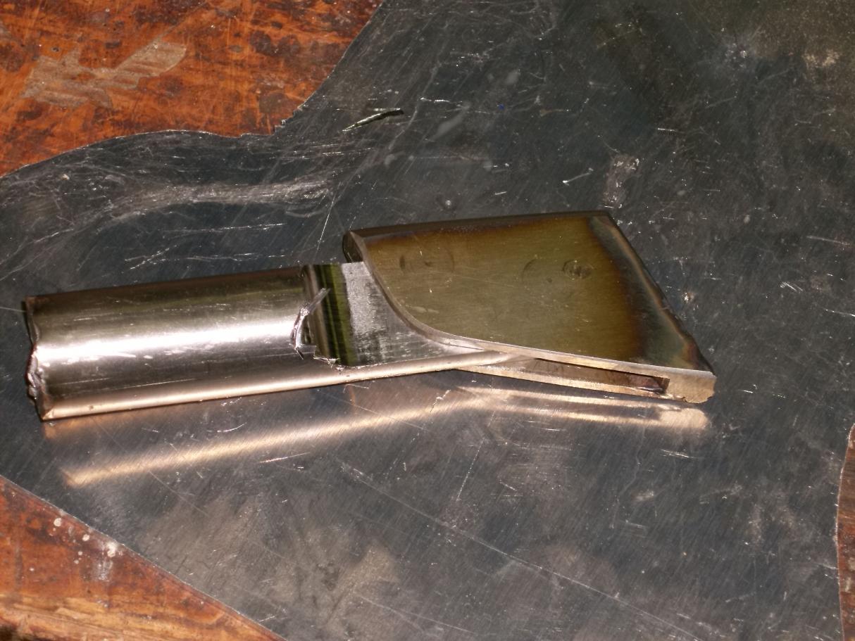

    The first two photos show the stand blade in the up and down position. The fifth photo shows the blade after being cut to length and turned down so that it fits inside the 1" SS .065 wall side stand tube. Here I am fitting it into a scrap piece of 1" water pipe that I bored out at the end to be the same ID as my finished 1" SS tube. I used the water pipe to cut first as a template in order to determine the proper length and bottom angle to cut on the finished 1" SS tube.
    The last photo shows the top edge of the bracket after I machined the welds down and curved out the material so that the bracket would fit nicely on the radius that is on the flat sided oval swing arm tube.

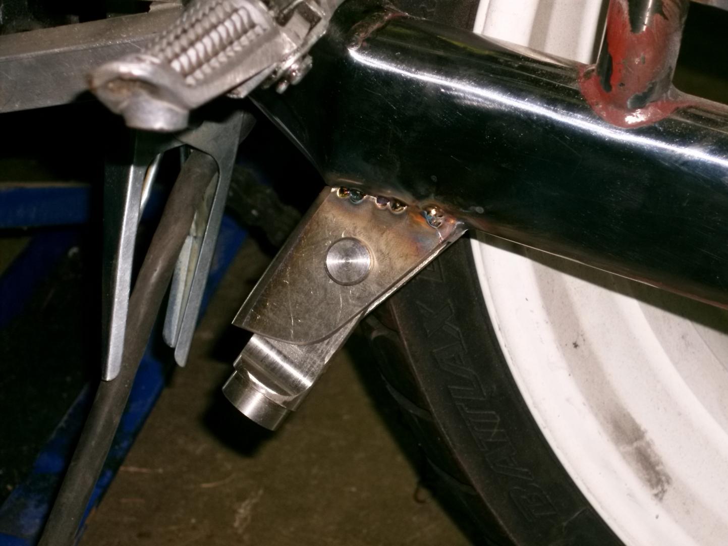

    The first photo shows the bracket tacked onto the swing arm. Next time I have the swing arm off Iwill do the final weld for this on the bench. The second photo shows the stand blade welded to the 1" tube.
    The stand still needs the spring added, but I will wait for a Stainless Steel one to arrive before making the attachment points for that. I'll also add some sort of a peg that will make it easy to pivot the stand into the down or up postion with the left foot.
