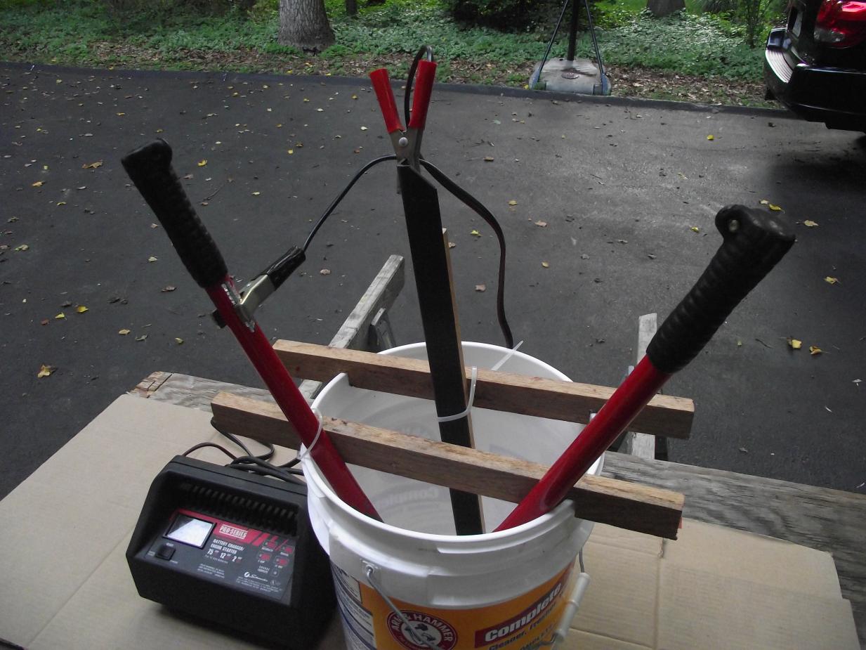

    ~ an automotive battery charger, 2 amps or greater, preferably with an ammeter
    ~ a non-conductive container
    ~ sodium carbonate, commonly found as “washing soda” by Arm & Hammer. I got some online at SoapsGoneBuy.com but you can also use baking soda.
    ~ an anode: a piece of unpainted iron or steel to provide the electrical connection from the battery charger to the electrolyte fluid
    Remove any oil / grease / dirt from the rusty part. Use a tablespoon of washing soda per gallon of water, and mix up enough to immerse the rusted surfaces of your part in your container. Clip (or electrically attach) the black/negative lead of the battery charger to the rusty part; clip the red/positive lead to the anode. The rusty part (the cathode) and the anode should not touch, but instead should be separated by 2 inches or so of electrolyte fluid.
    The process works best when the anode’s surface is parallel to the rusted part. You can get creative by using an anode that bends to match the contour of your rusty part. Surface area and line of sight are key.
    Turn on the battery charger: the ammeter should indicate a flow of electricity and bubbles should appear on both the anode and cathode. Time required in electrolysis depends on how bad the rust is. You may need to rotate the part to give it line of sight exposure to the anode.
    The rust will turn from orange / red to grey or black; you can remove this with a scotch brite pad. Paint your part or take steps to avoid future rust.

    ~ The setup: my battery charger, connected to a length of angle iron as anode and rusty bolt cutters as cathode

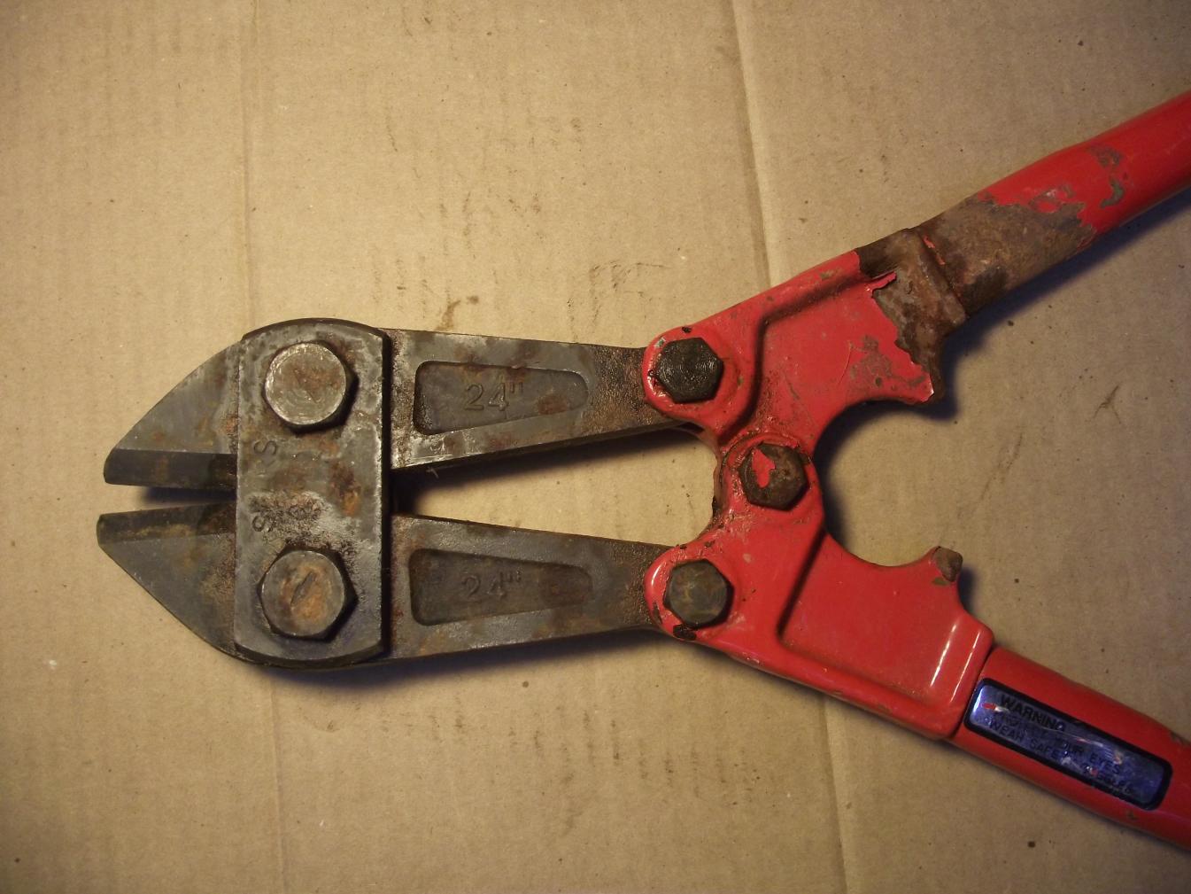

    ~ “Before”: my rusty bolt cutters

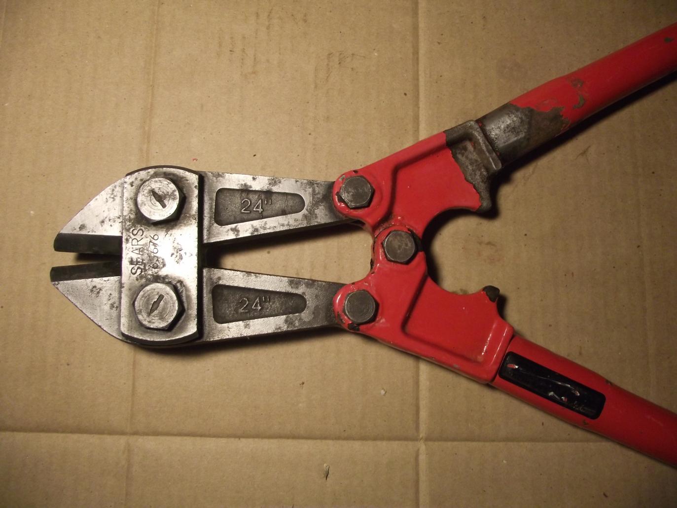

    ~ “After”: clean bolt cutters, after an hour or so in the process. This was probably too long, could have been 30 minutes or so.
ID:	2527Click image for larger version.
ID:	2528Click image for larger version.
