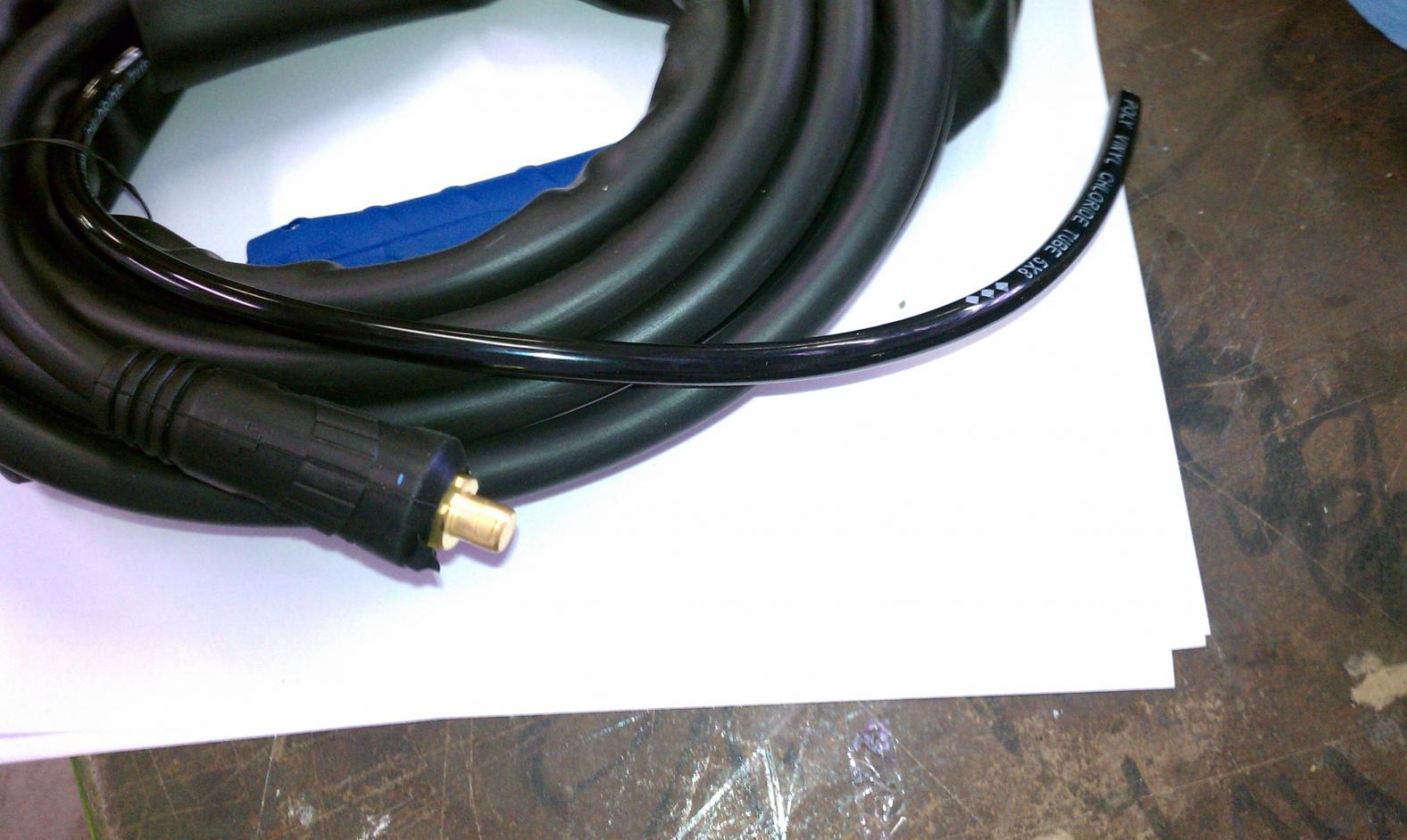

    Well, Kalikov, you have made some waves with all your questioning, unitentionally, I am sure. No problem though. I hope this will finally and once and for all answer your questions. However, I'd suggest you look up some information available through many web based resources on basic tig welding and connections for thorough understanding.
    1) You will still HAVE to have a regulator. You will have to purchase it. A regulator from a lws will have a 5/8" CGA fitting. One from us will have a hose with no fitting at the end (or just the regulator). Either way, with both regulators you will have to make a connection to the hose. You cannot hook the tank at 2000 psi directly to the hose. It must have a regulator.
    2) The unit is a lift start tig, and in this configuration, it has a live tungsten at all times so when it is touched to the metal it will arc. Look up "lift start" tig on the internet. It will tell you the technique. Too much to go through here. Its a simple thing, but there are plenty of graphics out there illustrating this.
    3) You are going to need Argon, Tungsten, a regulator, and a couple of couplings/fittings to hook the regulator hose to the end of the tig torch and possibly a hose clamp or two.
    4) The torch controls the gas on / off manually through twisting the gas valve. There are NO solenoids on this unit to control the gas. YOU control the gas with your fingers by twisting the valve to turn on or shut off the gas. It has NOTHING to do with needing a regulator. Its a common setup. Trust me.
    I am going to post the end of the torch so you can see the fittings yourself. One is power, the other is the gas line. The power has a solid brass connector that hooks to the machine. The other end is a open ended, fitting-less hose. Its about 3/16 of an inch.
    No, it is not designed and cannot operate with a foot pedal. You set and control the amperage on the panel.

    Quote Originally Posted by Kalikov View Post
    SO.... the Argon tank itself will be hooked to the torch cable itself through the regulator and will not be run through the machine itself?..... Correct?
    that would explain not having a connector on the machine for the gas.
    Kalikov
    Just read your last post and was about to respond, then I saw you see why two connectors. No reason to run the gas through the unit and run the cost up and add connectors. And lift start, no switch connector on it either.

  9. Default Thanks to all.....
    I want to THANK everyone for their HELP.
    I am also sorry for any confusion on my part or upsetting anyone.
    $244.99 shipped for the basic package..... Is a GREAT price. + the 5 year warranty....
    I already have a LARGE argon tank.
    The consumables and the regulator are all that will be left.
    Just to clarify though the hook of regulator......
    TANK-----REGULATOR-----HOSE FITTING-----HOSE------HOSE FITTING------HOSE GOING TO TORCH.
    Do I have this setup right?
    ALSO,.,.,., one other question..... Any idea on WHEN the manual for the 140ST will be finished?
    KALIKOV
    PS.... I plan to do some internet searching on LIFT START TIG WELDING.
    And I will also investigate the tig 185 as well.
    Kalikov,
    You got it.
    No one was upset, we just needed more information to answer you. And you asked on other forums as well, making it redundant. So I basically shot-gunned your questions with all the answers I could think of, then Mark did the same.
    The unit sounds like what you are looking for from your messages, I threw in the TIG185 as the next jump up, but the price jumps too. The 185 is a compact unit as well.
