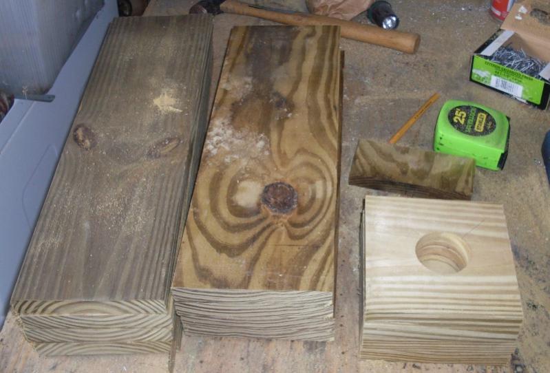

    been looking to build some weasel boxes - but we have had and outbreak of chipmonks this year so I ordered 2 dozen rat traps and built some boxes today
    3 1x6" 12' will work out to 4 boxes with just a little left over. The opening is a 2" hole, and the top and bottoms are 19.5" long and the sides are 17.75 and the 2 ends are 5.5" Pretty simple project but was a good way to get my little helper involved.
    board all marked up ready to be cut

    the 2" hole

    all cut up

    When the rat traps come in you set 1 and each end with the trip plate towards the the opening. 2 traps in each box with some bait in the middle

    the 2" hole might be a little tight for squirrels, but if you just using it around the house go ahead and make a bigger opening. As for the height its only 7.5" tall, you dont want to go too small other wise the trap bar wont be able to swing closed. I have been using peanut butter and its seems to work well.
    For my next batch I am going to use a 1"x6" 6' dog ear cedar fence. This should cut down on some weight, so getting them out into the woods wont take as many trips. Also going to add a hinge and a hook and loop to help keep other anaimals out of the box.
