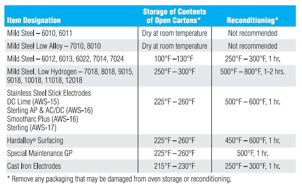

    Question
    Good point Geezer.
    I have questions relating to stick welding electrodes:
    1> What is your favorite online supplier of rods?
    2> 7018's take on moisture fast, if I pack my rods into a container filled with rice, could this be a poor man's way of slowing this down? (Rice is very absorbing. We put it in salt shakers all the time and it works good.)
    3> Moisture is the main thing that degrades electrodes, hence the need for re-baking, correct?
    4> What is your favorite local supplier?

    I don't have a favorite supplier, I give them all a chance to stick it to/in me,I keep all my rods in containers and only cook up the 7014 and 7018 ones on the fry pan or the overpriced and utterly expensive variable heat rod heater I bought . I only have about 100 - 120 lbs of different rods on hand at any one time, so storage is not a problem.
    you are right mositure is the killer on 70 series rods, keep the containers closed and preheat before use if possible.
    I know it has been asked before on this forum, although at this time I am unable to find the thread with the info in it. What is a good temperature to bake them at? Also, how hot is too hot? Is 175-180F* too hot?
    Well that is widly different kinda on preference. I use a little toaster oven that i keep in the garage just for it. I just crank her on about 300. In about 15 to 30 minutes they are good. And then turn her down to like 150 and keeps them good and dry untill you are done welding. But too hot is more than a oven can do. Ive read some people use like 500 degrees. I would keep her about 300 or so though. And anything over 112 degrees will work cause thats when the water will start to evaporate out of them but it would take a while at that so 150-300 i would say
    Ah, okay. our wood burner has a storage panel in the front that stays dry and is between 150-200F* just about year round. So that would be good spot for them! Think I'll pop some in there now for the weekend. Thank you.
    I found a guide for electrode storage and reconditioning at the Hobart site:
    http://www.hobartbrothers.com/downlo...lines/487.html
    It looks a lot like this photo:
