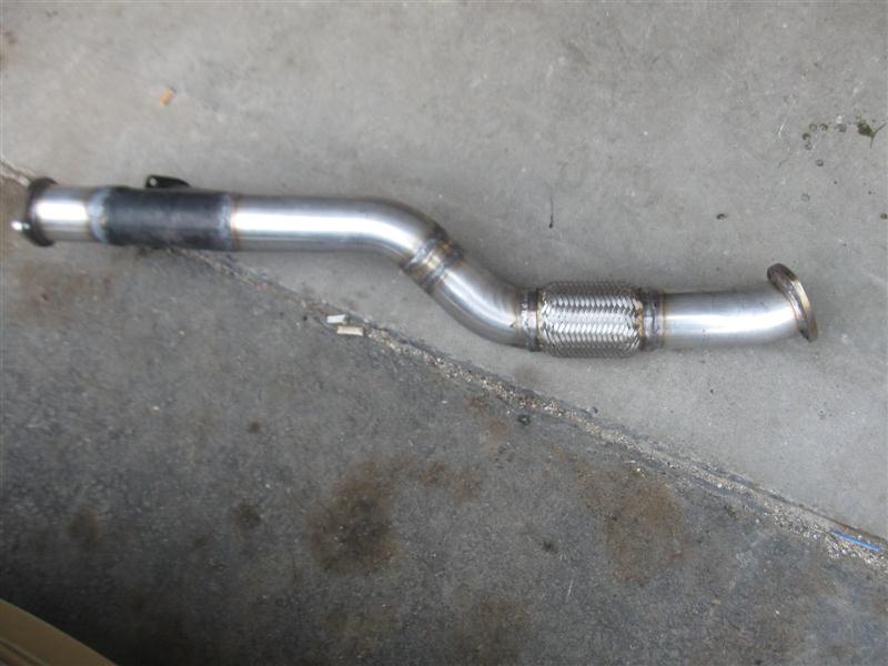

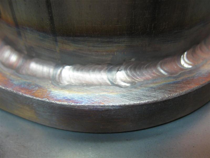

    Hey all, here are a few pics of an exhaust I'm working on for a friend of mine.
    3" 304 (.055 wall) stainless mandrel bends that he got from jegs.com
    3/8" stainless flanges
    6" stainless flexpipe
    Used mild steel exhaust cutout
    Welding it up with my powerpro 205
    2% thoriated 3/32 tungsten ground to a point
    ~65 amps to weld the pipe to the flange, and flex pipe, ~ 40-42 amps for butt welding the pipes
    308l 1/16" filler for everything except the cutout for which I'll use 309l.
    On to the pics!!!

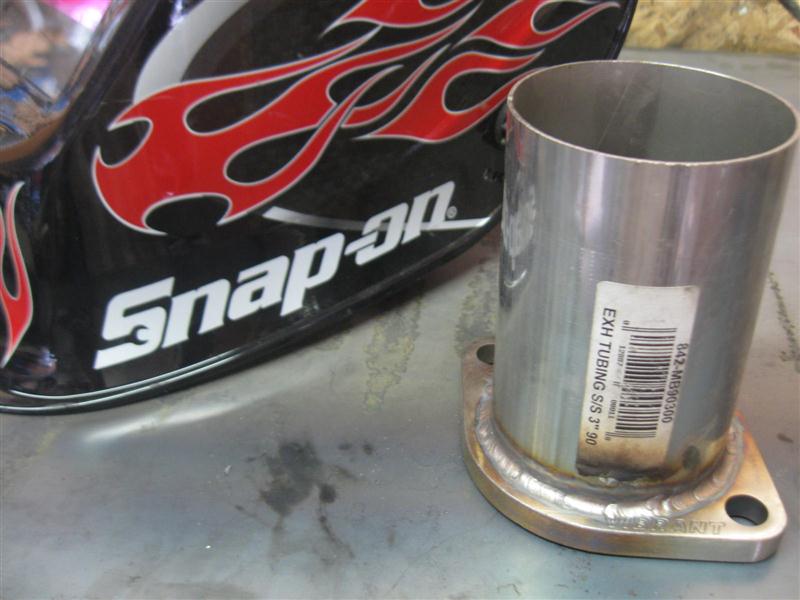

    The flange welded up
    This is about 3/4 of it, ran out of argon, so I'll get a refill tomorrow, and weld on the cutout and another flange to finish it up.
    I'll post more pics when I finish it!
    Got a little crazy on the flex...lol still, not increibly bad for t total noob, it's my first real project

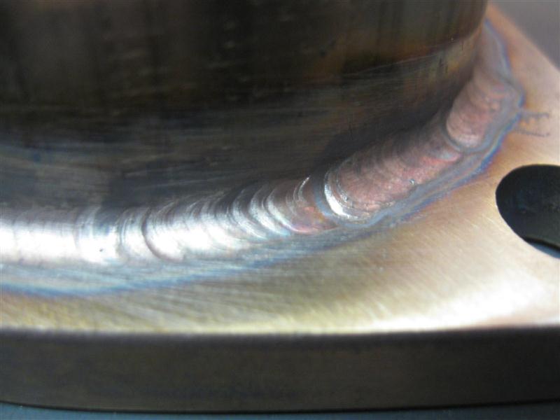

    thanks again, geezer...its not my first exhaust build, i've done a few of these b-pipes before, but its my first that is tig welded. fit up is definetly alot more important with the tig i've noticed, its not as easy to fill the little gaps with weld like i used to do with the mig..lol
    anyway, like i posted last night, i welded a section of 2.5" 304 stainless pipe (.065 wall) to a 2.5" flange, to mate to the rear section of exhaust, and definetly noticed a big diffrence between that and the thinner .055 wall stuff that my buddy bought to build the b-pipe with.
    welded this part up with ~ 70-77 max amps, with the footpedal controlling the heat input, i was having a bit of a struggle getting it to melt into the flange with less amps.

    Nice work! Close ups of your lap and fillet welds show yoy are getting some really good fusion there, and not a whole lot of oxidation either (something many strive for, whether actually necessary or not.) That exhaust system is going to last the lifetime of the vehicle.
    What is your inert shielding setup? (cup size, gas lens or standard collet body, flow rate?) Any solar fluxing on the butt welds?
    Thanks, man! Did another one earlier today that I am reallllllly happy with, I'll post pics a little later.
    Using the standard gas lens and cups that came with the welder, #7 cup, ~10lph or whatever it is, and using solar flux mixed with meth on the inside of the butt welds.

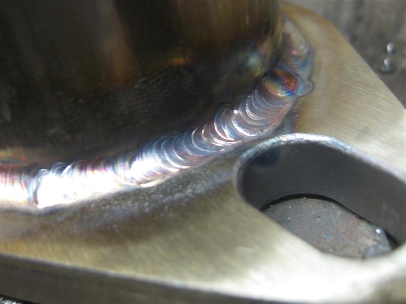

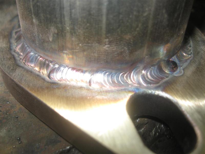

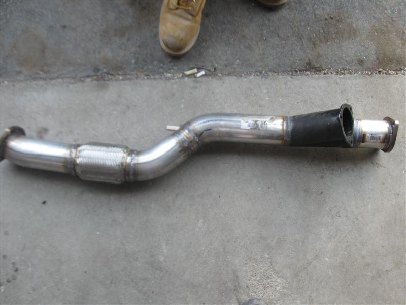

    here are a couple pics of some of the best welds i've done so far...im pretty happy with these to say the least!
    now that the b-pipe is completed, tommrow i will start fabbing up his intercooler piping, out of 2.5" aluminum.

    It looks like that flux works really well. I am gonna have to pick some up to try out for my next stainless projects. Anyone compare the flux to back purging? Is it cheaper to use one verse the other?
    The spacing of your beads/ripples is getting more uniform, I would say: you are well on your way to mastering TIG. Nice work.
    I just did a ton of stainless exhaust tubing for a set of custom headers. The fit up was pretty poor and there was a ton, I mean a TON of welding to be done on them. they were constructed from an assortment of mandrel bent pieces by the fab guy at our shop. Basically he just cut a bunch of pie slices out of the various pieces of tubing to get the general shapes down and brought it to me for welding. With the long pieces I was back purging with pure argon but that is much harder to do with a two or three inch piece because of the heat generated. I went and bought some solar flux and let me tell you that stuff is awesome. It burns black when you weld over but seems to sand out ok.. It is cheaper and easier welding than back purging, but if you are filling big gaps like I was and the flux gets to the topside of the weld it makes it a little difficult to tell where the flux is and where the base metal is. the flux will melt and puddle and accept filler just like the base metal so you have to really make sure to get the heat in there. But IMO overall the flux is better and less problematic than back gassing. I also had to weld the inside of some of the joints which isnt possible when purging. I got a one pound can at local LWS for about 40$. It was totally worth it if you dont already have a spare bottle and regulator or a dual regulator.

    thanks geezer!! im was super happy with the beads on that flange, my only gripe about it is having to start and stop so many times because of my crappy torch control..lol i think once i get my dedicated work area together, it will get a bit easier to work my way around the pipes like that.
    i cant speak to the solar flux VS back purge, since i've never done any purging..but the solor flux seemed to work well, i guess time will be the best test..lol
