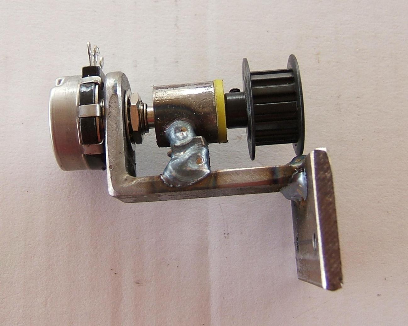

    foot pedal I built for my Tig welder PM256

    That is SOOOO great. You aught to patent it. Especially the use of the toothed belt. I have all those parts laying around.

    If your are going to make one be sure to support the pot shaft.
    I used a pot with a 2" shaft and a bushing made from UHMW plastic and welded up this bracket. The spring tention would be to great on the pot shaft with out a bushing.
    have fun
    tom

    Ain't it neat the things you can do with a welder!!
    I'm trimming down the case of the foot pedal and re-drilling the position of the pivot shaft for the pedal bracket. Next I'll try trimming down the length of the rack so I can trim off the bottom of the case. I think I can loose 1 1/2"- 2" off the overall height.
