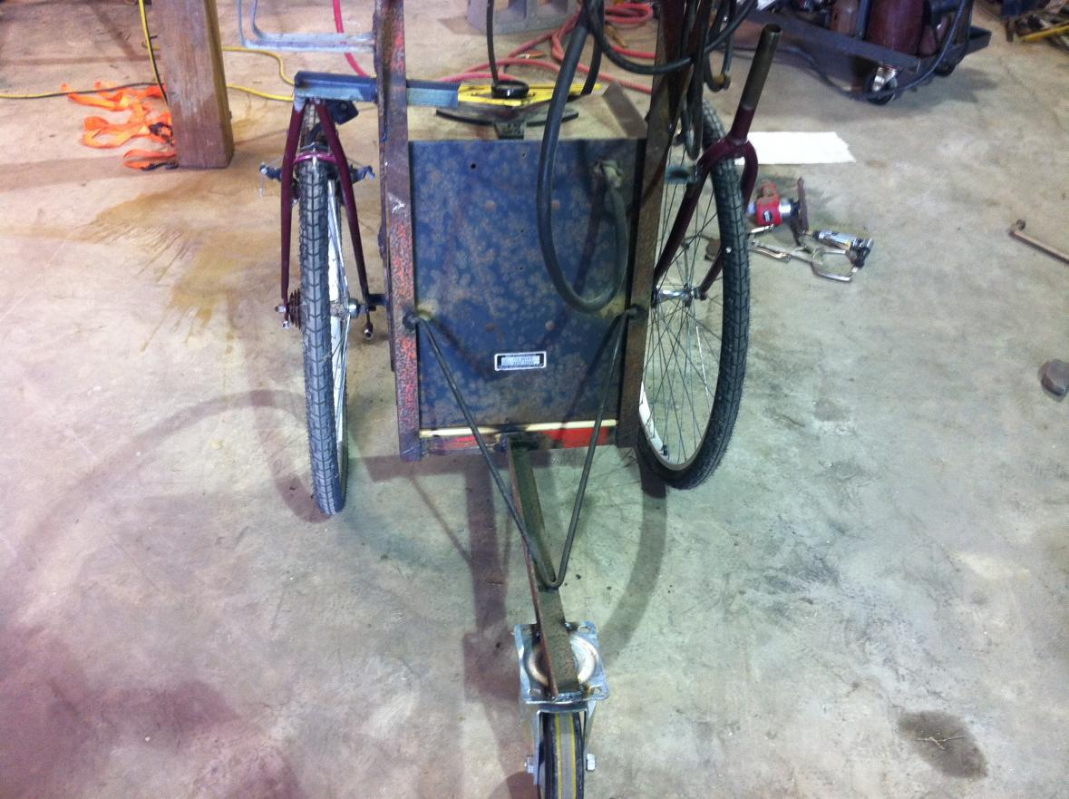

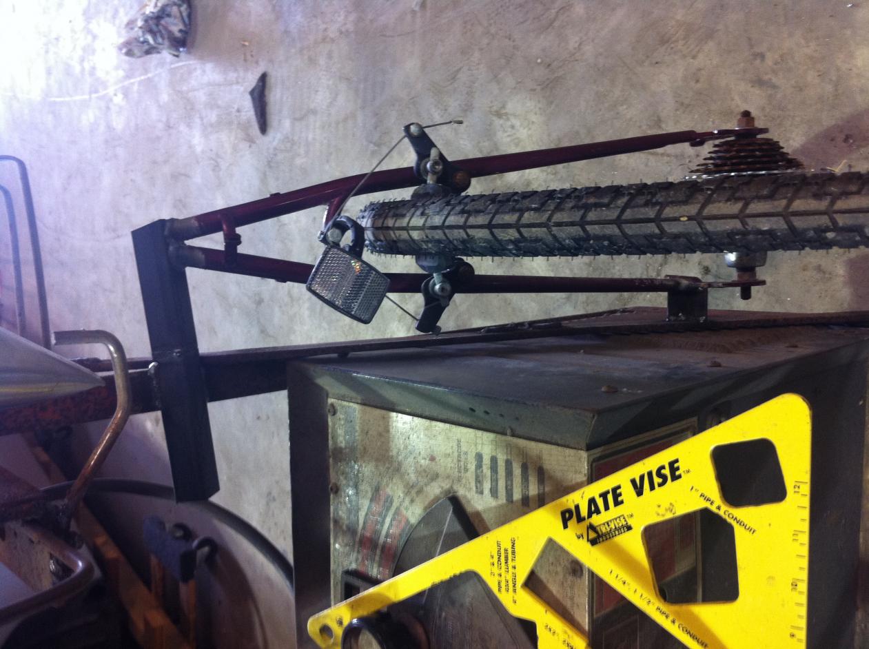

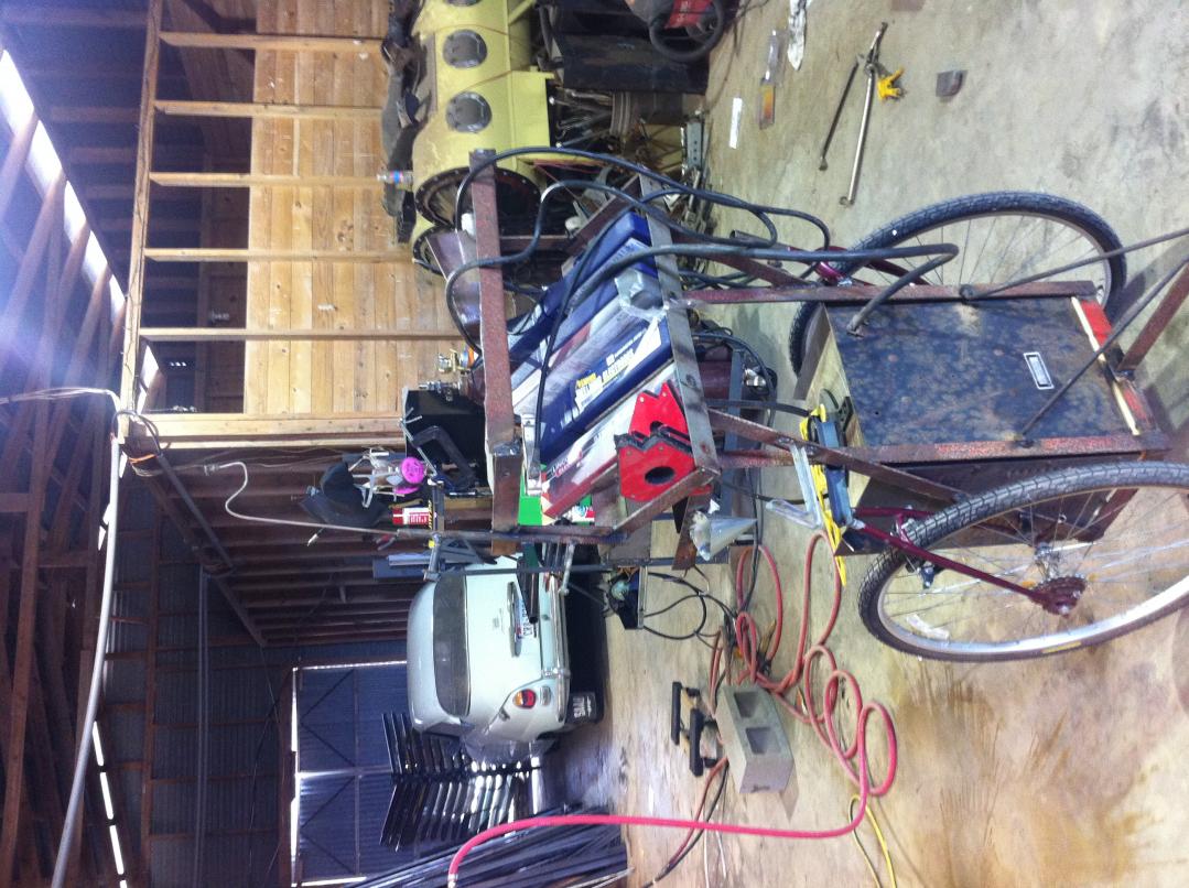

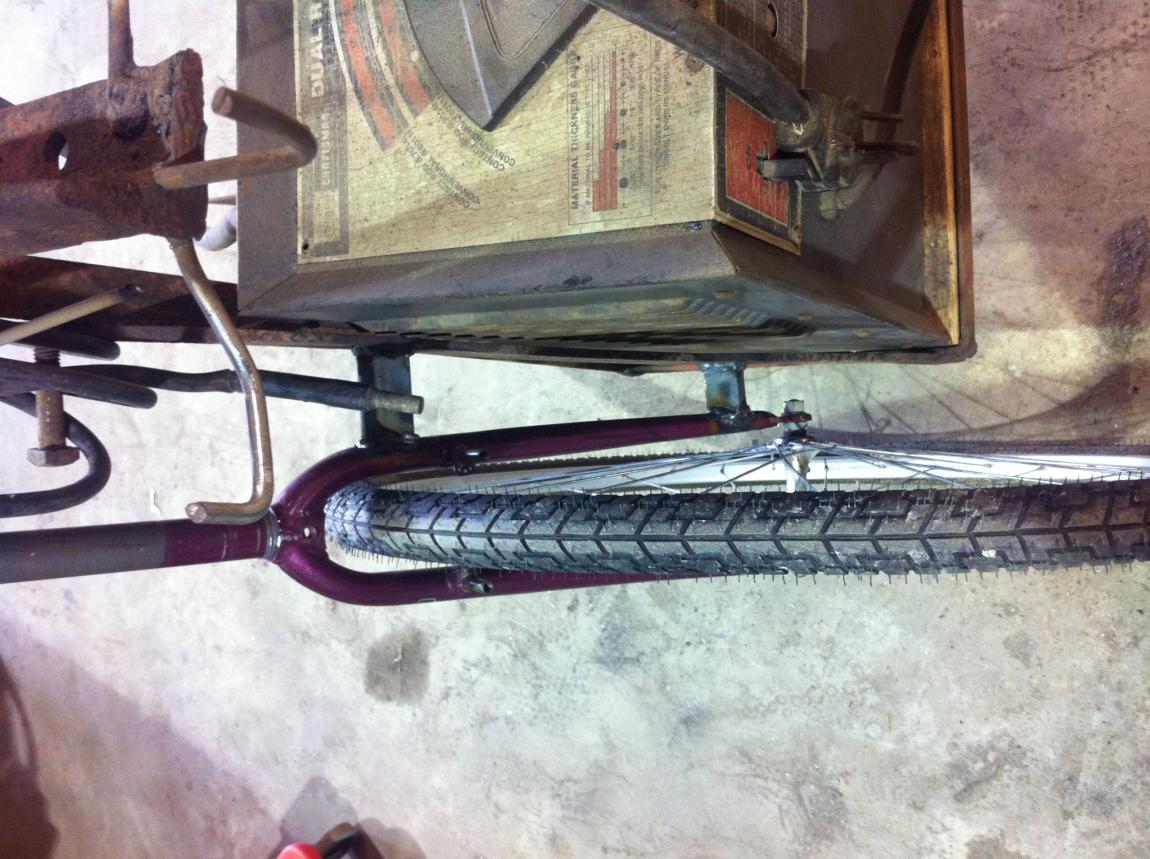

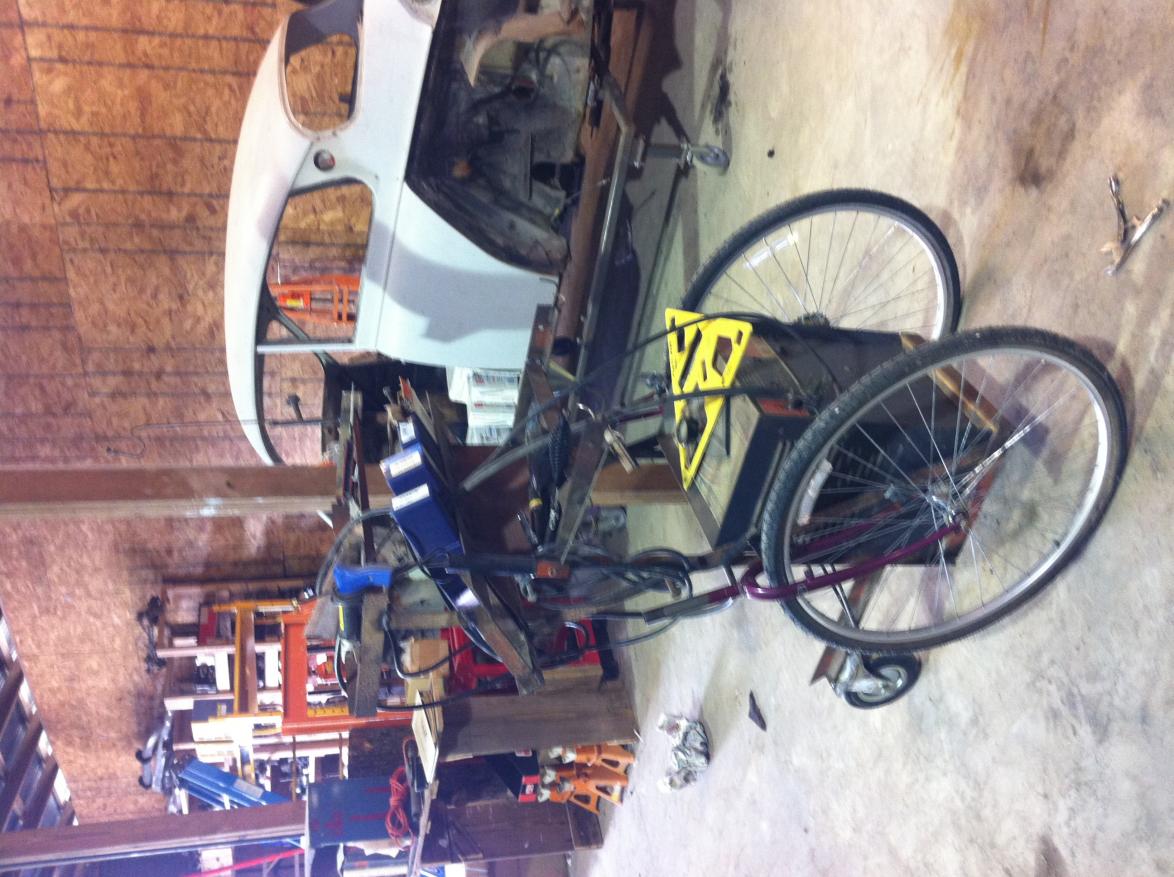

    also, I built this cart for the buzzbox out of an old bike and the framework from an old rusted out grain separator. I put the big wheels on it so it can roll outside up to the other barn in case the engine welder is down and andy (the ranch hand) needs it. rear caster is a HF 8" swivel caster.
    I really like my rod box tray, it's about the best feature on it.

    Nice cart. What kind of casters did you put on that you say don't roll well? Might want to be careful and not get center of gravity to high it be a bitch to hook a wheel and have it tip.
    Must be Harbor Freight castors!!!!! I never weld castors anymore after welding one set!!!! I like the creative bicycle cart!
    Oct 2011
    Litchfield Park, AZ
    370
    I like the big wheels on the new cart. Probably will not have an issue rolling over stray items.
    Miller 252
    PowerTig 250 EXT
    yup. the HF 300lb swivels. I think they're 4 1/2 or 5" . they're fine with nothing on the cart, but with tools, 2 bottles, the welder, and 50' of 8-3 coiled on the back, the casters won't swivel right, so the cart always dog tracks.
    @ 67cuda, the mig cart is pretty stout. it has no tipping tendency. the stick cart, on the other hand, needs that long outrigger 3rd wheel to stay upright. originally, I had it on a HF moving dolly, and it kept trying to tip over, so I had to add that outrigger and another moving dolly before I came up with the bike tires.
    @ DVA yeah, it rolls over pretty much everything. only downside is those tires need new tubes. have to air 'em up every time i need to move it, often as it gets used.
