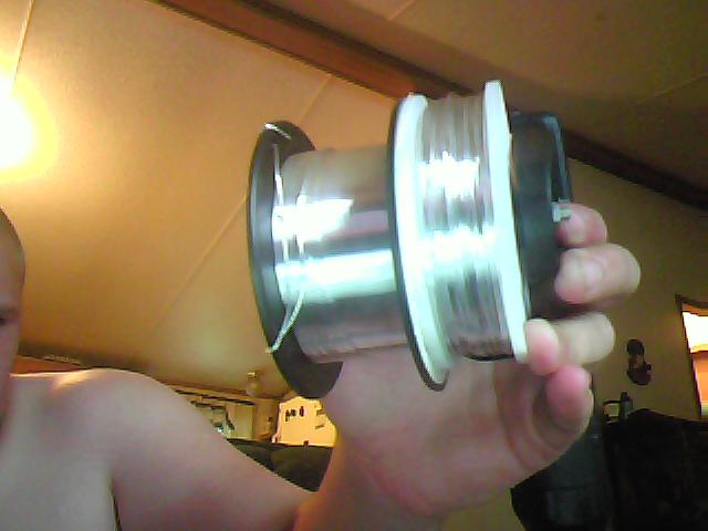

    what is the deel with the spool gun you cannot put a 1 pound spool on it.
    has eneyone had this prolbem.
    Ryan,
    Can you detail the problem or post some pictures so that we may see the issue more clearly? Is it a clearance issue with the outside of the roll or is it the spindle? Please give some more information so we can help.
    What kind of wire are you using?
    Ryan,
    Performance is asking for the same thing I asked for this morning via email. Maybe you have not read the email yet.
    Can you get a picture of the spool, maybe while you are trying to put it in the unit? That would help as I mentioned this is the first I have heard of this.
    Thanks

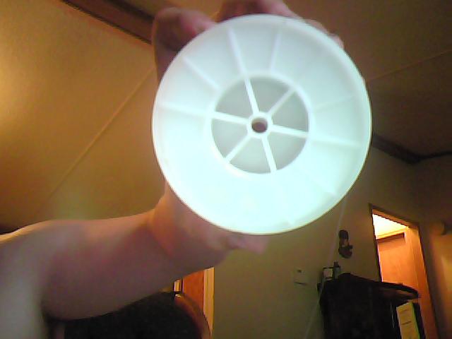

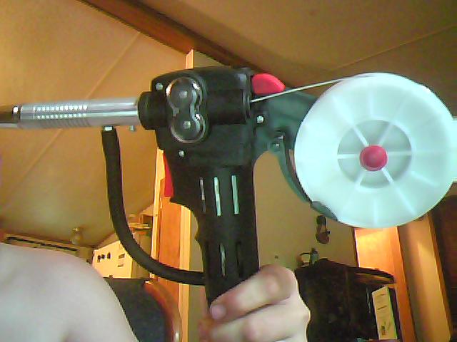

    it is the drum. the spool that came with has a 6 mm hole in it and it is
    1 3/16 wide. an off the shelf spool has a 5/8 hole and it is 1 7/8 wide.
    I think I can get the spool/drum off a miller one and put it on but that will cost me $100.
    i will try to get some pics.
    hear are some pics

    Ryan,
    We're going to look into the spool gun you have. I talked with Performance (one of the other support team members). He or I will get more information from the main office Monday when they are open.
    We both thought you had a different unit. Sorry for the delay but we will get back to you.
    And thanks for the pictures, they were a big help.

    After some checking, I think you may have a Euro model that could have been accidentally shipped to us then to you...I have forwarded your issue to Alex. He will email you. But I am following up with the welding wire manufacturers first to make sure. The size of the roll is standard that you have for small regular migs. However, I know I have seen other size rolls similar to the one you have. Also, when I have used a spool gun, I have never taken the time to measure it before. I did measure the Hobart wire yesterday. It measured 1 3/4 wide. I will try to figure the rest out for you before you have any more time lost by tomorrow.
    the spool that came with the gun did not have aney wire on it i raped wire from one spool to the other. the 1 7/8 or 1 3/4 i think is the same.
    adn i have never seen a spool like the one that came with it.
    the welder it self will take the small spool and an 8 in. spool as well.
    thank you
    ryan

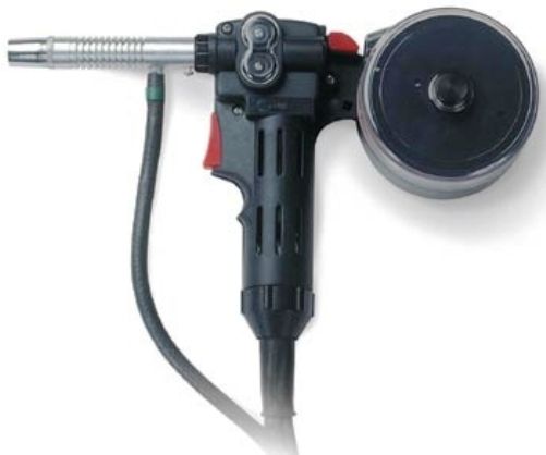

    hear is a pic of the spool gun from the U.S. market the one everlast sent is not made for the U.S. market.
    and i have used the miller 3035 spoolmatic for 2 years at work and i am
    knowledgeable on how to use it.
