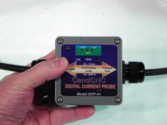

    This is from CandCNC.com - I read where he suggested using this to get the voltage for the ARC OK instead of going through the plasma cutter.
    DIGITAL CURRENT PROBE DCP-01
    Now you can see the actual DC Amps AT THE CUT using our exclusive DCP Add-on module for the DTHC. It is accurate within better than 2% across a range of 20 to 125A (higher range version available on request). Displayed in real time on the same screen as the TORCH VOLTS, it gives you precise information about your plasma cut. No longer do you have to guess at what the true cut current is. Use the Cut Profile to preset fault points so you can prevent bad cuts due to improper dial settings or poor workclamp connections. The DCP also acts as an adjustable ARC OK sensor and it works with any plasma cutter. Each Cut Profile can have it's own ACR OK trip value in AMPS. NOTE You need to order this option if your Plasma cuttier DOES NOT HAVE AN ARC OK (aka Transfer, Arc Xfr, OK to Move) signal.Plugs directly into the new THCSensor-PWM Module
    We do supply the arc OK at the CNC port.
    So this is not necessary if your unit has a CNC port.

    The digital current probe can supply you with the Arc OK signal. It reads the voltage at the work piece. It's a simple incompatibility issue that is causing you some problems. You do not need a different voltage divider with the DCP-01. From my understanding THC reads the voltage in two places. If you use something different to read the voltage it should give you the proper signal to make the height adjustments. That is why burntables is wanting you to install their voltage divider card inside your plasma cutter. If you use something that works externally from your plasma cutter to read the voltage and supply the arc ok signal you will not void your warranty.

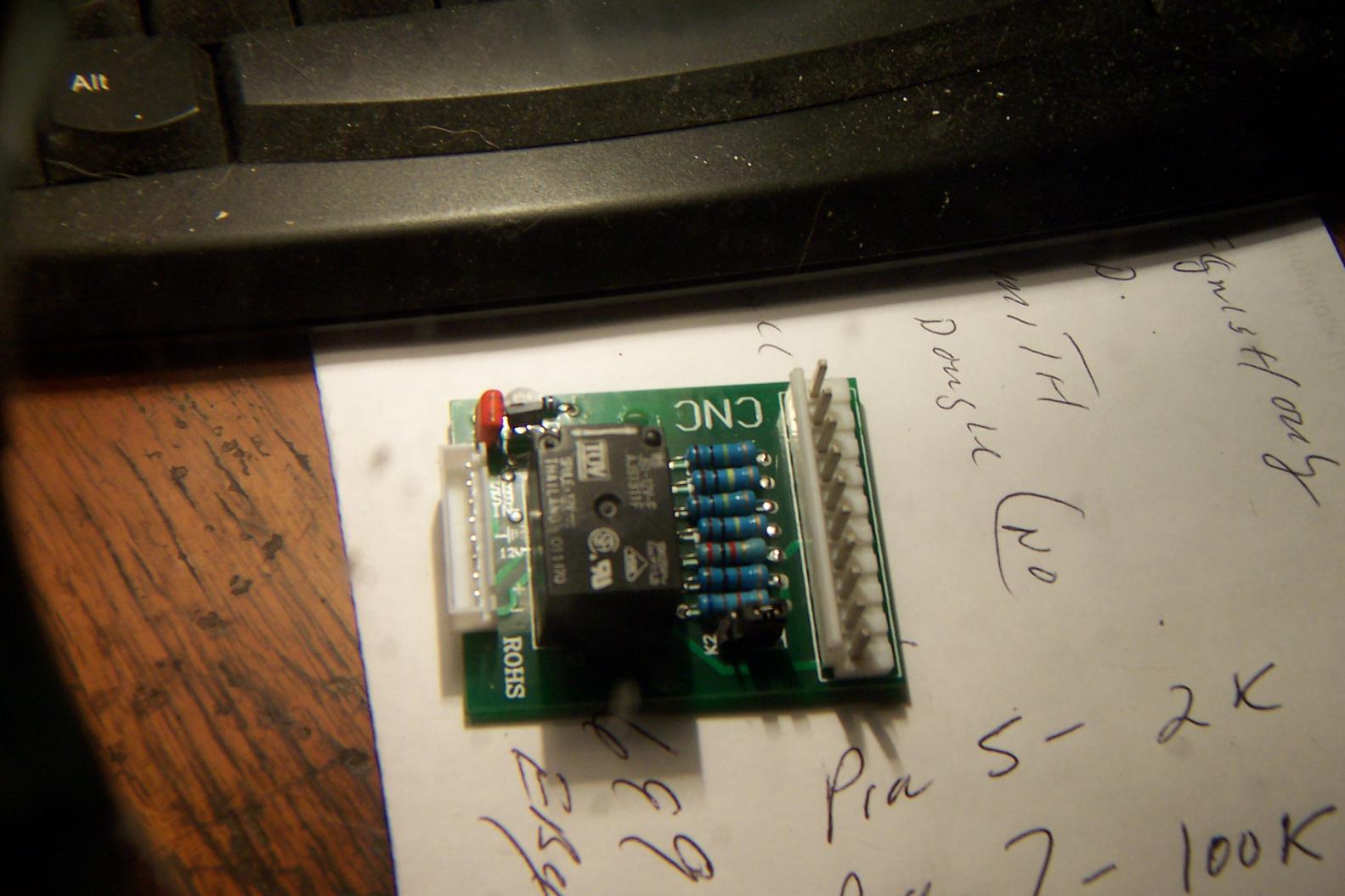

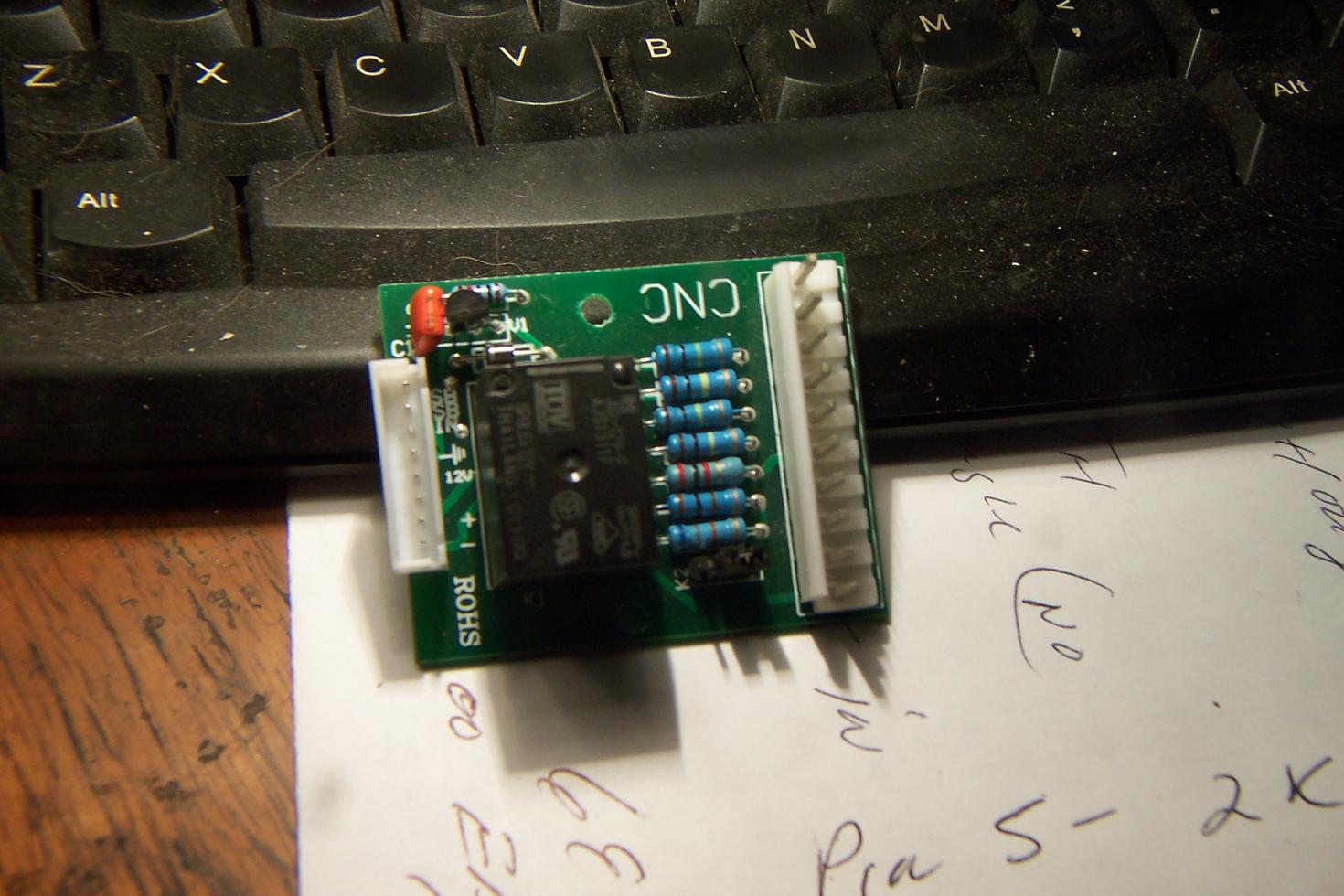

ID:	6647I pulled my divider card and ran the resister color code , pin 5 is a 2 k resister not a 100 k and pin 7 is 100k resister so that pic of card is wrong . pin 5 resister is bands red -black -red - gold that 2k bet if you replaced the 2k with a 100k would solve your problem

    Attachment 6648found out this diagram is wrong pulled my cnc arc divider card out of my everlast plasma cutter pin 5 is 2k instead of 100k but pin 7 is 100k its rite
  18. #58
    If the two were reversed that would make his machine close to what the burntable people want in the first place. And the idea on the jumper would be shot in the foot as well if not 100K on both.
    Rod, as I do not have this board and you do (well I have it, but I am not ripping my machine out of the rack and talking it apart). Maybe Ray can look or Oleg can mail me one. Rod can you ID the two resistors.
    Better idea might be short them both out jumper clips (no mods to the machine that he is worried about) and add a 100K external to the control board line as needed?
    Can you ID the resistor for 5 and 7.

ID:	6650pin 5 is a 2 k resister not a 100 k and pin 7 is 100k resister so that pic of card is wrong . pin 5 resister is bands red -black -red - gold that 2k bet if you replaced the 2k with a 100k would solve your problem on pin 5
  20. #60
    never jumper a resister can short stuff out adding more resisters ok but removing can fry components in a circuit board since like the relay on board is tied into some of the resisters . i think if he takes the 2k and replaces it with a 100k would fix his problem
