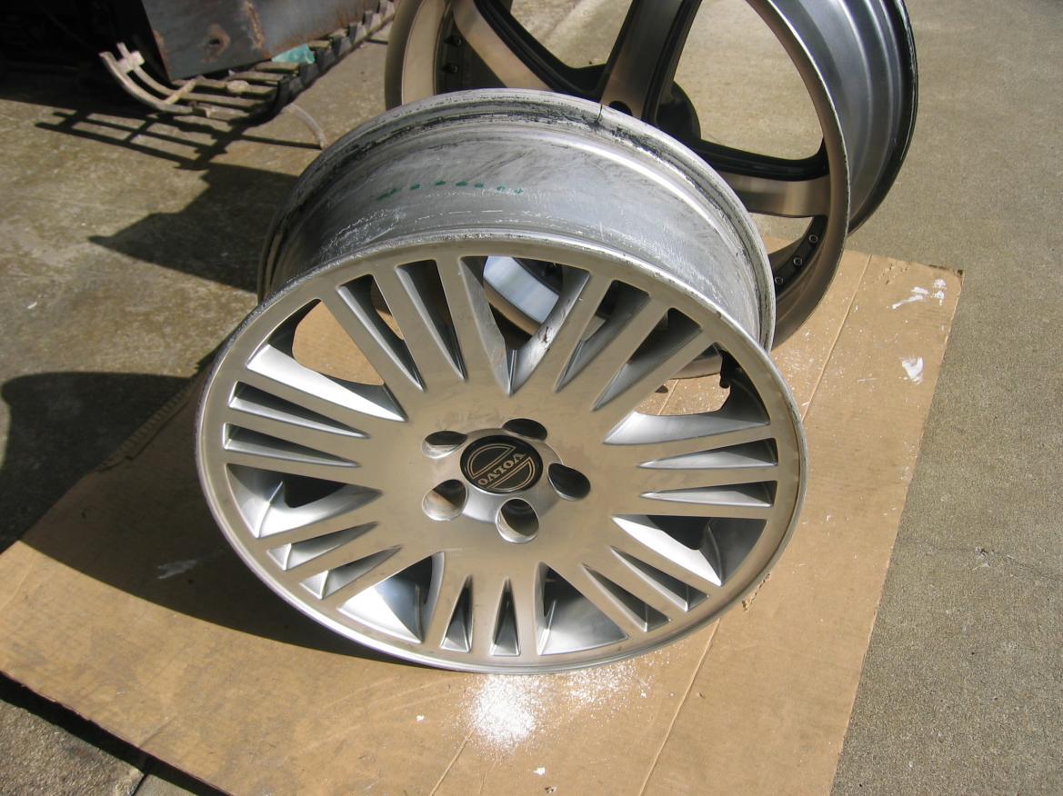

    I welded a batch of two cracked cast aluminum wheels. The first one was a Volvo OEM wheel. I was actually quite impressed by its light weight!

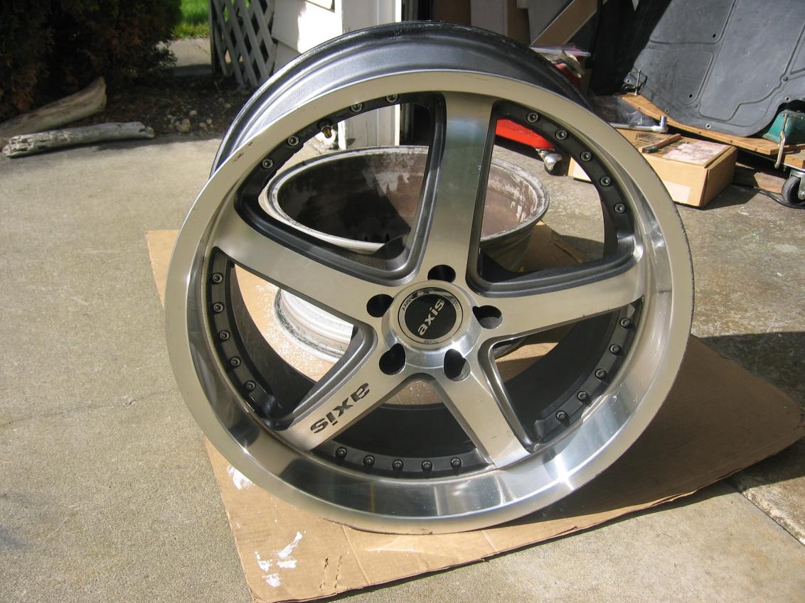

    The second one was an Axxis aftermarket wheel.
    The volvo wheel had a "y shaped" crack.

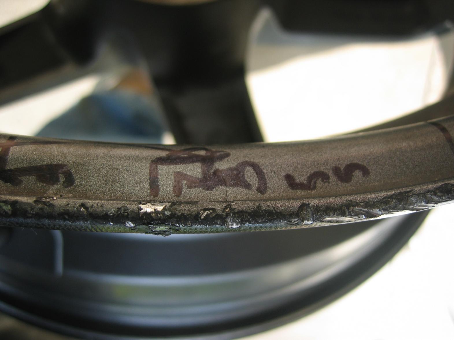

    The Axxis had a straight crack.

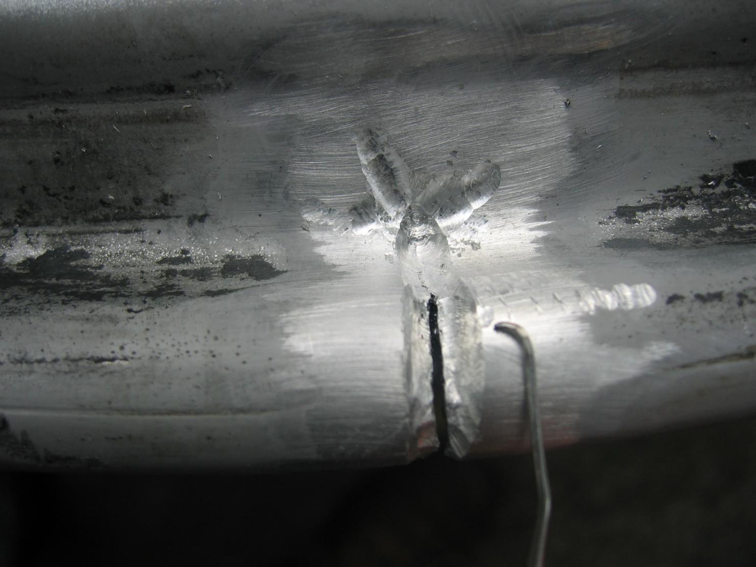

    The process for preparation is the same... remove all paint from the surface around the crack, and vee out the crack with a carbide burr.

    I used a dental scaler to scrape a bunch of crap out of a crack that relatively wide:

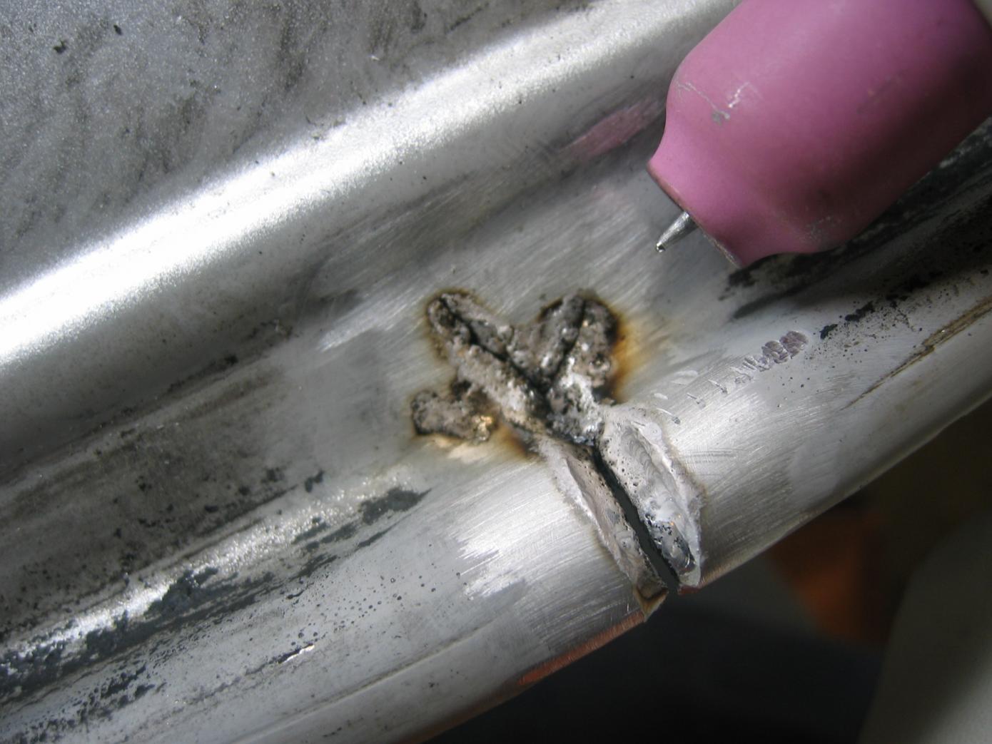

    Before I weld them, I like to do some more cleaning (or rather to "test the cleaning") by running a low-amp arc over the area to be welded until the area is completely etched and is arcing without producing lots of smut (black or other colored, soot like powder) where the metal needs to flow. This is actually one of the more dirty wheels, but this shows how it looked before I began to final, high-power welding.

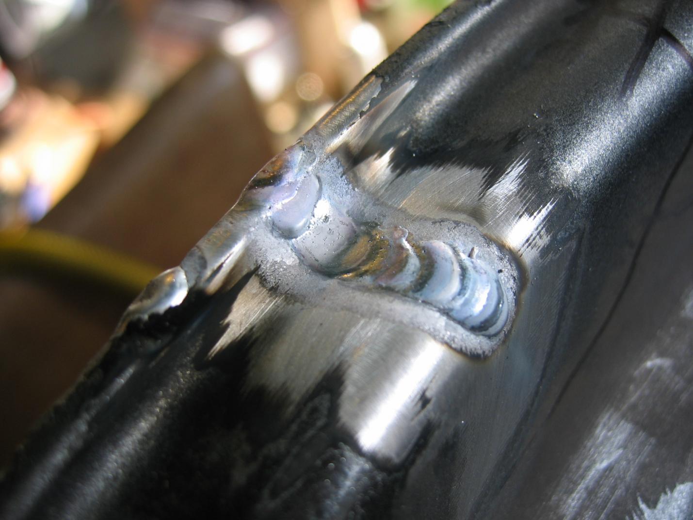

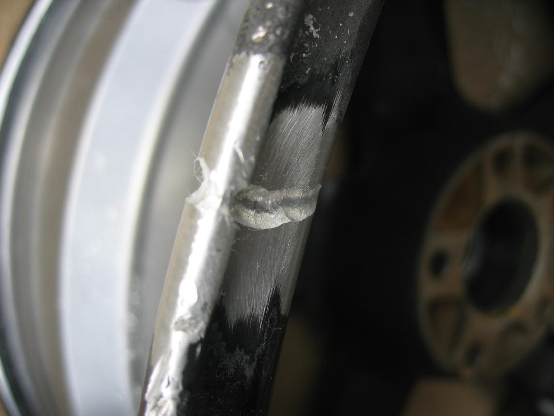

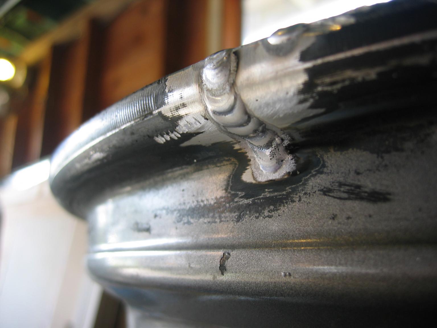

    Then I weld them from both sides.
    Volvo:
ID:	2480 Click image for larger version.
    Axxis:
ID:	2482 Click image for larger version.
    The local wheel repair company (my customer) take the welded wheels from here, mounts them in their runout-measuring jig and straightens as needed by hand, grinds the welds down smooth, and refinishes the wheels.
    I much prefer working on painted wheels like these than I do on chrome plated ones. My favorite wheels to work on however are the ones that are bare aluminum. Those are usually forged / spun-formed. Both of the wheels pictured here are cast.
    I usually go for about 45 minutes a piece per wheel, with about 1/2 of that time being in preparation, and the other 1/2 time being in welding. In this case I think I was a little faster.
    I do wish I veed out the dirty crack (rather than dental scraped) because there was still a lot of junk in there when I started welding.
    I used 3/32" 5356 filler, (as well as perhaps a smattering of 1/16" 5356). The 5356 seems to leave a strong, ductile deposit on wheels.
    After using a couple of very high amp welding machines last week (350 amp+) my 200 amp was feeling a little "limited", for the first time that I have ever noticed. Even with full amps and min AC balance cleaning setting. I wonder if the feeling will go away as I get used to it again. Oh well, I do still really like my machine. Nothing else like it I can throw in the back seat of my car, and take to whatever shop is needed on moment's notice.
    My objectives for the most successful wheel weld are:
    1. Fully penetrate, for strength
    2. Put down a solid deposit with no (or minimum possible) porosity, for strength
    3. Make the weld bead as narrow as possible (to ease the straightening and finishing process)
    4. Leave no (or only very slight if any) undercut at edges of the weld bead, for strength and lack of a stress riser
