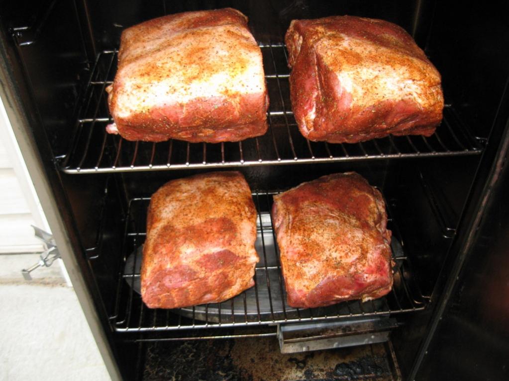

    Nice, I'm going to use a water pan to help even out the heat, and it's a little more forgiving using a water pan.

    I have a friend that swears by dry sand in a pan to even out the heat instead of water. I still use water though.

    I finally got my smoker finished, all I have left is to bolt on the tail lights. I learned a lesson, I will test fire before I paint if I ever build another smoker. I had two spots that leaked because I ground off to much metal. I have to paint the left side again. It came out pretty good, and I was very happy with the cook. It hold heat very well, I had to choke it down to get the temps down low.

    Steaks are for a "grill". This is a smoker. It is made for "Real" pieces of meat. Say 5 lb chunks and up. Usually 50 lbs at a time at least.

    You are correct sir.
    Very nice job on that smoker Sean.
    How much did you end up with in metal cost.
    I have been smokoing for a while now but with an electric model.
    Someday I would like to build a nice wood fired one like that.
