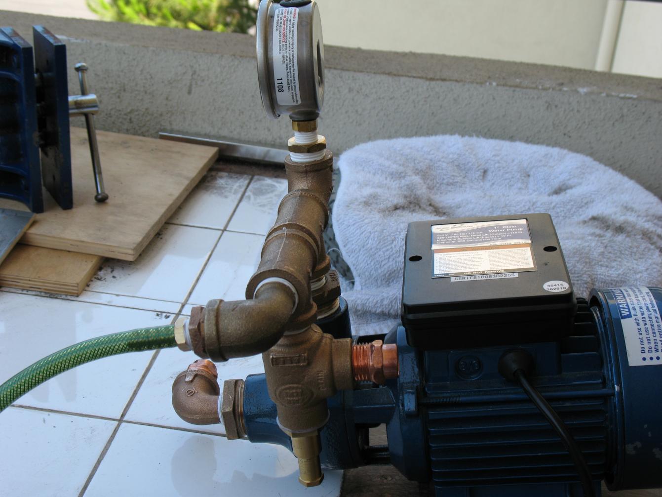

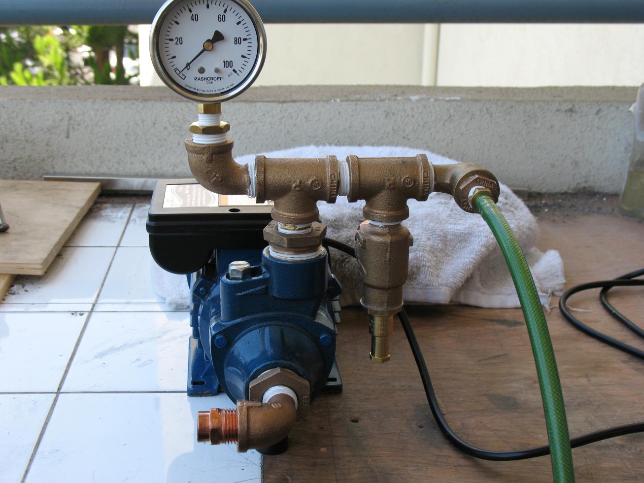

    ok sorry for the lack of updates, ok pretty simple but I decided to change from pvc to all brass/copper because at some point I am going to take this apart and mount it into a cabinet and the pressure indicator will have to come forward to be flush with a similar diameter hole in the front of the cabinet and the quick disconnects will be panel mounted also.
    ok now what you see is I have reduced the inlet and outlet right at the pump with 1" to 1/2" npt hex reducers. I tee'd off the outlet to the psi gauge and then another tee to the pressure bypass hanging down and then to a 90deg st elbow to my output to torch which will be getting a quick disconnect end on it soon ( green line ). On the input you see the reducer into a 90 street elbow with a copper pipe adapter ( not screwed in fully at this point ) I will be going with copper to the tank with unions ( intake from tank and bypass back to tank )
    side picture you see same copper 1/2 to slip, I will send that back to the tank ( excess pressure). the small hex shaped knob hanging downward from the regulator will allow me to adjust how much pressure actually goes to the torch from 25 psi to the recommended 50 psi max I think around 40 psi should be fine . Returning heated water will go into a trans cooler with a fan pushing air through it and then dump into the tank.
    should be another week or so before I have it up and working, Using my weldtec air torch for now, but the warm cable on the back of my neck is irritating cant wait to get to using my wp20
    Total investment at this point $150 counting the used trans cooler you dont see and the 2 1/2 npt alum weld on bungs. I already had the .120 aluminum sheet on hand for the tank but could have just as easily used a cheap poly tank of some kind. only other cost will be the 2.5" weld on filler inlet with cap ( $16 ) Total cost will then be $165. I could have done it for under $100 but it would have looked like an 8th grade science experiment LOL. I wanted it to look decent

    Well here is where I am at now. got it all hooked up minus the actual torch return to the trans cooler then to tank. The trans cooler is at my parents house ready to be plugged in via hose barbs. I cant afford the 2 quick connect fittings @ $25 a set right now so barbs will have to do for now. with the 3 gallon water bottle as a tank I think I may have the pump hanging over the front of the bottom shelf of my cart by 3 inches... no big deal for now.
    Soon as I finish my welding table I will build the proper tank for the unit... But for now it works sweet.. watch the video
    dejavoodoo: just a side note with my 1/2 reducers on the intake and output of the pump and my bypass valve on there the max psi I can put to the torch is 50 psi, and all the way down to 15ish.
