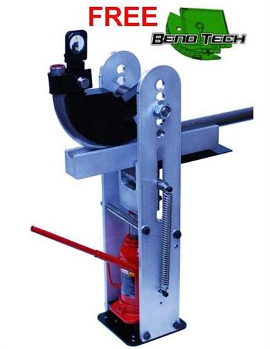

    I have the protools bender if want pics and measurementClick image for larger version.
ID:	6862 would be very easy to build . This is the company that makes it http://midamericanonline.com/tubing_benders.html protools just sells it . i got mine from the company that makes in Iowa

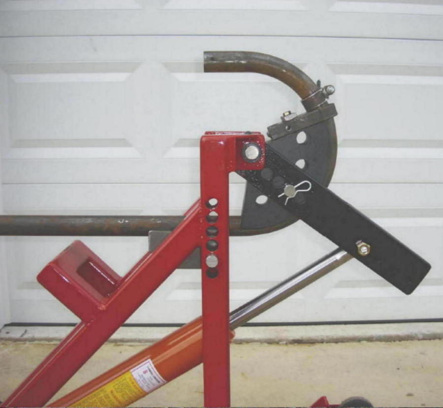

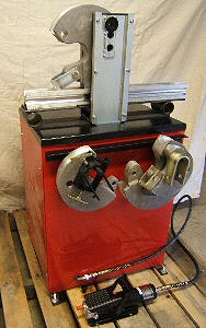

    I like the gottrikes better mine only dose 90 bends max . i had the 180 bender at one time but sold it wish i kept it .lol the bender is cheap to build ..its the bending dies that kill you. sorta like this one it uses 120 degree dies Click image for larger version.
ID:	6863 the problem with my bender the upper part is in the way when trying to go past 90 degrees

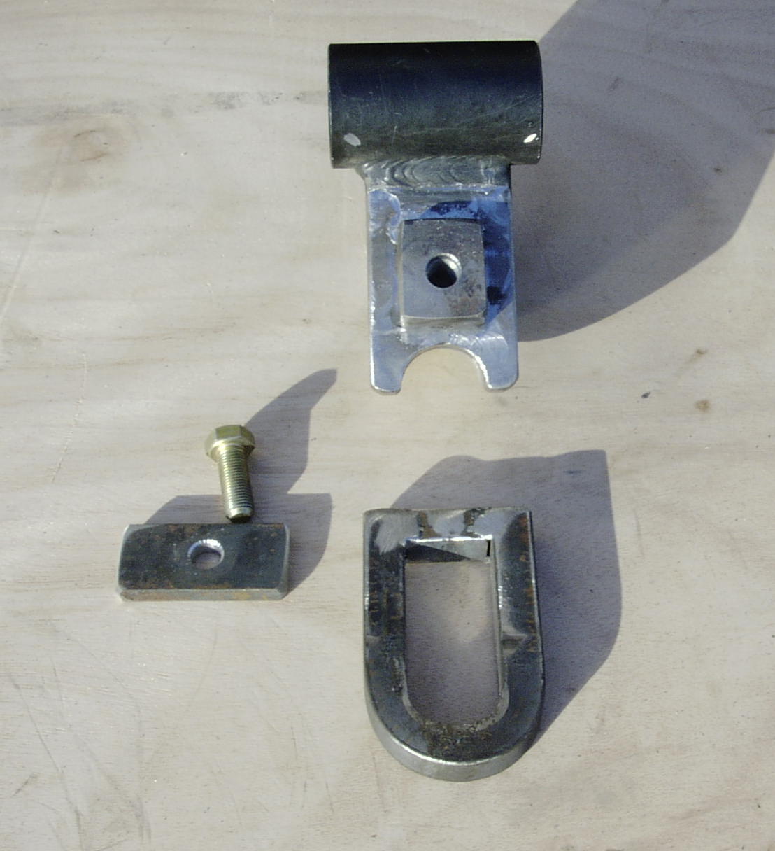

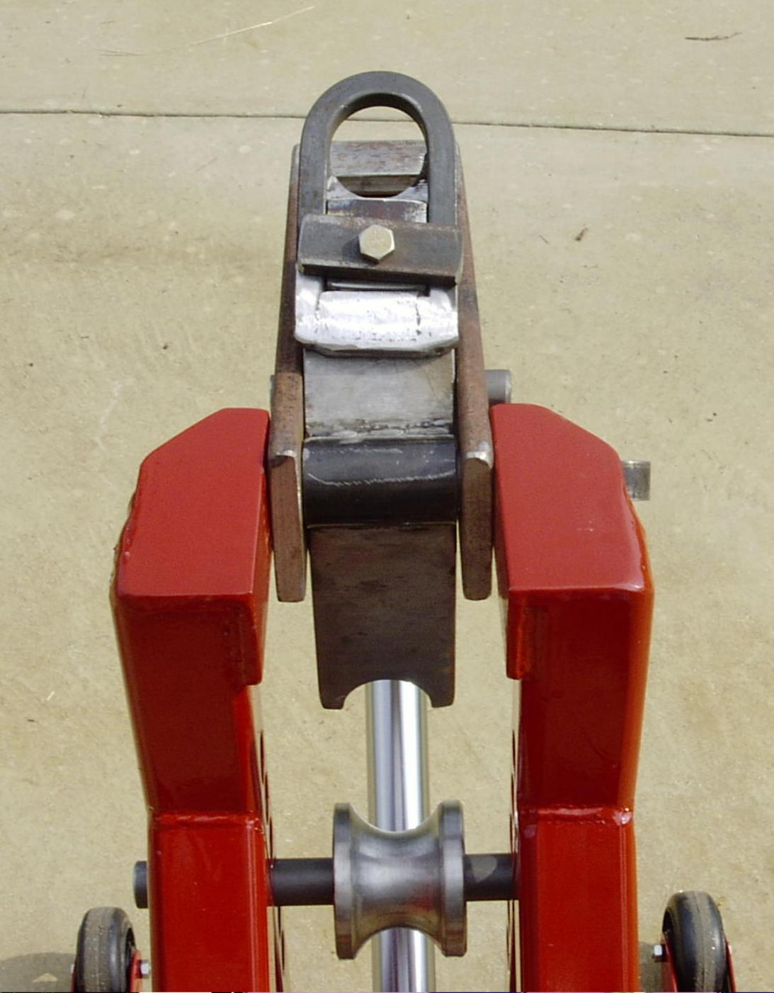

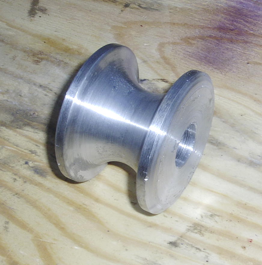

    Here are a few mods I did when I built my Gettrikes Bender.
    First I use a roller under the tubing it worked much better then the slide block and no grease needed. Next is a clamp that I put on the tubing so I can bend beyond the degrees of the die. I did not like the Pro-tools clamping mechanism so I ordered my dies with out them and made my own type (see Pictures).
    The Gottrikes bender is just a better design and its portability is a big plus.
    Have fun
    Tom

    What degree die are you using? I like the roller instead of the sliding block.
  10. #30
Name:	engine rebuild and installs 006.jpg
ID:	6888mine works sorta like that the block rides on 2 rollers so it slides through with the pipe had the z bend 180 it was a neat machine but sold it Click image for larger version.
ID:	6890 it is very simple design. the hydrolic ram sat underneath
