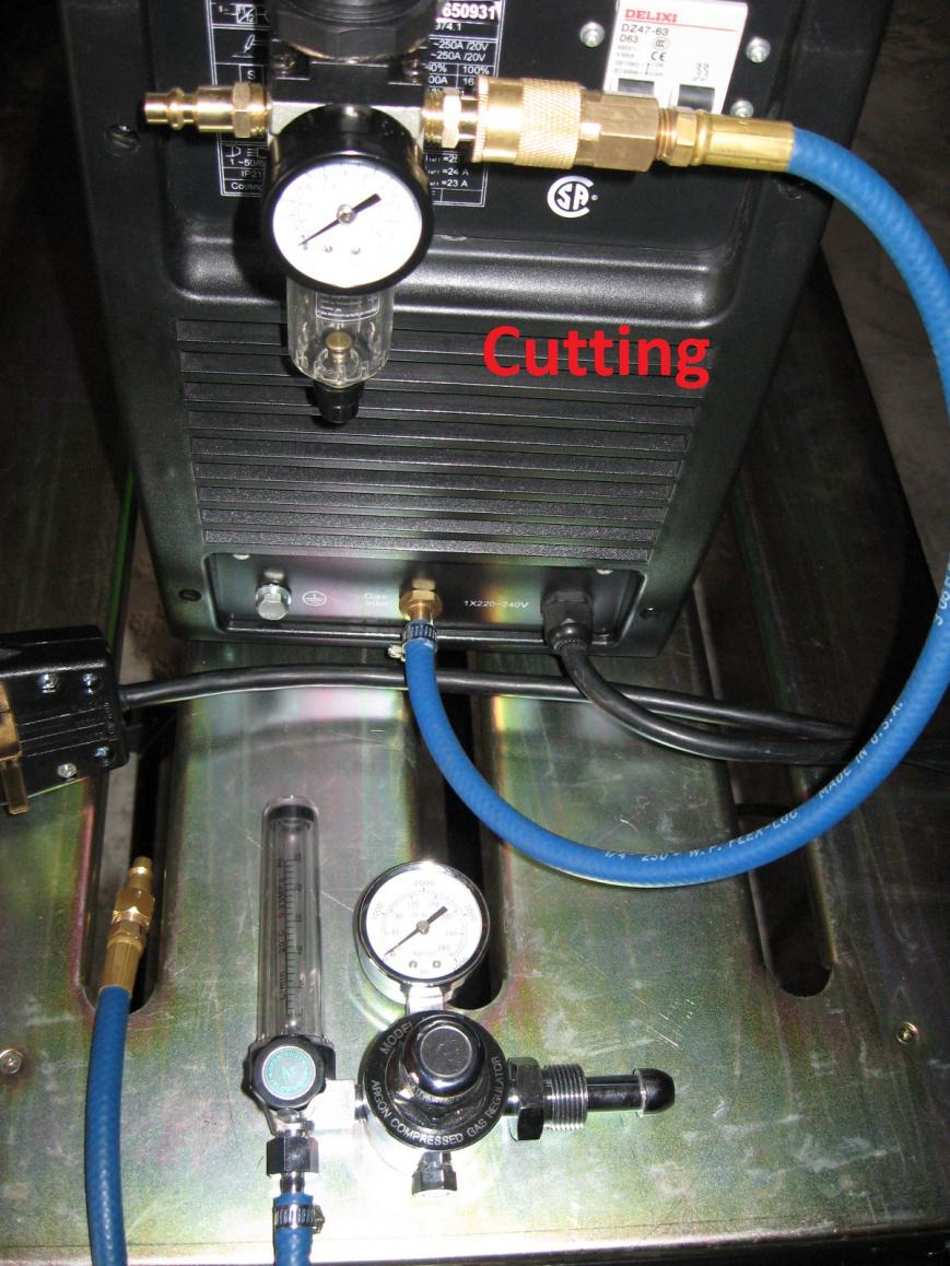

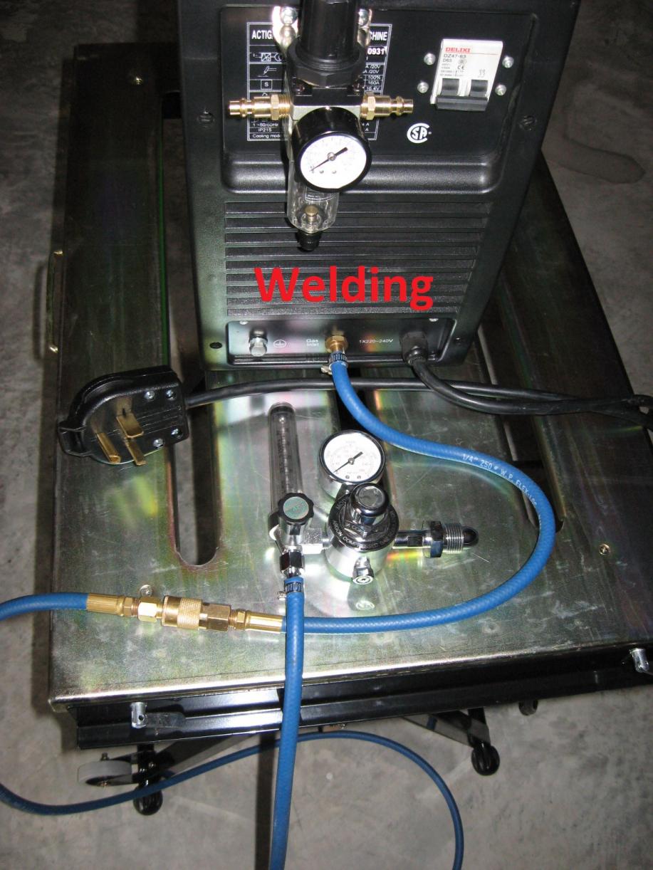

    What do you think of this hose setup for the PP256... there are no leaks and changing process only takes a few seconds.

    I'm not a sensitive person so make no effort to spare my feelings if you don't like the hose setup.
  8. #28
    As I have told others, that's not what I consider ideal.
    The problem is that the coupling and uncoupling of the lines leads to condensation in the mouths of the fittings, introducing moisture to the system. A static situation where valves are used is the best.
    It does not solve the changing out torch issue.
  9. #29
    I see where it could get a little condensation under some circumstances but so far I haven't noticed anything. I'm never in a hurry since welding is just a hobby for me, but if I were in a hurry I believe I could change torches and hoses in about 40 seconds.
    Thanks for the opinion. I like to hear what others think, good bad or indifferent especially from professionals.

    The way you have the argon flowing through the water trap it is possible to pick up moisture in that bowl. I've heard of other guys making a manifold with ball valves which will work fine. The way I have my 256 set up is the cats ### IMHO. I bought a Miniature Diverting 3-Port PVC Ball Valve from McMaster-Carr. Part number 4757K57 for the valve with 1/4" barbed fittings and part number 4757K58 for the valve with 3/8" barbed fittings. Get the size that matches your welders hose size. I'll take a picture of mine tomorrow and post. It literally takes as long as a torch change to go from welding to cutting WITH ZERO MOISTURE! I may make a video displaying how fast one can from one mode to the next with this setup.

    The ball valve method is much better choice. And never run the Argon through the trap. Also the 1/4 NTP connectors can corrode and even leak if tweaked a little (they wear over time), so I would avoid them.
    Also always turn off the tank when done. One leak can be $40-$80 the next day.
    Alan
    Look at those pics again guys... no argon goes through the air regulator. The argon hose plugs straight into the welder. I get no moisture whatsoever, have no leaks and it works perfectly.
    For me this setup was the simplest and made the most sense. I maintain my air fittings just like the rest of my equipment.
    My mistake, I thought the argon was flowing through the trap for some reason. That looks like a good setup. Moisture would be almost non existent as only whats trapped in the small piece of hose would be an issue, and that sure would be very very minimal. As long as it does the job for you is all that counts.
