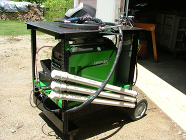

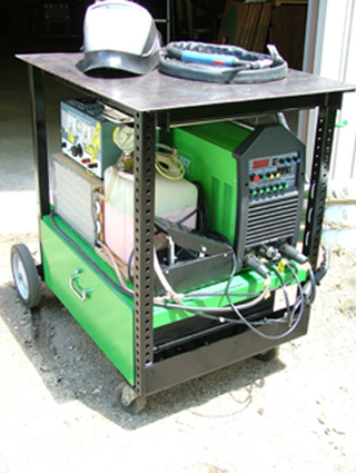

    I have a PP256 and it is the perfect machine for me. I don't ever intend to do production fabrication, but wanted a capable welder for the tig process that I've learned over the years. It welds beautifully and cuts like a champ. I also have limited space, so having one machine to do both is a plus. There is also the price -- just can't beat it! It is also a great stick welder, way way above my old AC225 Tombstone.
    Regarding my limited space, that is why I designed my welding table/cart like I did. Just get it out when I need to. Otherwise it's parked out of the way. The drawer stores cables, stick rod, gloves,etc., all in one place.

    I like your cart / table.
    James Swanson

    James, Here are more pics.
