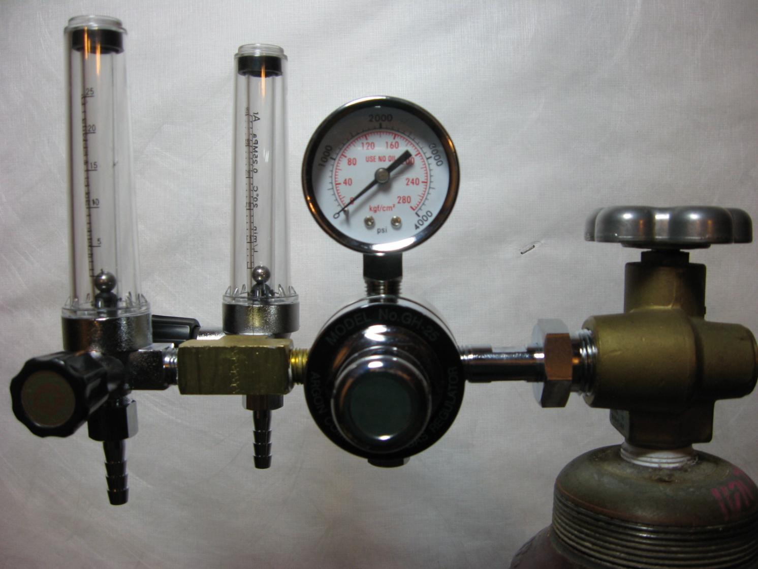

    Thanks for your input performance! What do you mean by "stand off?" Is there a fast-stable way to have your pipe setup when back-purge welding stainless steel pipe? (Do you rest your forearms on the table? How is your ground clamp implemented?) Lastly, are there any cups better than the Everlast #7 ones you recommend for this SS pipe tig welding?
    Here is my "from da hood" back-purging setup that I measured with the flow meter to make sure flow was accurate:

    Stand off in this case is arc length. Try to keep it at 1/8". I'd try more amps and travel faster advancing 1/8" each time at a constant speed to get the row of dimes look. If your tubing is 304 stainless you need 1/16" 308L filler.
    I used parts from 2 everlast regulators to make a dual flow setup. Click image for larger version.

    If this T is after your flow meter, you are stealing torch gas for the backflow.
    Stainless is easy to overheat.
    Yes, you need to be well braced, I keep all kinds of odd sized blocks for hand rests. It is almost impossible to stand free hand and get a good looking weld.
    Todd

    yes, the T-fitting is after the single-flow regulator. I set it up so that the backpurge valve is pulling a constant ~2L/min argon flow and when I hit the Pedal, the tig torch makes the flow meter go up to ~8-10L/min. So, my understanding is that phenomenon means that flow is going to the torch, but maybe I should raise the flow?
    Also, how do you guys mount your grounding clamp to the pipe when backpurging stainless steel pipe like this? I used aluminum tape on both ends, with a slit on the outlet end and small hole for the argon tube on the inlet. But, where do you put the grounding clamp so that it's secure during this process?

    Just ground your welding table...your work will ground through it.

    How are you setting flows? Are you setting the flow at 10L/M with the torch and then throttling the 1/4 turn valve to 2L/M with the torch off? Floating ball regulator?
    My table is always grounded, but I keep a 2nd cable with 2 clamps for tubing or any low amperage work. One end clamps to the welders ground clamp and the other to the tubing. This stops any arcing between the the table and tube when rolling the tube during the weld.
    You can practice without backpurge and then figure out your backflows, if you keep the heat low the back purge is not nearly as important.
