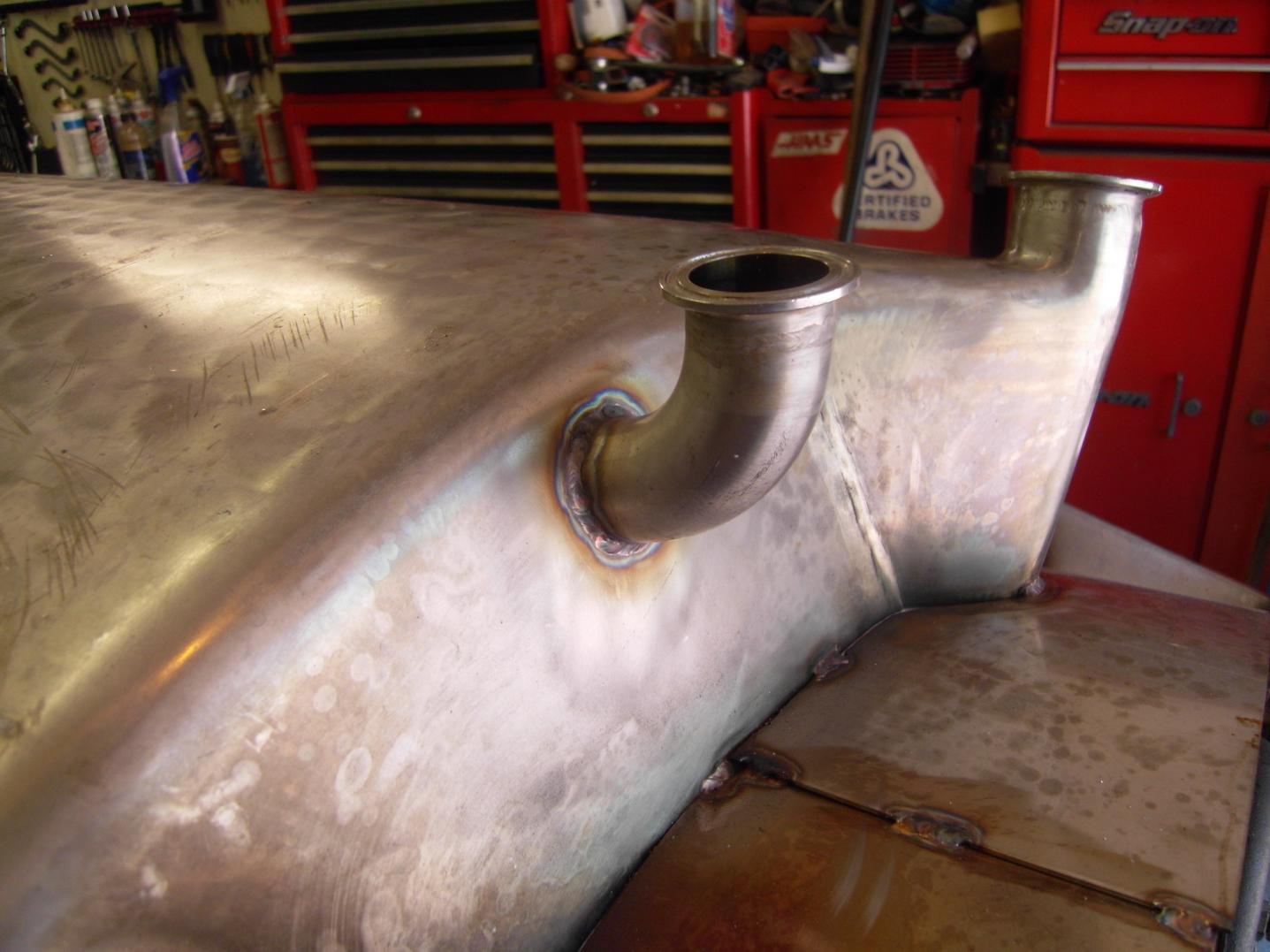

    I've got a whole extra pound of the stuff because I forgot I already had some, and then I bought some more.
    But anyhow, yes I've used it, I actually oxy-acetylene welded a couple complete automotive stainless exhaust systems with it. (Attached pic shows an oxy-acetylene welded stainless turbo downpipe I welded using solar flux "B".)
    It works great but the only downside is it is hard to remove the melted flux residue. I've left the residue inside exhaust systems without problem, but don't know about upstream of a turbine impeller. I actually wouldn't guess it would do any more harm to a turbine wheel than a small amount of media blasting, which is used to clean carbon deposits off of impellers during turbo rebuilding.
    Another downside to the flux is you can't expect it to hold up on an additional welding pass. If its on the inside of a pipe and becomes inaccessible after an initial welding pass, it is possible that some will pop off after the initial weld pass cooling cycle, leaving unprotected, bare metal. So, if using it I would recommend getting all your welding done in one pass with it.
    To dislodge the fused (black, or dark molasses colored) residue off a welded surface will take something much more aggressive than simply jarring or "smacking" the object. However the flux that did not get up to melting temperature (and is still in gray powder form) can be *very* easily wiped, or washed off.
    I remember using a large, heavy duty (15 amp) milwaukee angle grinder with stainless cup brush to remove the residue off the outside of the exhaust systems I welded with the Solar Flux. And I remember I had to press down pretty hard to remove the solar flux residue, along with the stainless oxide surface off the pipe.

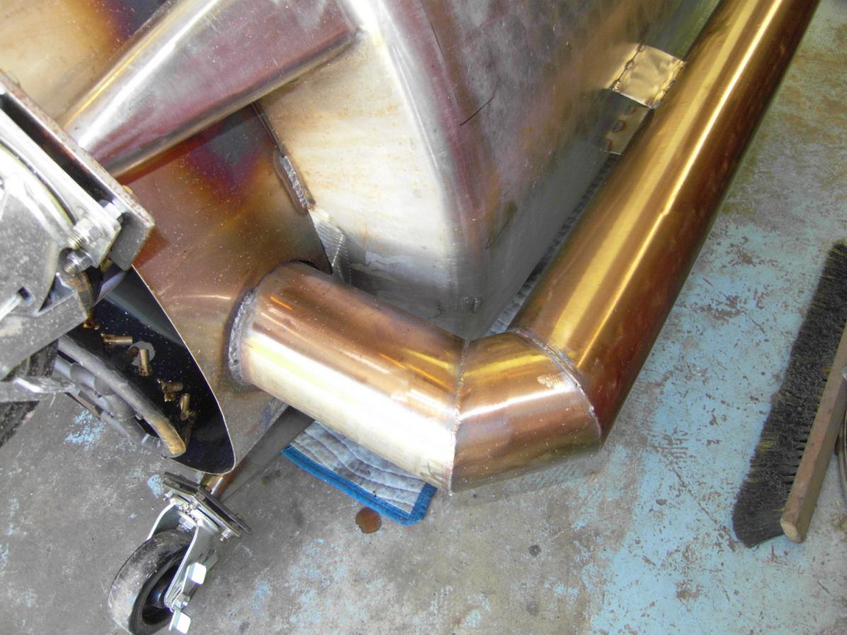

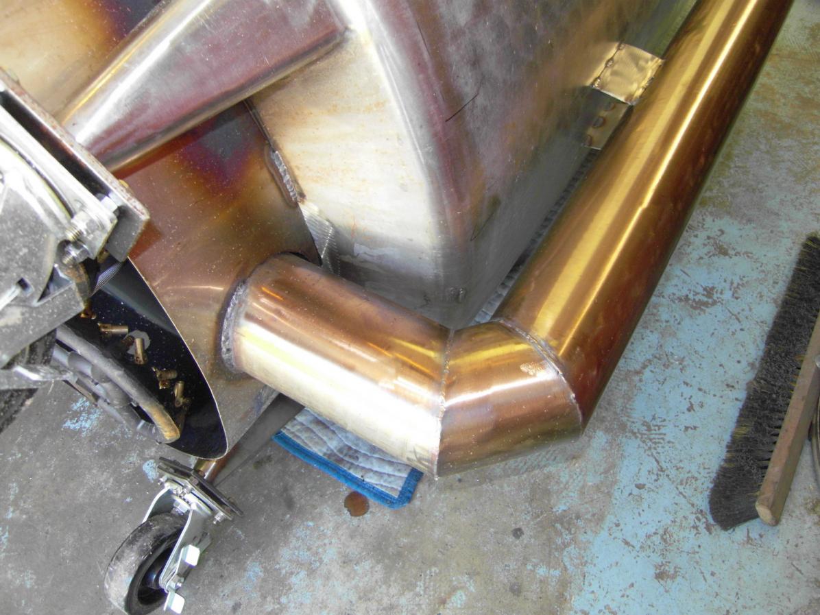

    I use Solar Flux all the time when I weld SST pipes, headers, tanks and things that are usually thin wall and do not want burn thru. I use water and a wire brush to clean it off the flux if necessary most time I just leave it on. The video was very good on how it works it helps from using a lot of Argon gas to be the shield if you are joining thing together and can't get Argon on the backside of the weld like a big 300 gallon tank.

    Have you ever tried cleaning it with the pickle juice? If not I'll have to pick some up and give it a try.

    Sorry, pickle juice is slang for pickling acid. The stuff you put on stainless welds to strip the surface ferrous and oxides. I've got to use it anyway most the time so if it helped a lot it would make cleanup a one-step process rather than two.
