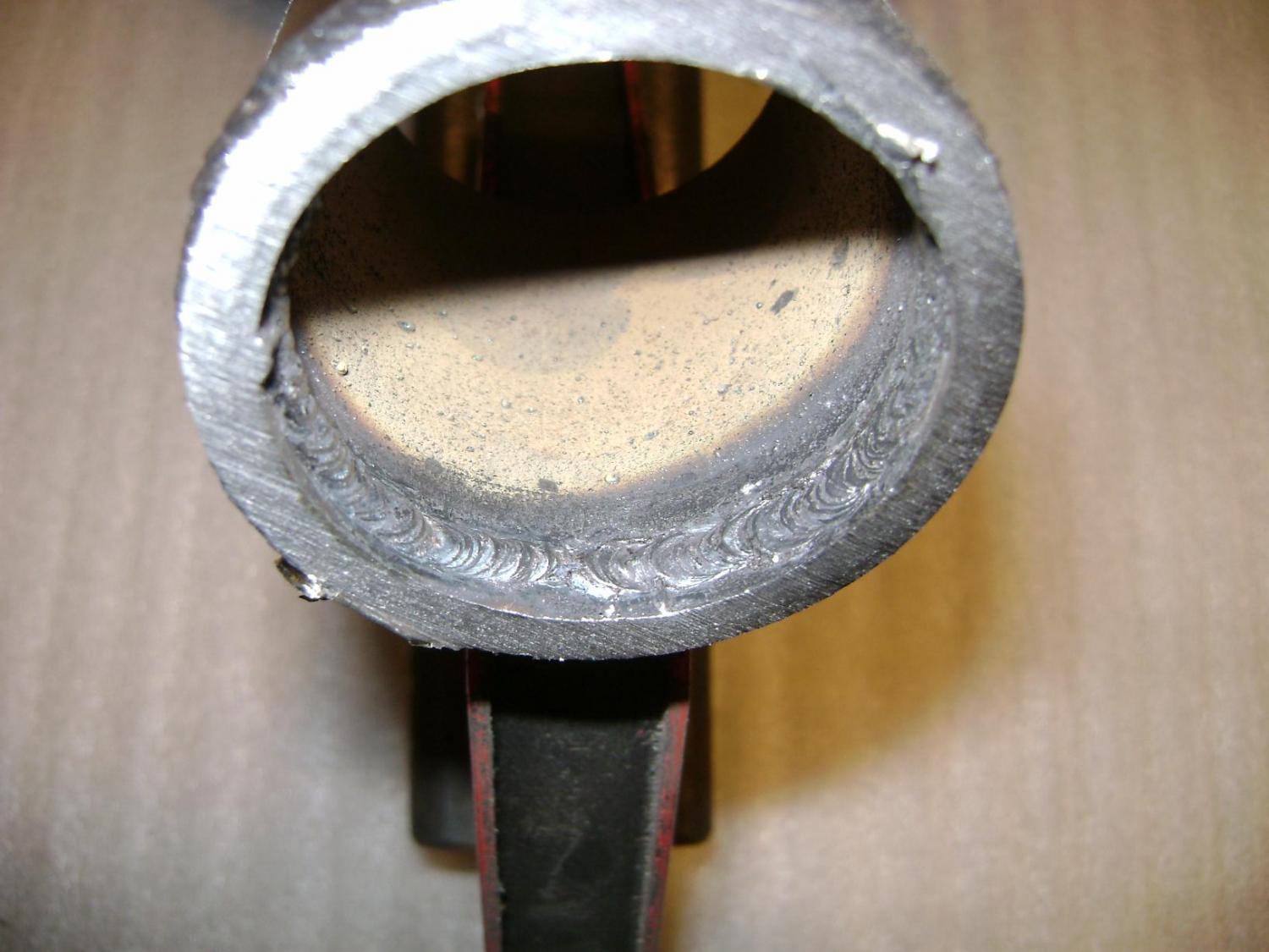

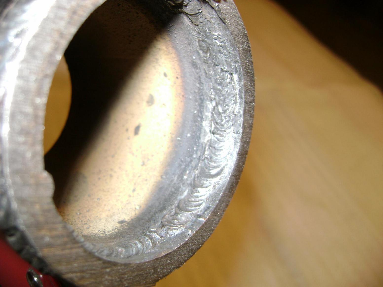

    I can't say I've ever seen a Maxstar. Have you run one of these PowerArcs? If not they sure have a sweet arc. It will run 6010 right there with any of my Short hoods, and run 7018 right there with any of my Red Face machines.

    Thats a very nice root and cap!! Im planning on buying a PowerArc 200 at the end of this month. One quick question what size pipe is that and what schedule??
    2-inch, sch 80.

    It's funny how these inverters like different rod. My Dynasty really like ESAB's Atom Arc 7018, but the PowerArc likes Lincolns Excalibur 7018. With the PowerArc you can do no wrong with Hobart's 335-A 6011, I mean no wrong! It also likes ESAB's 10P, and 10p-Plus 6010.
    You have to find the joint prep that works for you. If the rod is sticking, you'll have to turn the heat up.
    That means a thicker land, and tighter gap.
    2-inch sch 80 pipe 5-G vertical up I like a 37 1/2 degree bevel, 5/64 to 3/32-inch land, with 1/16 inch gap, at about 70-amps with 1/8 inch rod. 6-G I'll go with a 3/32 inch gap.
