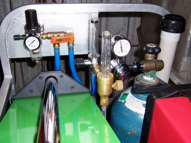

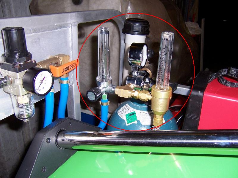

    Queensland, Australia
    23
    If you have the bubble type flow meters you don’t really need two regulators, just two flow meters. I had a regulator/flowmeter from a previous welder. I didn’t like the regulator as the contents gauge was installed opposite the cylinder connection (suitable ok for cylinder valves pointing up). The Everlast regulator suits the sideways valve outlet much better.
    So I removed the flow meter off my old regulator and, with the addition of a ¼” Tee and hex nipple, I grafted it onto the Everlast regulator. Now I can set the flow to my purge line without upsetting the torch flow.
    Having said that, I really like Glen’s solution and wish I’d seen it earlier!
    In the photos, the blue hoses go to the welder via the three-way valve so I can connect air for the plasma (it’s a multifunction PP205).
    Chris
    Brisbane Australia.
