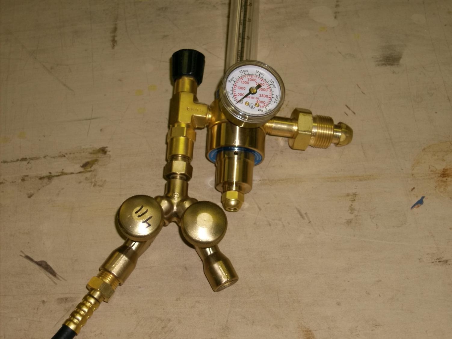

    I watched a recent video from Jody Collier about welding stainless, backpurging or using a heat sink. In the video I noticed that Jody mentioned the only way to get a purge line set up on a single tank is to purchase an expensive double regulator. Normally Jody's info is spot on but I knew this bit was wrong as I have a y with control valves ($12 Ebay, about $30 new) that works just fine for back purging. I thought everyone did it this way, but apparently not.
    I sent a photo of it and explanation to Jody and he was very excited to get the info. He said he would like to post it on his site. For someone as talented as he is, he is completely devoid of EGO, which is refreshing.
    Here is the text of the email I sent to him:
    "Hi again Jody. I found a picture of the y.
    I was thinking about the procedure for setting the flow and realized it is pretty easy.
    for example, if you want 2 litres per hr for the purge and 5 for the torch then leave the valve to the torch wide open (always) and set the regulator so that it goes to 7 when you step on the pedal briefly. After the torch postflow stops and the flow gauge has dropped back to zero, open the purge valve until you get 2 on the flow gauge. When welding starts this will jump up to a regulated 7, 5 for the torch and 2 for the purge.
    In this way pretty well any settings you want can be achieved."

    I actually use that valve for the 3 in one units, but turn it around the other way (it will work though the flow arrow is backwards) for changing gases without coupling and decoupling the lines constantly. I have recommended it to several for this. Western makes it I believe.
    It would work well for the machine connections! Yep, this one is a Western.
    I did the same by purchasing some fittings and a couple of gate valves. I guess the possible advantages of the gate valve for this application is that you can see which is on and which is off, plus it only takes a quarter turn to be fully on or off.
    The western Y might look neater on there though.
    With either one, quick couplers can be used to feed the Y so the machine can still be quickly disconnected and reconnected when a move is required.

    After using the y for some time now, I would say that the purge competing with your rig is a not a concern at all, it works perfectly for both if set as I mentioned below. For someone who doesn't have a second regulator on hand cost for a Y setup is much lower.
    I inherited a seond regulator a little while ago and mounted it on a second tank of argon I had here for awhile. I thought I would see if using this set for a purge instead of my Y would benefit the torch flow in anyway. As near as I could tell it made zero difference to shielding and weld quality.
    I suppose if you were trying to run a really huge flow thru the purge it could have some effect, but I never seem to do that. Once the main vessel is purged (before welding) it is generally only a small purge flow that is needed.

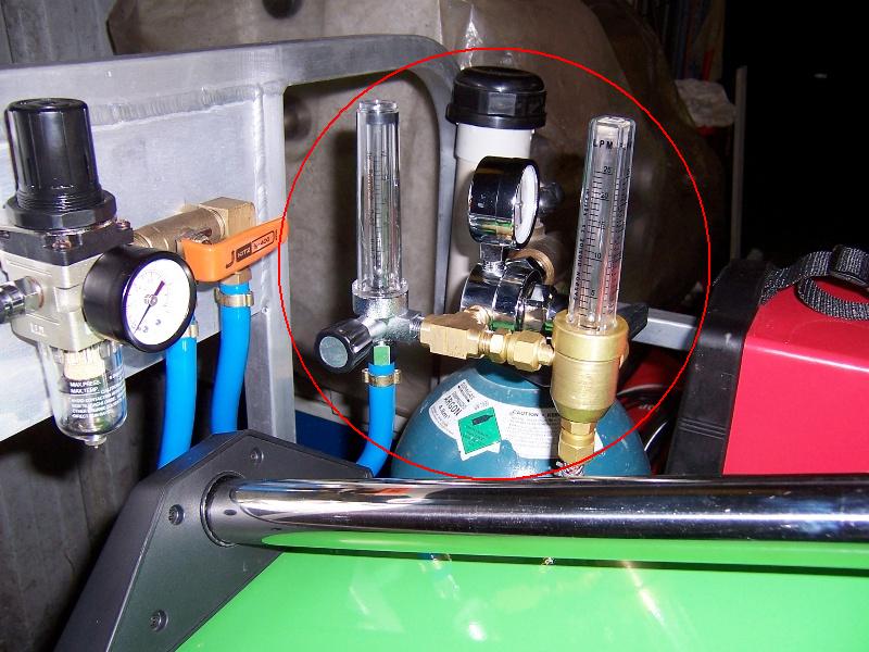

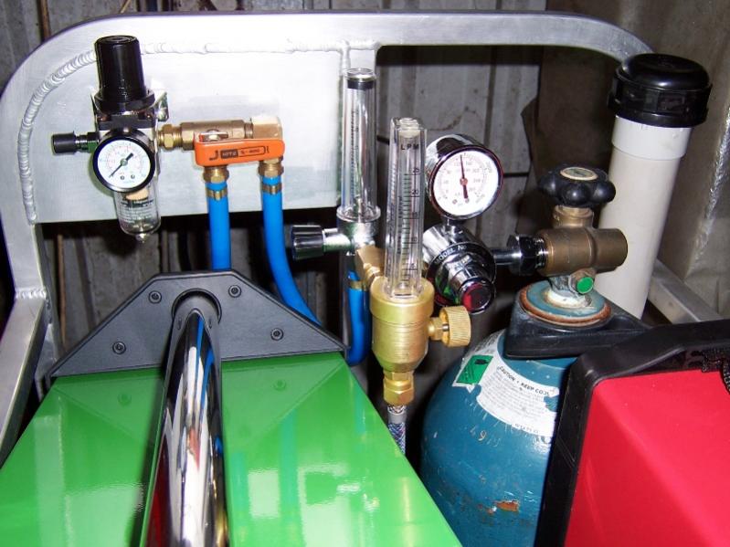

    If you have the bubble type flow meters you don’t really need two regulators, just two flow meters. I had a regulator/flowmeter from a previous welder. I didn’t like the regulator as the contents gauge was installed opposite the cylinder connection (suitable ok for cylinder valves pointing up). The Everlast regulator suits the sideways valve outlet much better.
    So I removed the flow meter off my old regulator and, with the addition of a ¼” Tee and hex nipple, I grafted it onto the Everlast regulator. Now I can set the flow to my purge line without upsetting the torch flow.
    Having said that, I really like Glen’s solution and wish I’d seen it earlier!
    In the photos, the blue hoses go to the welder via the three-way valve so I can connect air for the plasma (it’s a multifunction PP205).
    Chris
