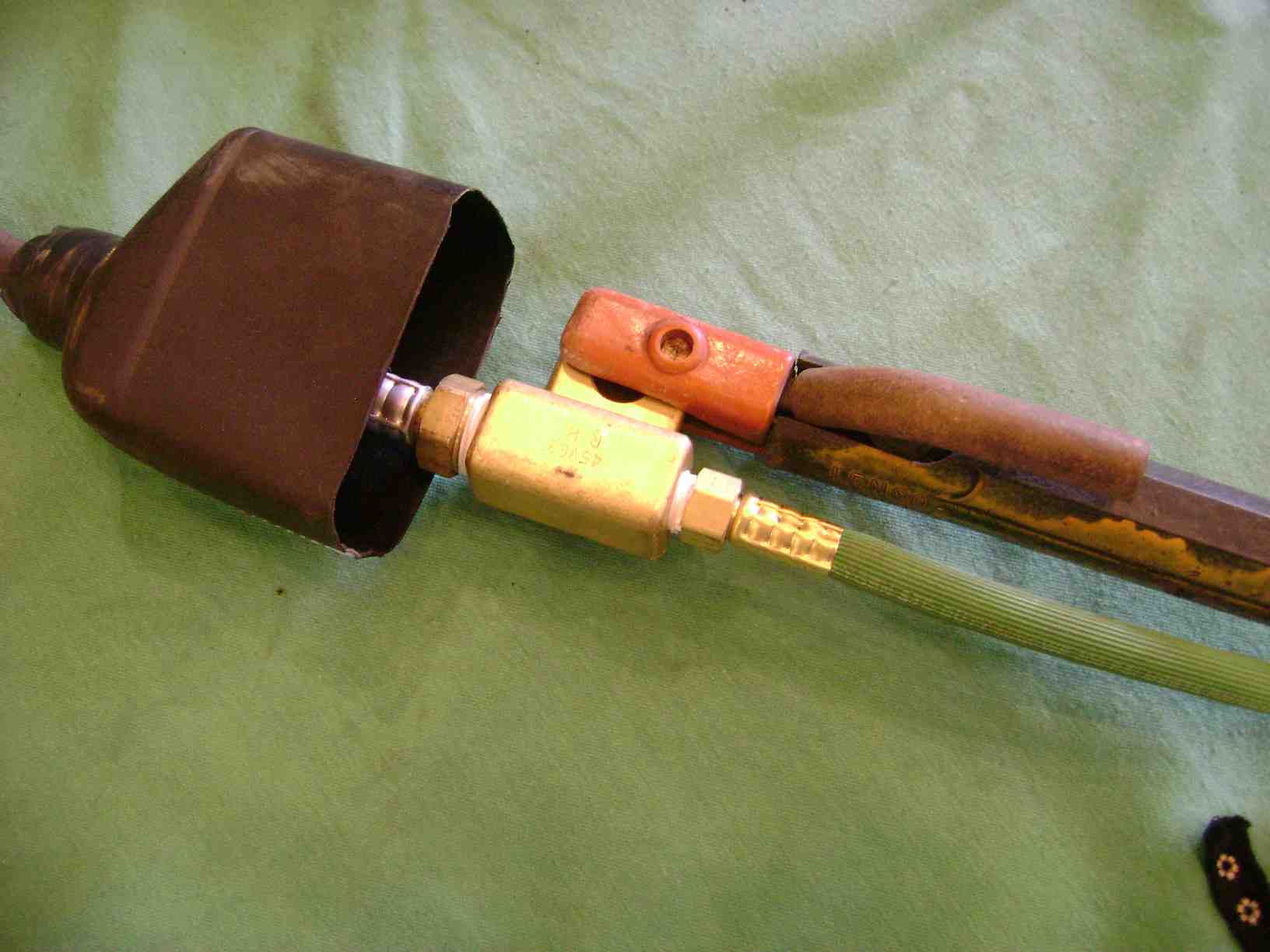

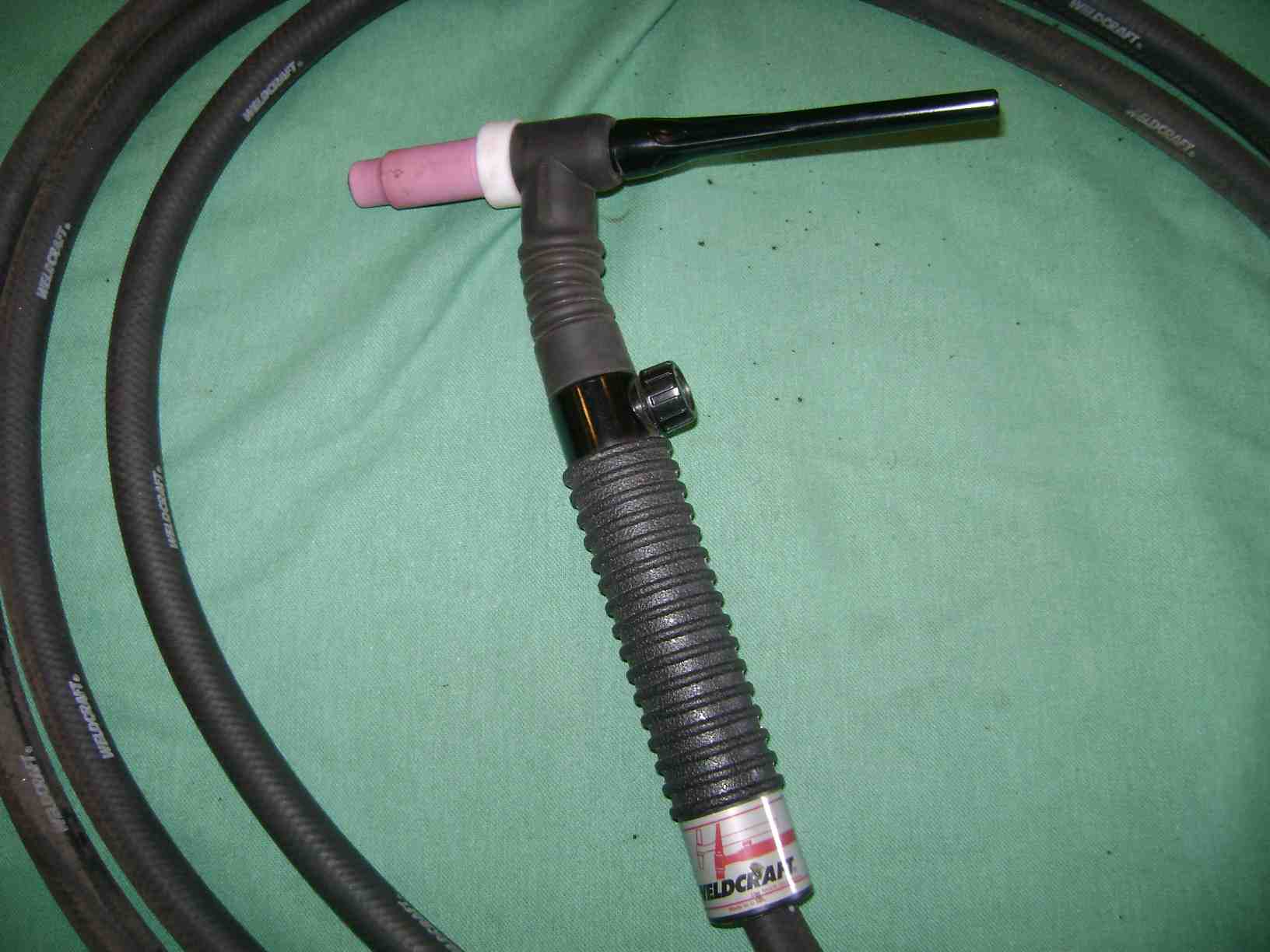

    Hi Oxide00! I gave my PowerArc 200 a go with a little Stainless, I hadn't welded in Stainless in at least 25-years. These PowerArcs have a very nice arc for SMAW, and GTAW as well.
Name:	Tig rig 200 amp.jpg
ID:	1194   Click image for larger version.
Name:	Tig power block.jpg
ID:	1195   Click image for larger version.

    Can I get the part numbers for the tig torch setup you are using.
    yeah me 3 i got the wrong torch get this guys. alot of my friends are getting into welding thanx to me passing on what i've learned (feel good to teach somebody something new ) and some have went out and bought new machines. hobarts, and 2 millers *i'd like a HB handler 187 but can't afford it. but when they found out i got my powerarc 160 for 300$, and it can function as a tig they took all their machines back! and are planning on ordering from everlast soon
    but please post the correct part number. it's almost time to get my baby back out of the box
    Aaron
    Guys, there are several ways to make this up. Go to your local welding supply store and depending upon the store, they may just be laying in bins or on shelves. Nothing special about this config that Carl is posting. The fittings are common, and you can use a Dinse connector as well. The most common torch is likely a 17V torch (V for Valve). But any gas valve torch will work. If you want a flex head, then you'll need a FV torch. (Flex/Valve)

    the 17v is air cooled right ? i still have my gas (the welding shop had a special buy 2 bottles of gas and only pay for 1 and 1/2) reason i asked is there's a few sitting around at the welding shop at school that were just replaced with new ones. if i can use them or get all of them i'd rather save some cash and maybe if somebody here needs one and their in a pinch. i'd pay it forward
