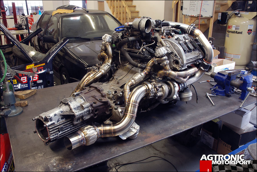

    Here's the "holy grail" as far as I am concerned... the kind of thing I can only dream of doing right now. This guy Markku at Agtronic Motorsport does amazing welding & fabrication work on VWs and Audis:

    Normally I would agree with you about the equal length runners but there just isn't much room to work with. The manifolds are extremely close to the frame rails, so space is limited and heat is also a concern. Here's another picture from Agtronic of a 2.7T with the type of turbos I am using (Garrett GT28xxR with the OEM/Nissan style compact 5-bolt turbine housing):
    Mine will look similar but minus the external wastegates. I'm going to see if I can fit the internal WG canisters on my application. Easier said than done, of course.

    Here are a couple of pictures showing how little space there is between the exhaust manifold and frame rail:
    Agtronic actually has an entire S4/A4 front clip that they use to test fit each custom turbo solution. The engine and gearbox in the pictures are actually empty (no internals) to save weight and make it easier to move around.

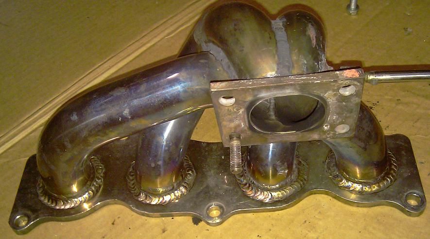

    Restraining something while applying heat (such as welding) can definitely help "persuade" it into a certain shape, or prevent it from warping into an undesirable shape while welding. Another approach is to anticipate and accept the warpage (from the contracting cooling weld bead) that will occur from welding, and set up the pieces in a way that makes the shape correct after the weld bead contracts, or use the contracting forces of the weld bead to change the shape into a desired shape.
    For example, if you welded on only one side of a turbo mounting flange where the pipes protrude, with the cylinder head side of the flange kept relatively cool, the contracting forces of the weld bead may warp the flange into a bit of a cup shape. With the concave side being on the direction of the pipes.
    If you then let it all cool, and ran some weld bead on the other side (cylinder head) side of the flange, you could persuade the flange to warp back to flat. Obviously the welding on the cylinder head surface probably would require surfacing afterward, but it could be done in a way that doesn't remove much material or make excessively thin portions of the flange.

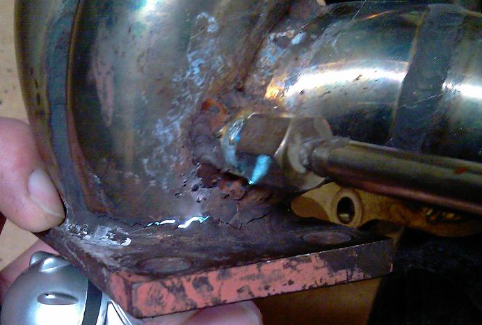

    I repaired a stainless steel turbo header for a customer (pictures attached, shows manifold prior to repair) that had the turbo mounting flange leaking exhaust gas because it was excessively thin. It was thin I believe because during original manufacture, it warped from weld bead connecting the tubes to one side of the flange, and then the warped tubes became subsequently over-thinned in one area from a surfacing operation afterward. The flange material in the middle where it was machined away the most was not rigid enough to reliably seal exhaust gas long term and the flange bent back the other way (that bolts were pulling it) and warped back the other direction during operation. Possibly overtightening the fasteners and a less than optimal gasket were contributing factors. I built up material on the flange where it was thin, and subsequently surfaced it to increase the flange rigidity. Doing some welding on the cracked bead on the back side, also helped pull the flange back straight so it was more uniformly thick and I had minimal material to remove surfacing it flat afterwards.
    Unfortunately all I have is the "before" pics on this. The tubing was ground away on its ID excessively thin in the cracked area right next to the flange, as someone got carried away with a die grinder and thinned the tubing out here too much without adequate weld bead deposit on the other side, creating a weak spot. The welded tubing was also undercut. I beefed up the weld bead to get rid of the thin, ground and undercut spots (and of course fix the crack) and eliminate the stress riser. A major contributing factor to the crack was also that turbo and downpipe were not supported, so the thin header tubes were carrying high vibrational stresses. These stainless header tubes were probably .049-.065'ish.
    Oh another way to reduce warping is to limit heat input and make a smaller weld bead. Using TIG pulsing, and a tight arc can be helpful to limit heat input and narrow the bead width. A "just large enough to get the job done" size weld bead will contract the material less than a "massive overkill size" weld bead. Also, a braized joint will warp far less or not at all compared to a welded joint. A good way to construct a thin-wall tubular header flange connection I've read about (but not tried) is to have the thin-wall tubing protruding into a hole machined in the flange, and TIG weld from the cylinder head side of the flange the end of the tubing to the ID of the flange. Then, for additional strength, add a braize fillet (such as silicon bronze) on the other side where the tubes protrude away from the flange. The braizing operation doesn't heat up the parent metal as much and causes much less distortion than a high temperature welding deposit. The braize material does have a different appearing, gold colored deposit compared to a weld deposit. This particular manifold pictured I think has a braized fillet, based on its appearance.
