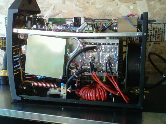

    Received the units promptly and tried them out. I burnt a few rods on the 225 and the unit worked good on stick. Switched to tig using the hand controls and unit worked good. Switched to foot pedal on the tig unit and unit didn't work. I called support and Ray walked me through troubleshooting the foot pedal and the pedal checked out. He said it has to be the daughterboard in the mainboard controlling the foot pedal. I got another call from Mike the next day and he suggested we open the case and locate that board to see if I might solder a new chip. When opening we found the mainboard support bent. Mike says it looks like it was dropped. He had me measure the bend with a straight edge. I show 3/8 on one side and 1/2 bend on the other. So back in the box it goes for repair/replacement. I follow the return with the shipping number and Alex signed for it on 2-22-11. So after a week with no news I send a few emails, no response, then call Cali, no response. I call Mark my sales rep get him right away and he provided some explanation. Next day i get a tracking number. Well a week later this tracking number still doesn't have a package. So I call Cali ext 202 and got ahold of someone, seems the tech/repair guy is relocating. Anyway, is it just me or don't you think they should of sent a replacement? I even offered to pay for an upgrade to a 250

    Got my 225 back yesterday. Unit works like it should now. Evidently it ended up in Minnesota for repair . The tech Eric called me to tell me it worked fine and there was nothing wrong with it. Hmmmm

    At worst, the problem did not present itself after thoroughly checking it out. At best it was a problem that was resolved by a simple check out of the unit. No "sitting" on it has been done. I have talked with Eric, and he and his guys don't "SIT" on anything. They work with it to get it to repeat a problem. They do go through and check and adjust everything. I think the end result is that it works. Its hard to go through all the tech support calls everyday, and find if its an Operator issue, or a unit problem. Our diagnosis ability depends upon communication, and sometimes we make some assumptions we shouldn't that we figure are a given, in an effort to speed up the diagnosis, and sometimes the customer makes assumptions as well, that we know about something they are doing that we don't. There isn't any intent to make things more difficult, but things do happen in the diagnosis procedure. Its not 100% fool proof. But the end result is that the customer said the unit is working.
    Thehagg
    Eric did called me and said that your settings were off , he even duplicated your problem
    So your unit was fine , looks like we need to add more info to the manual
    So it will not happend again
