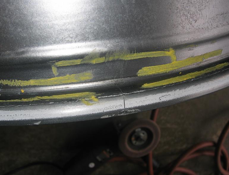

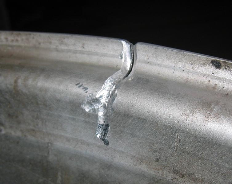

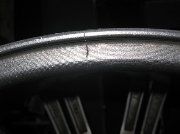

    I welded some cracked aluminum automotive wheels for a local wheel restoration company. Here is one that was cracked all the way through.
    This wheel was off a BMW "M". On this wheel it cracked when they were doing some straightening.

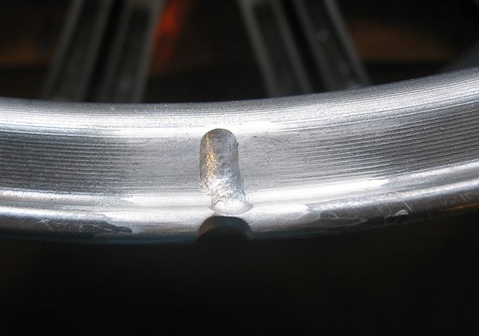

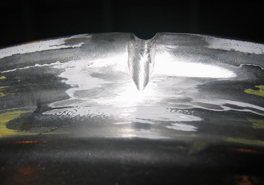

    After some surface prep to remove the paint, I veed out the bulk of the crack on both sides with a carbide burr. This wheel was probably about 5/16"-3/8" thick on this lip.

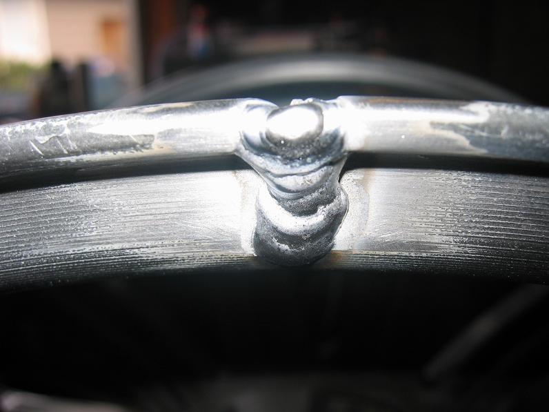

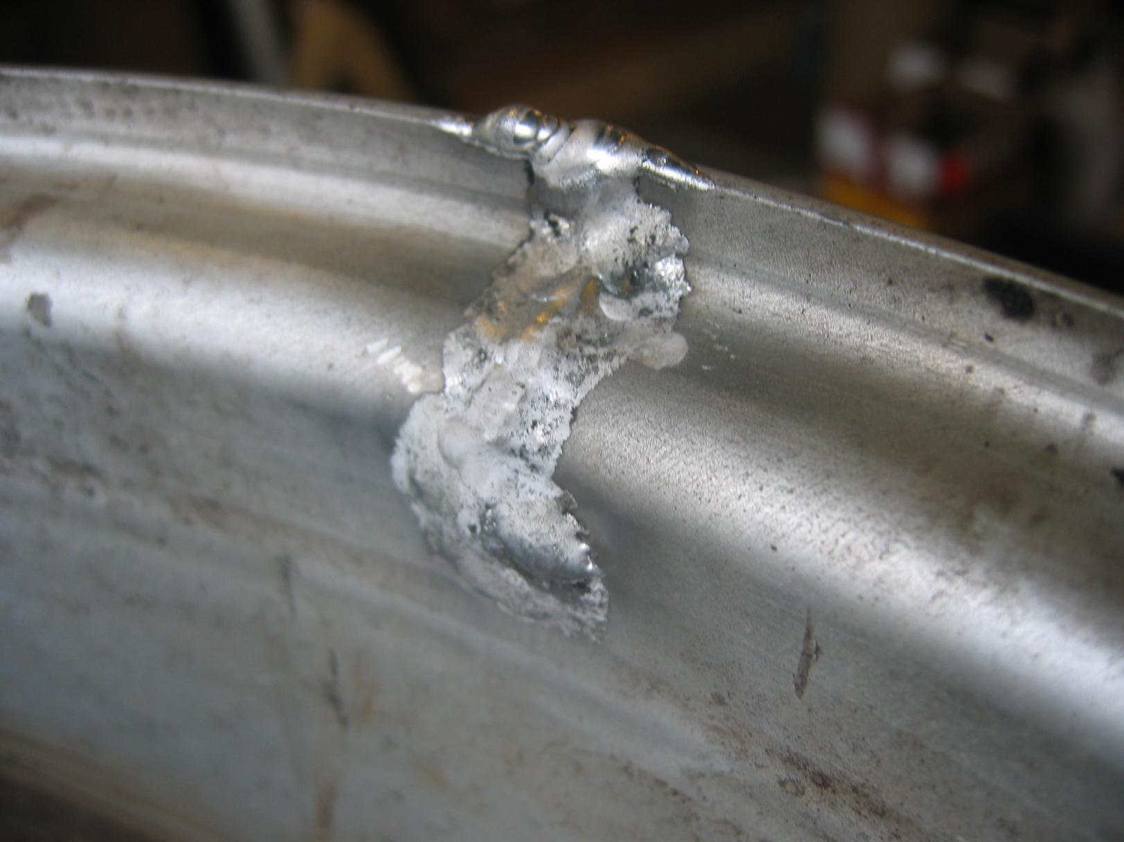

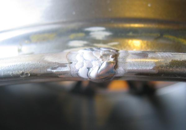

    I then attacked it with my TIG welder on the first side (front and back views)

    ...And then fully penetrated through on the second side.

    I love how once you fully penetrate into the bottom of an aluminum "crack valley", the crap stuck inside the crack floats up out of the crack and up to the surface, as the material flows together as the surface changes to a flat surface.
    From here the wheel restoration company is going to grind the weld down, probably check and perform any final straightening as needed, and apply a finish.
    I used... max (200 amps) current w/ footpedal, "min cleaning" A/C balance (20% DCEP / Cleaning setting), no pulse, 3/32" tungsten, and I was surprised I managed to get away with 1/16" 5356 filler rod without the tip of the filler melting too often. (I selected that size filler because I had some small "divot" touch up welds to do on another wheel.)

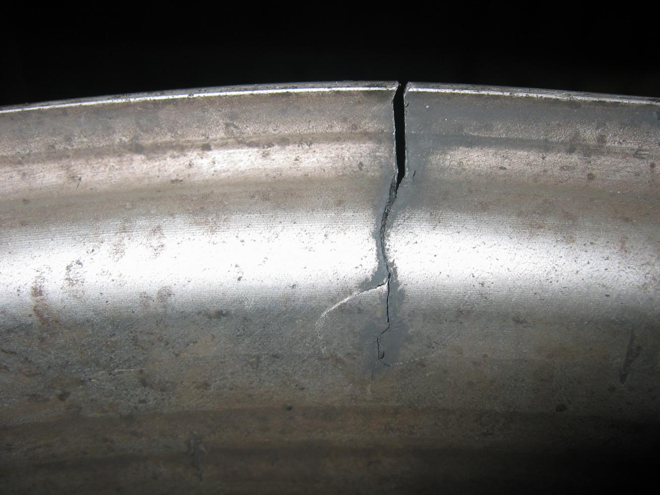

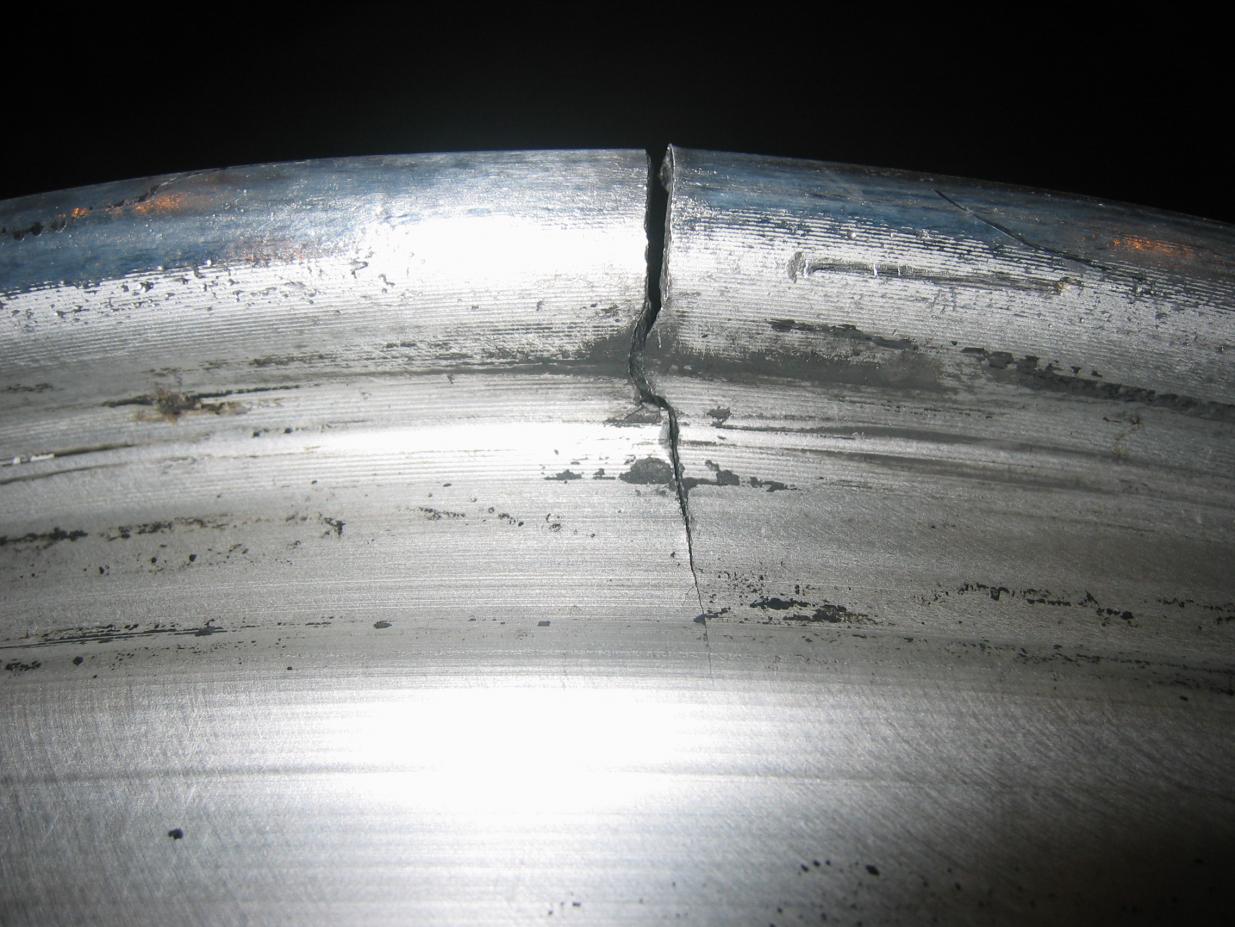

    I welded another cracked wheel today for the wheel repair company. This wheel was an aftermarket three-piece wheel that came off a Porsche. Quite light weight for its size, looked like it had spun-formed wheel shells and a nice forged "BBS style" center. Apparently the customer discovered this crack when he was having his tires changed. I would guesstimate a wheel like this would run in the several hundred dollars per wheel range (each) to buy new.
    Anyhow I did pretty much the same technique as on previous wheels - cleaned it, veed out the crack, welded it up. Since it was thinner (lightweight, spun formed) it didn't take as many welding amps as the previous thicker wheels I worked on. I took my time and let the cleaning action of the torch do its job, and kept going until the middle of the crack flowed out nicely and was totally continuous, solid metal.
    The wheel repair company should be able to take it from here, straighten it, grind the uneven weld bead down flat, and make it look like new. I like working on wheels that have a bare metal finish like this one the best, instead of ones that are painted. On this kind of wheel, you can't just trowel some bondo over the blemishes and cover it up with paint.
    Pics - Before:

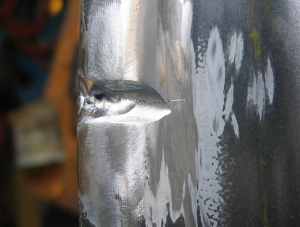

    I've done a few more crack & divot weld repairs for the aluminum wheel repair outfit.
    Here is my latest I just welded today. This AMG (mercedes) wheel measured a little over .40" thick.
    Attachment 1643Attachment 1649
    Before repair:
    Attachment 1642Attachment 1641
    I veed the crack like I usually do and also used an aluminum oxide impregnated plastic bristle cup brush to remove the paint down to bare aluminum in the area around the weld. It took a little time to work, but worked well. The bristles get into and clean irregular surfaces really well. Followed by a solvent clean.
    Attachment 1644Attachment 1645
    The key to penetrating all the way through on thick material like this is to bevel the joint. I like to go over the joint with my TIG torch at a low power level first, using the AC cleaning action to blast away any remaining contaminants and burn/evaporate any remaining oils/solvents that may be stuck in the crack or in the pores of the metal. Then when it is all looking good, I hit it with the real metal melting power.
    You know what, I didn't feel like I needed any more power than the 200 amps my machine can muster. I had it set at about 25% cleaning (EP%), no pulse, and the machine has a fixed 60 Hz AC frequency.
