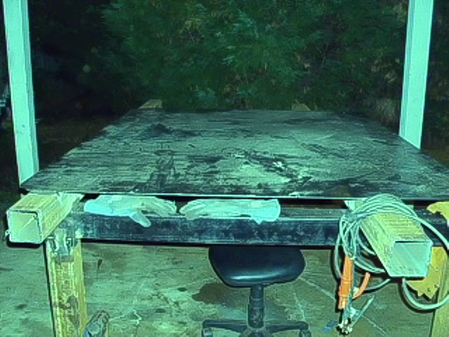

    this is more of a work bench than a welding table, but I do tack down jigs and parts here to weld them out.
    I used old cutting edges from a grader for the square frame under the table top
    and some FREE 2x3 3/16 tubing for the legs
    left the front overhang at 4 or 5 inches so I could clamp things on the edge.
    I did have to buy the 1/4 sheet for the top, had them cut it to 3'x8' and I'll use the 1x8 strip left for a shelf over the back end(one of these days)

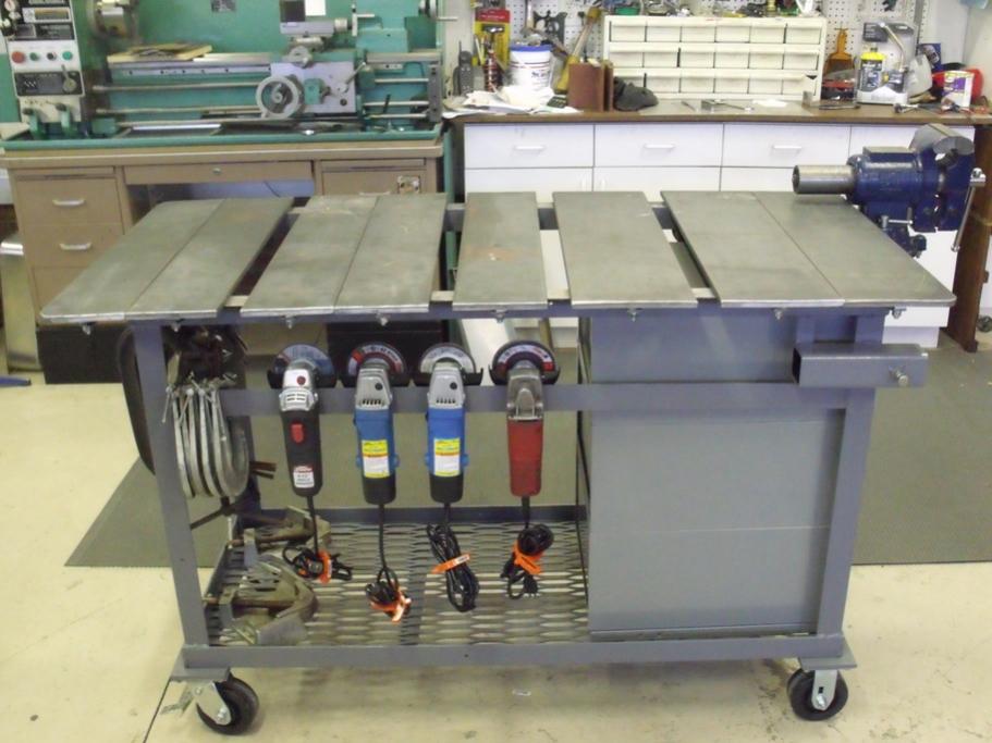

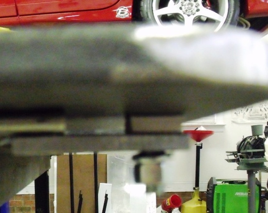

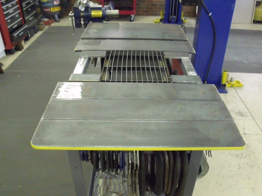

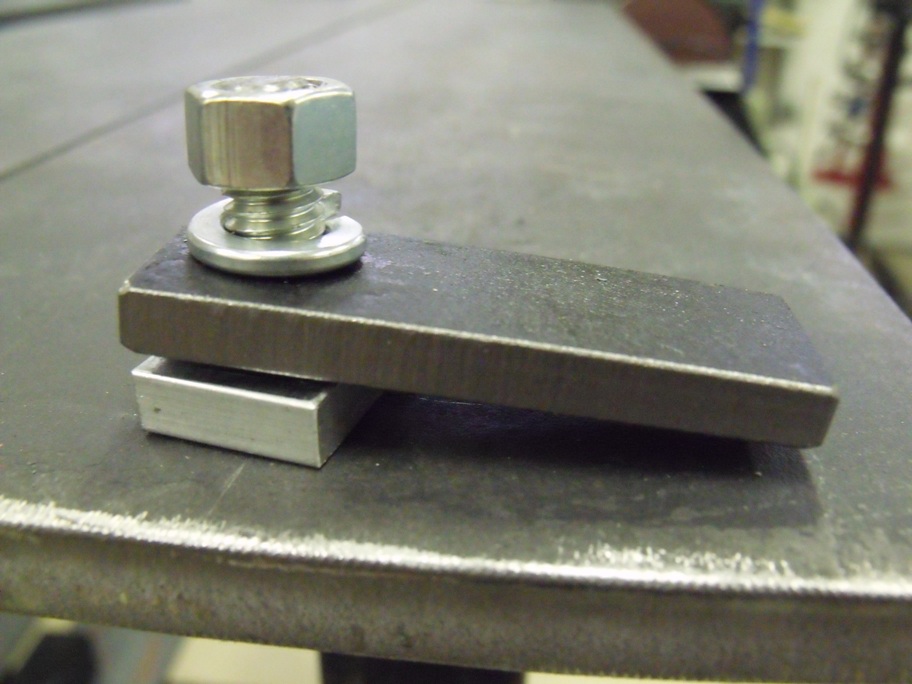

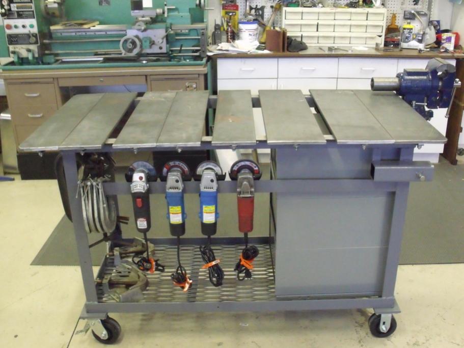

    I built it from pictures and ideas I have seen on line. The slat design I came up with is handy as I can configure them any way I need to and even built a cutting table and hopper to catch the sparks that fits in place of some slats. My teo receiver tubes worked out well, I have a vice in one and will be putting the HF bar bender in the other when it goes on sale and I cab use my 20% coupon.

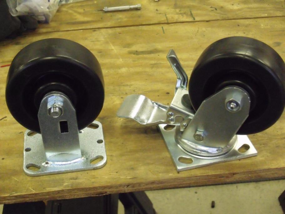

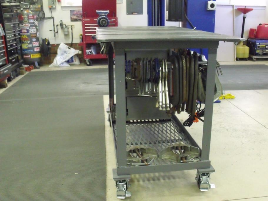

    I like your idea of two wheels and two leveling feet If the table and all that it holds is light enough. But I estimate my table at 300 lbs empty and with everything stored on it Who knows how heavy it is.
    My casters are 5 inch dia and hold 600+ lbs each. with two fixed and two swivel, the swivel are the total locking type and lock the wheel and pivot. Here is a picture of the casters and table except now there is another few hundred lbs of steel drops on the expanded metal tray.

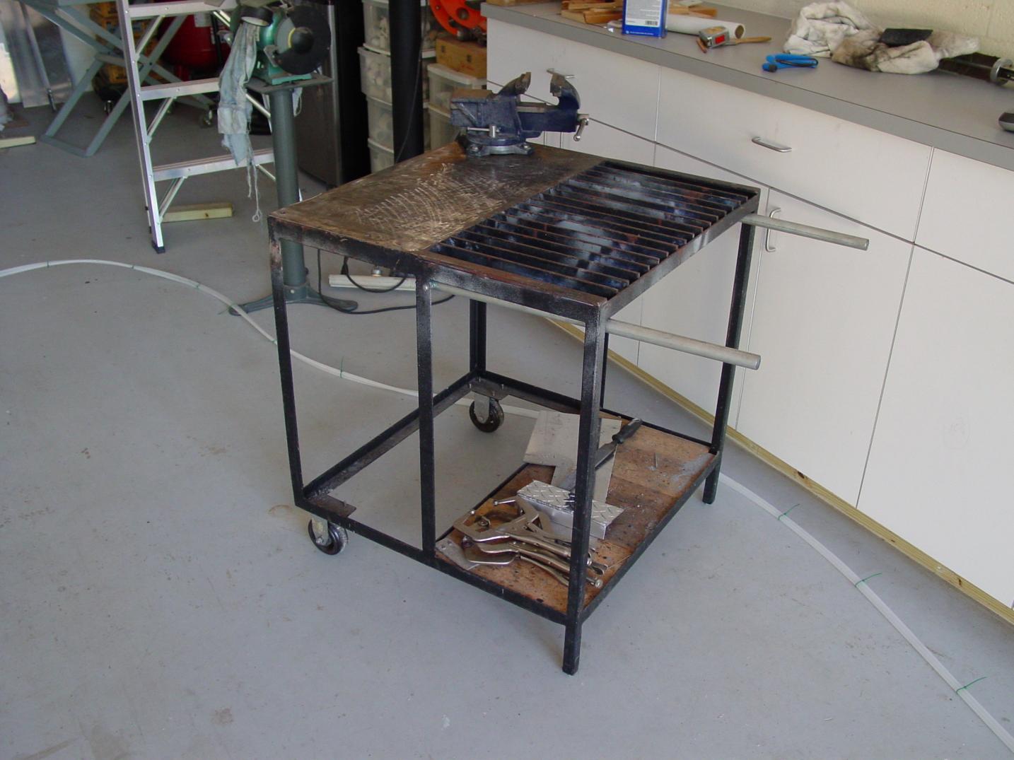

    I made this table over ten years ago, it has been used well. I got the plans out of the Welder's Handbook. I like the table because it is portable and its big enough for almost everything I need. The vise is a must its threaded right to the top so I can remove it in less than a minute, also I've threaded other holes for my bender so this table is pretty versatile.
    My casters are 5 inch dia and hold 600+ lbs each. with two fixed and two swivel, the swivel are the total locking type and lock the wheel and pivot..
    I saw those and the 6" version at IMS when I was designing my table. When I saw those big, 10' solid tires with axle bearings at HF, I knew they were the answer to my problem. My 10" wheels allow me to roll over debris that casters can't. If there is too much stuff on the bottom shelf, I just use a 2 wheel dolly to lift the end with levelers and roll across the shop; just like a trailer dolly allows me to move a boat. My shop is always too messy to allow casters to roll uninterrupted. I doubt that I will ever exceed 1000 lbs. on my tables. I put the 8" wheels on my Mig cart. It rolls through gravel on the driveway with no problems.

    I almost made a 4' x 4' version of that. Then I realized how much mess my plasma cutter makes, so I decided to rethink the plan. I considered a catch pan for the plasma half, then I saw a really great set up on Pirate4x4 site. The guy made what looks like a 5' x 2' plasma cutting table with a funnel design under it to direct all the dust and debris into a metal pail. I'm going to make one next week.

    Man, that is a thing of beauty. Great design and nice work.
