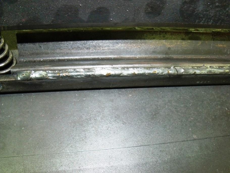

    It is the SWAG off road kit. I have to modify it for my press by extending the tabs you see on the front and re welding the clamping ears. (it seems to work fine without them so we will see if I need to do that) the HF 20 ton has 4 inch side beams and my Arcan has 7 inch wide rails and is rated for 30 ton even though it had a 20 ton jack, I added the 20 ton Air over Hydraulic you see in the picture.
    Please give me feedback on the welds as I'm still learning
    I mig 200
    1/4 mild steel
    175 amps
    22 volts
    0.35 solid wire
    75 / 25 mix
    The test bends were on 3/16 mild steel and there was no resistance at all. I like this tool.

    Looks like it makes a good bend. Your welds should b fine for this project, dosen't look to me like the welds are really under any stress, they more or less just hold things straight and allow the spring to return the wedge. I'm no expert welder either, but looks like you may have been a little cold/ moving too fast. the first thing I always do before I weld is get comfortable, make a dry pass with your welder down the weld and pay attention to your angle/stick out. If you are comfortable for the length of the weld, burn it in.
    I'll b interested to see how you like the little press brake, been thinking about getting one myself.

    I decided to get that kit when I priced out the steel to make one from scratch, it came to more then the kit and a lot of what was already done is cleaner then I could do in my shop. I am not bad but no match for cnc bending and laser cnc cutting. I have only made three test bends but it is solid and precise even whit my Noob welds holding it together

    Bending 1/8 x 48 inches long steel will take a lot of pressure, Im not sure a 30 ton manual press will do that. And the inside width of a 30 ton is only 29 inches or so.

    I am guessing you mean the top die that does the bending. It is cut at a 60 Deg. included angle with about a .100 flat at the tip
