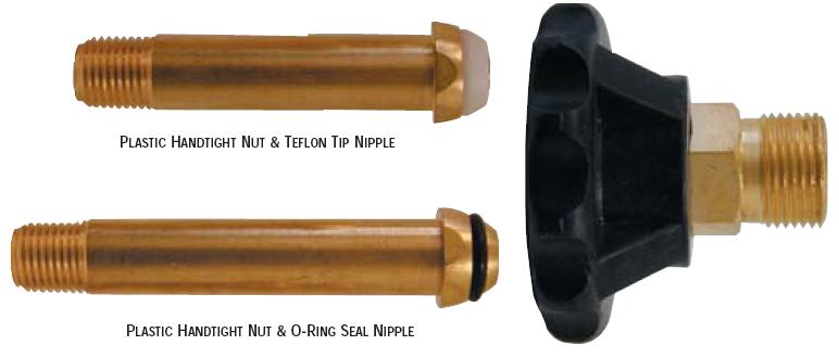

    I don't mind changing the DINSE style connections by hand, which my machine uses for the stick welding lead and the ground clamp lead, but not for the TIG torch and plasma cutter leads. The DINSE connector is really simple to untwist by hand, stick in the desired hole, give a quick twist, and good to go.
    The TIG torch and plasma cutting torch fittings however I find much less convenient. I generally use a wrench and gently snug the hex head union nuts to ensure a good electrical and pressure tight connection, but its a bit of a hassle needing to dig out a wrench. Switching between TIG torch and plasma torch is one of the reasons I don't use my plasma cutter very much.
    As to leaving in stick welding and TIG welding leads connected at the same time, my machine allows this but its a bad idea I think because both TIG torch and stick electrode holder would be energized at the same time. I would only want the one I'm useing to be energized, for safety. (Also it might cause problems starting an arc when TIG welding if the high frequency were leaking out the stick electrode holder.)
    I have an idea. It would be a lot easier to switch between TIG torch and plasma mode if the TIG and plasma lead connector nuts had a large "hand tight" wheel over them, allowing secure installation without a wrench. I'm envisioning a hand tight wheel such as like can be found on some CGA cylinder fittings. (See attached picture for an example of a "hand tight" nut.)
