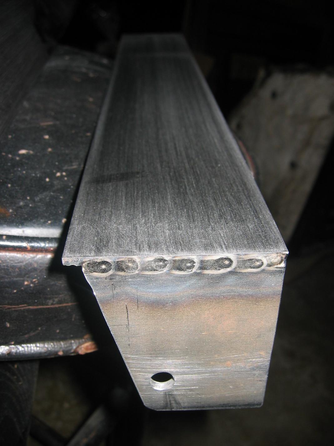

    My machine (an older Mosfet-based Everlast "Super200P") goes up to 300 hz pulsing frequency. the 300Hz pulsing is helpful for constricting, focusing or "stiffening" the arc, and making it penetrate more deeply and not having the heat spread out as wide.
    But a skilled welder can accomplish similar effect without using pulsing at all, by simply holding a tighter arc length (holding the tungsten electrode closer to the work.) So, its best to learn to weld without pulsing, to develop manual heat control before experimenting with pulsing.

    I can tell you that in actual use, high frequency pulsing (300Hz) has an effect in DC welding that is helpful to keep the arc more directional and focused. It can be helpful to prevent the arc from melting a nearby edge. (See attached pictures, showing 1/8" 1018 steel flatbar I welded with 300Hz pulsing, close to an edge without melting the edge.)

    Low frequency pulsing can be helpful for limiting heat input, for example, if you are welding thin sheetmetal and want to minimize distortion. Whereas I usually use high frequency pulsing more when I want to make the arc more directional, contricted, and "focused".
