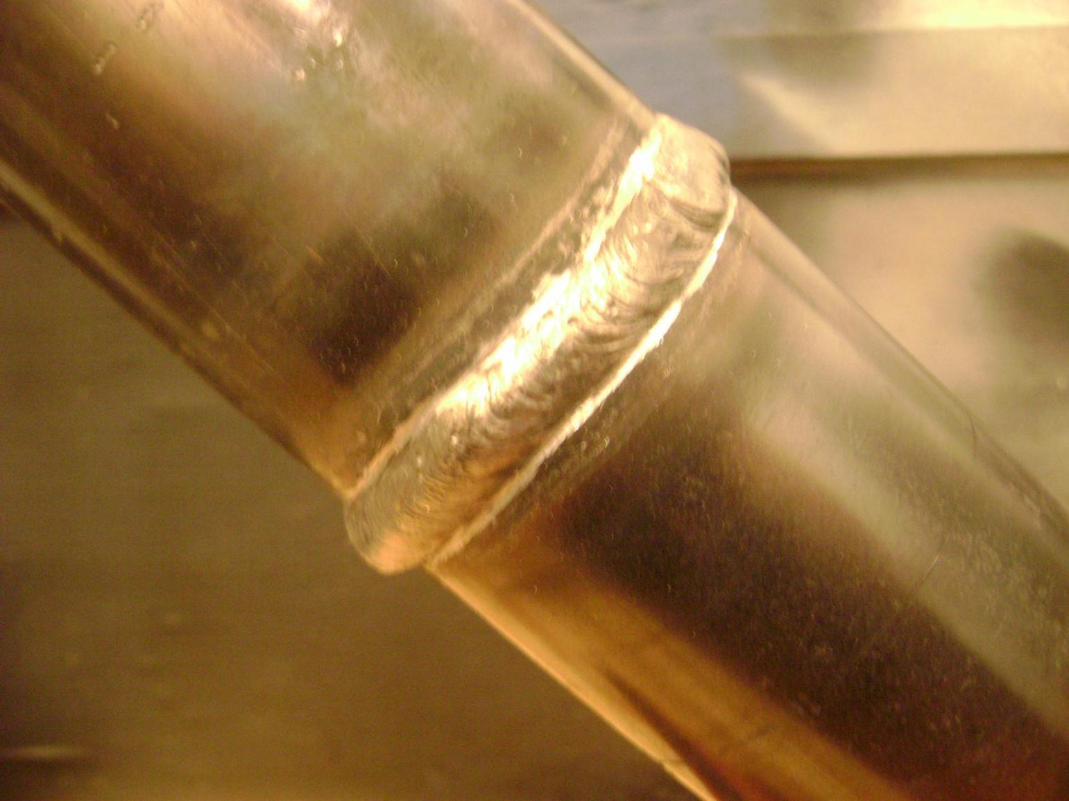

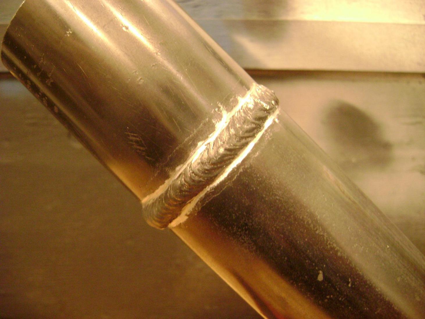

    Scooter I don't know what you have planned for your PowerArc 200, and everybody has their preference for brand of welding rods. I only have two inverter welders, and it's strange to me that these inverters run differently with each brand. In my opinion only, my PowerArc 200 likes Lincoln's Excalibur 7010, ESAB's 10P 6010, and Hobart's 335A 6011.
    Here are a couple pictures of 7018, and 6011 welds on 2-inch pipe done in the 6-G position.

    Sheild Arc, very impressive welds, I will keep the 7018 Excalibur rod in mind when I run out of the Hobart I have now.
    Scooter
    Scooter like I said these inverters are strange machines, now remember I come from the transformer / generator era. My Dynasty 300 really likes ESAB's Atom Arc 7018. Now my SA-200s don't really give a hoot what brand of rod you clamp in the stinger!
