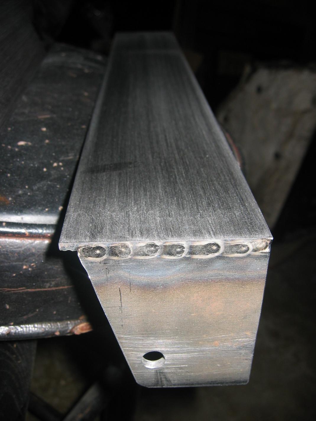

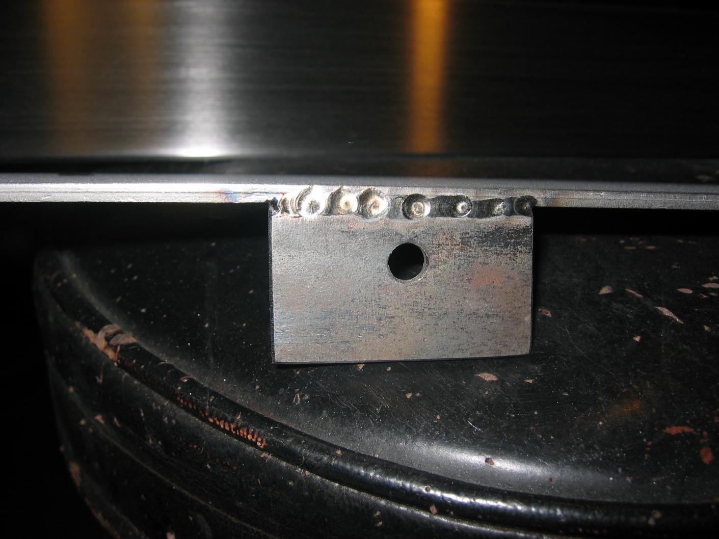

    If its clean inside the steel crack, and you've got a TIG machine with enough power, no need to vee it out. Just hold a tight arc, and use plenty of power, to penetrate deeply. Even some high speed pulse (DC welding) could be helpful to concentrate the heat better and penetrate better. Welding on both sides, all you need to do is penetrate at least 50% on each side and you'll have full penetration weld. Use a little bit of filler rod to avoid undercutting, but probably not much needed on a tight fitting joint.
    There may be a direction that is more desirable to weld - (welding towards or away from the beginning of the crack) but I can't really say which is best or if it matters. Keep in mind that welding will cause tension/contraction/"pulling" forces though. If you had a gap that was a little wide at the open end, you could tighten it up by sequencing your weld to begin at the beginning of the crack (where it is tight) and as you welding along the joint, the cooling weld bead would tend to pull the pieces together into alignment.
    If the pieces of metal are in perfect alignment, do a few good, deep, high heat tack welds first to keep them right there. "backstepping" can also minimize distortion (where you weld it in short "stitches", and move the torch when the arc is on, in an opposite direction as when the arc is off.)
    Attached pictures are example of backstepped, stitch welded steel joints I made (to keep pieces in alignment and reduce weld distortion.)
