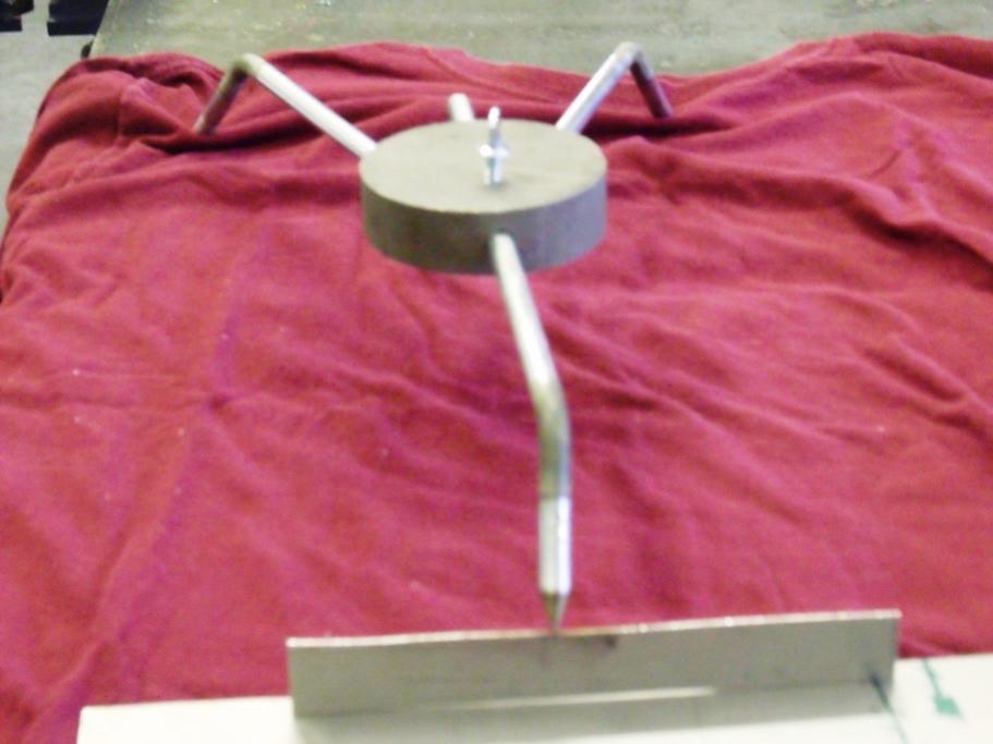

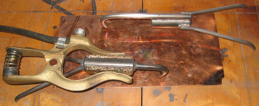

    I have been looking at these on different forums for a while and decided to make my own. It is a bit different then most I have seen. I made the holding arm adjustable by milling a flat on the 3/8 rod and drilling and tapping the weight for a thumb screw.
