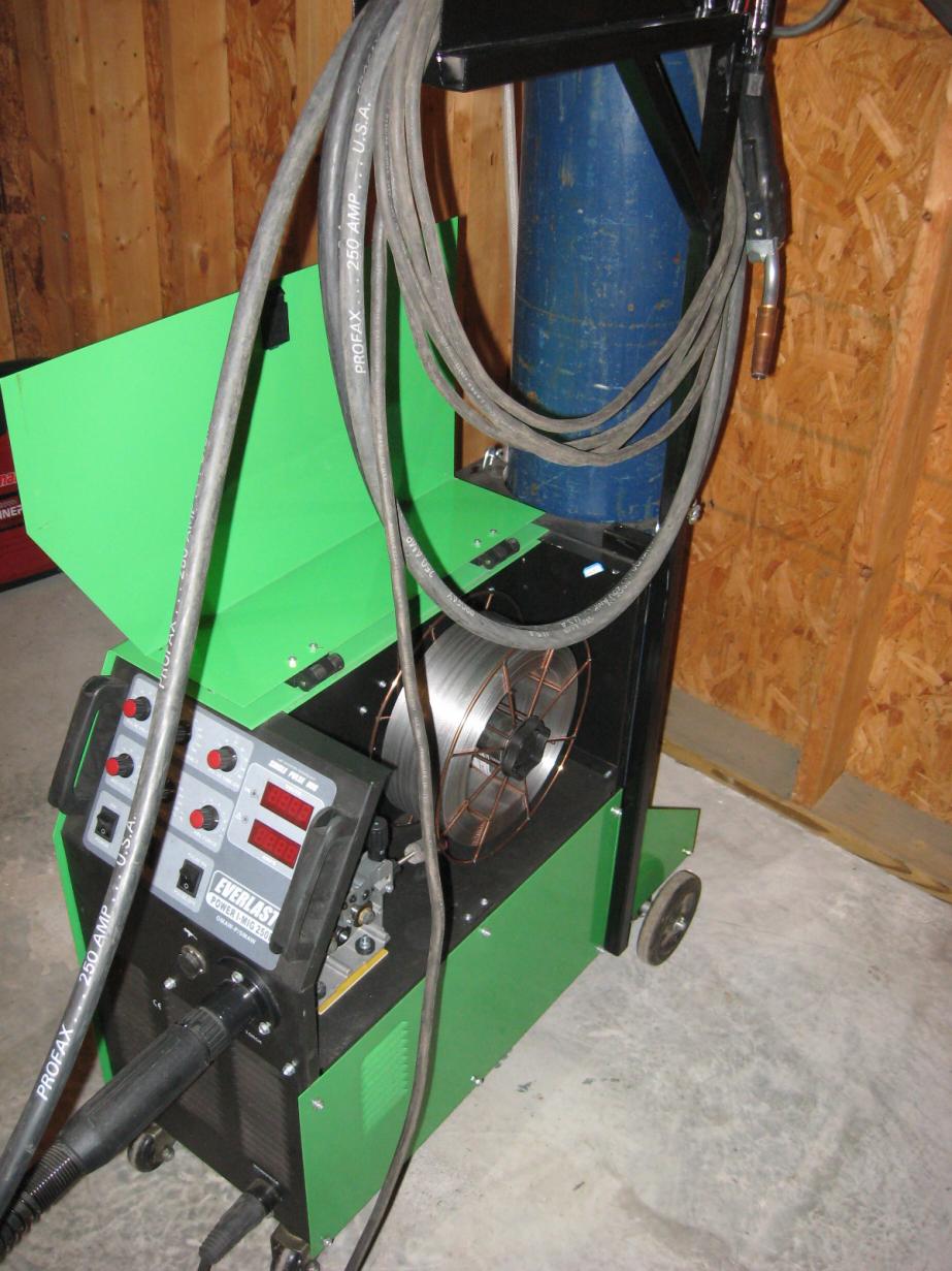

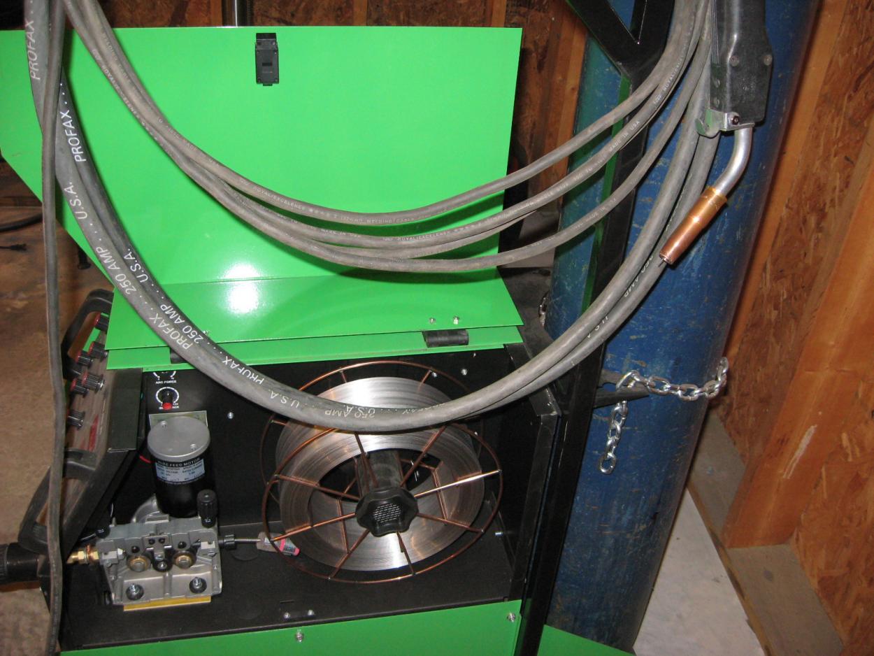

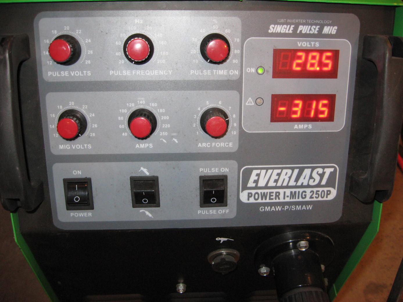

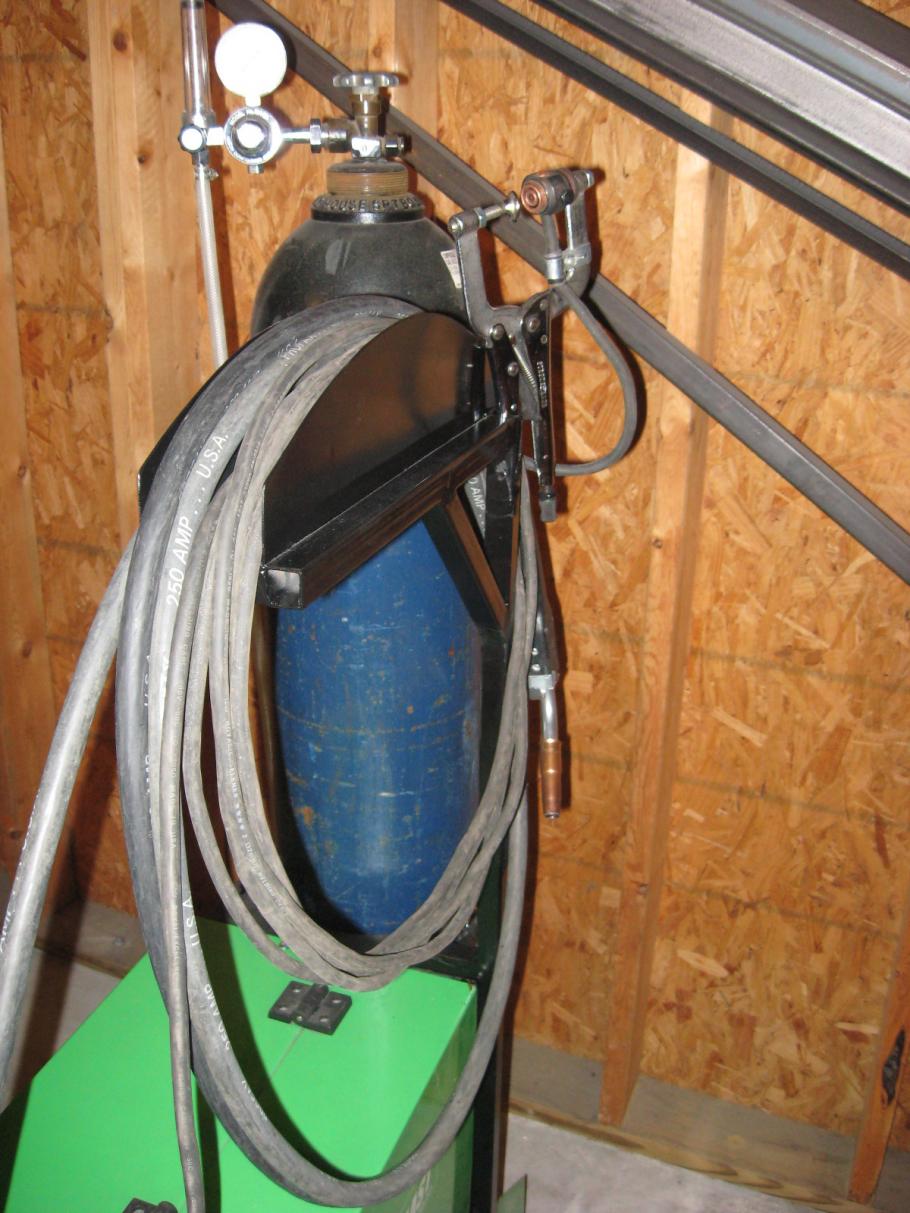

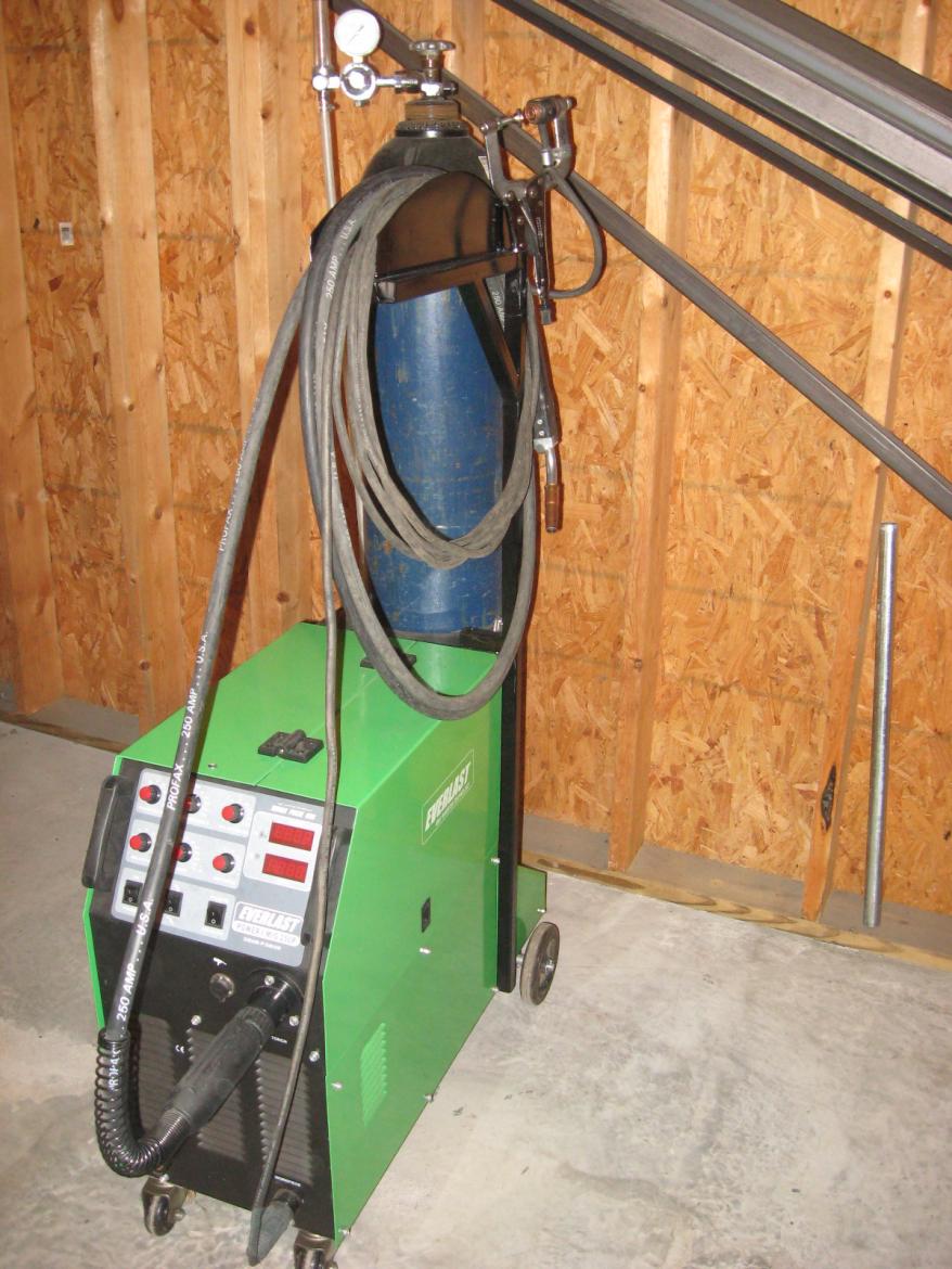

The IMIG 250P will do that with ease. I added a 20' profax gun for longer reach and made a hanger for my leads.
I've since changed the MIG gun's front end parts from 21 style to 23 style that comes on the "HD" gun because the screw on nozzles stay centered. The work clamp pictured is made by Stronghand.
You can use a spoolgun for aluminum and the machine also stick welds.

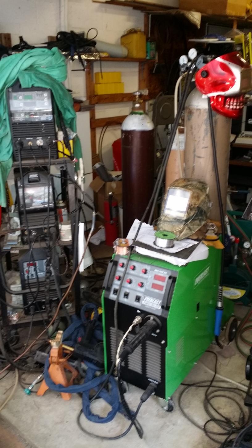

If you are not going to be mobile. 205P or 205. You can still pick them up but need a little more generator. I also have a 250P, like Zoama, would never part with. Our MIGs are a little pricey, but all of our products are great welders, it just cost more to make a good MIG.
Attachment 12708
The 250 is actually a better choice for the average customer. It has spot and stitch timer along with burn back and arc force control. The 250P's shortfall is that it does not have a synergic and double pulse. It's manually set, and for the average person too difficult to set correctly.

The standard 250 does have it. Now I think you misunderstood what I said from your earlier comment...or I misunderstood your statement. The 250P is a single pulse not a double one and does not make the stepped look that people think of with a slow pulse on a TIG. (Stack o' Dimes) And again, it is difficult to set unless you know what you are doing.
