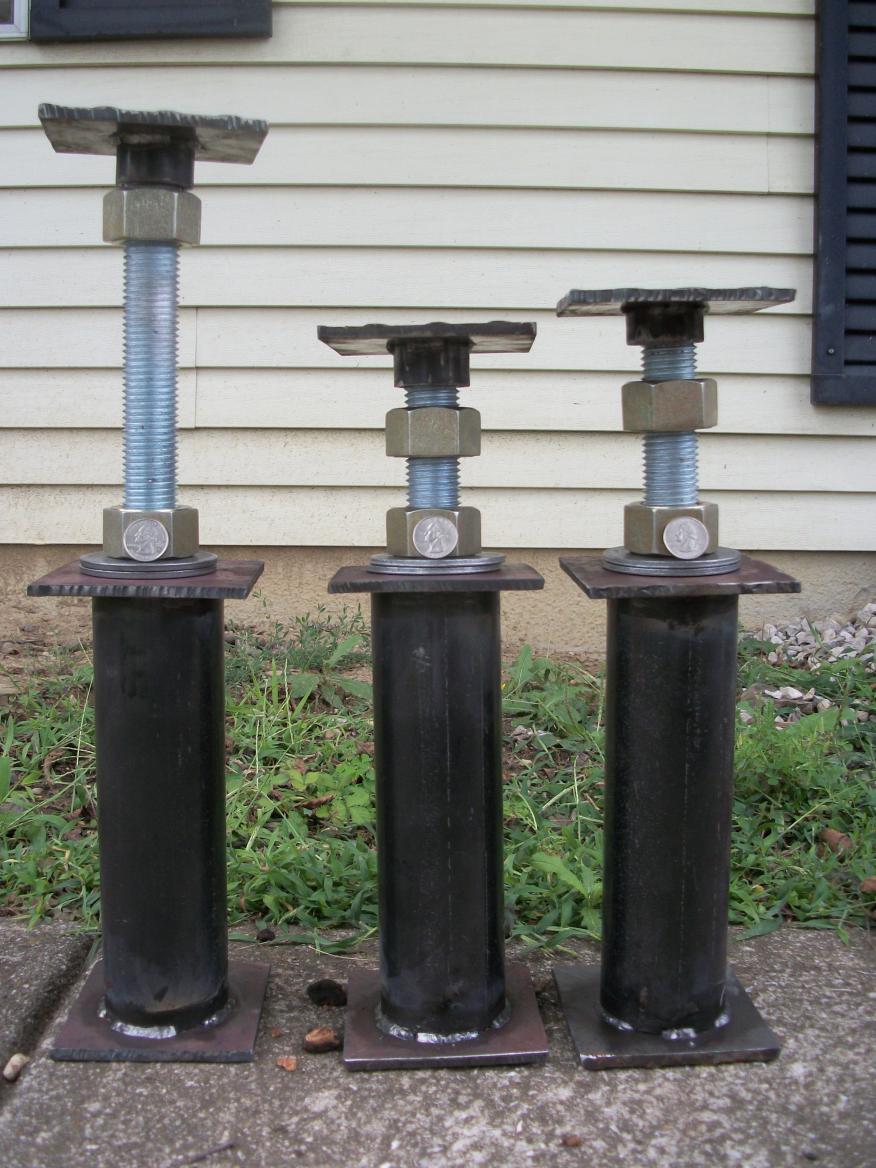

Getting ready to attack water damaged and rotted second floor structural joists and need to build temporary support prior to the removal of the load bearing exterior wall. The fabrication effort was to create 20 screw jacks using 1.25" threaded rod.
Printable View
Welded the top nuts to the threaded rod today. Also, added a wider base plate to the first few under-engineered examples. Nice to have this, "job to do the job" effort completed.

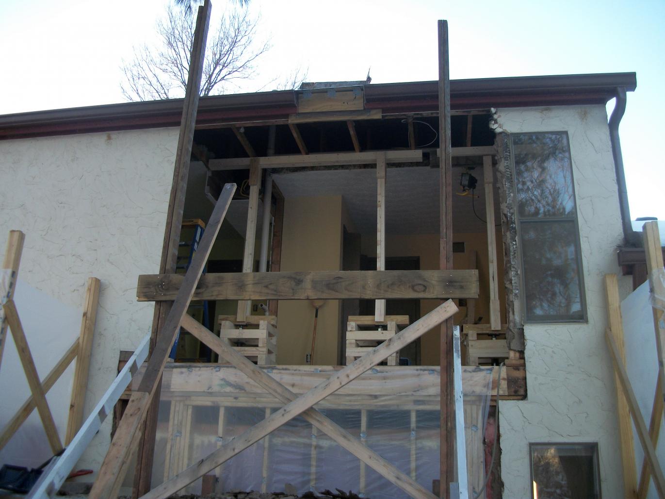

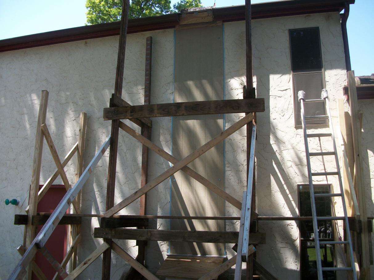

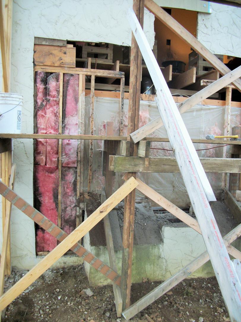

Here's the reason for the screw jacks. This is the second floor above a great room. The chimney has been removed. Once the temporary support is put into place the exterior wall can be breached for the repair effort.
The scaffolding had two levels for the chimney removal. Now, it's just one level for the rim joist replacement. The original cause of the issue was stucco applied to both the house and the chimney together with no expansion joint. The house and chimney move/expand at different rates causing small cracks. The previous owners let the gutters overflow for years and the water entered the interior walls to cause this mess. Stucco is a fantastic finish when done right. It's rarely done right, however.
Attachment 12301Attachment 12302Attachment 12303

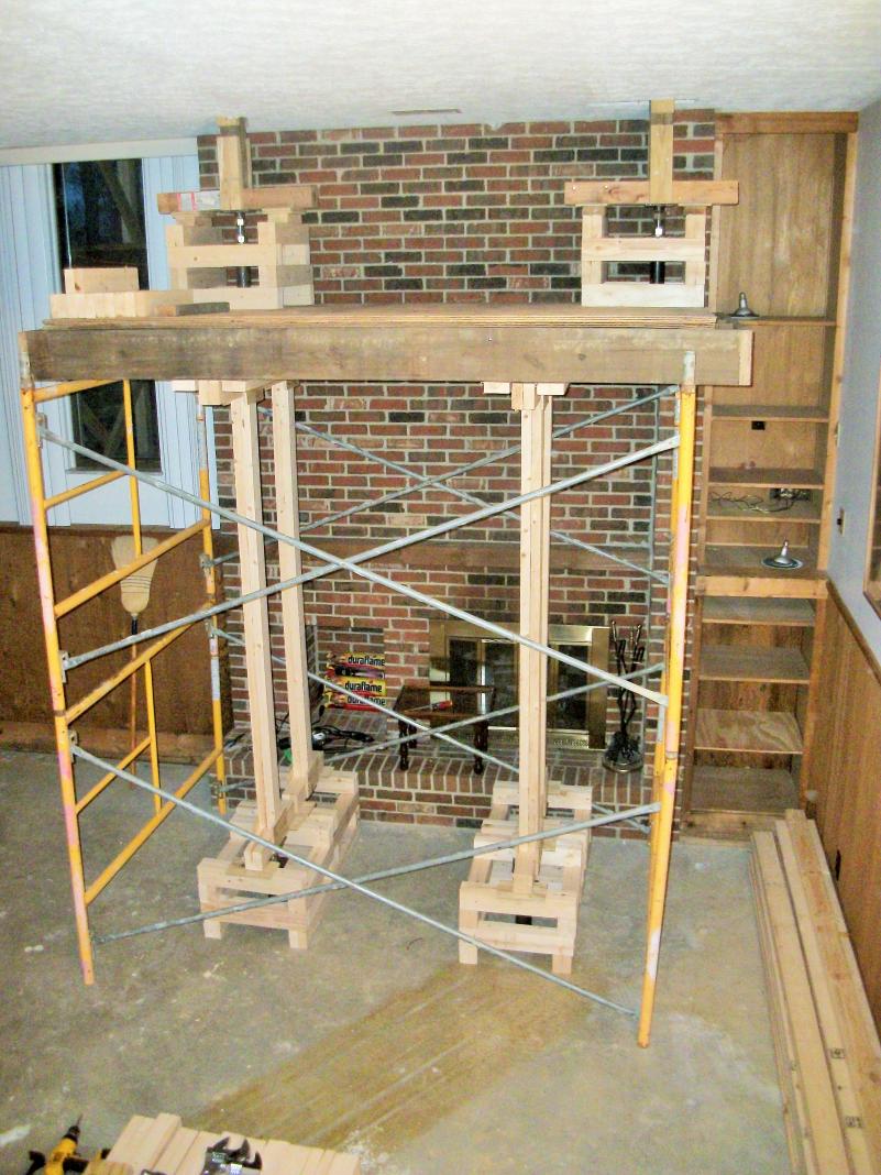

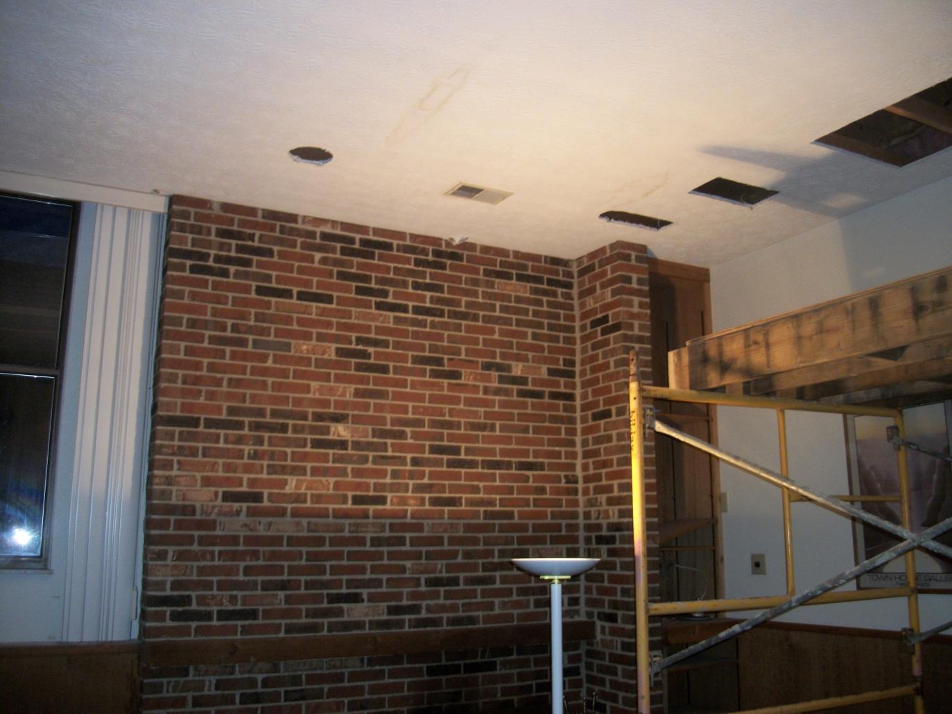

Gettin' closer to putting the screw jacks into service. The platform on top of the scaffolding will be fabricated out of salvaged decking joists.
The ceiling surface is at 11 feet. The second floor joists are at 12.5 feet above the great room floor.

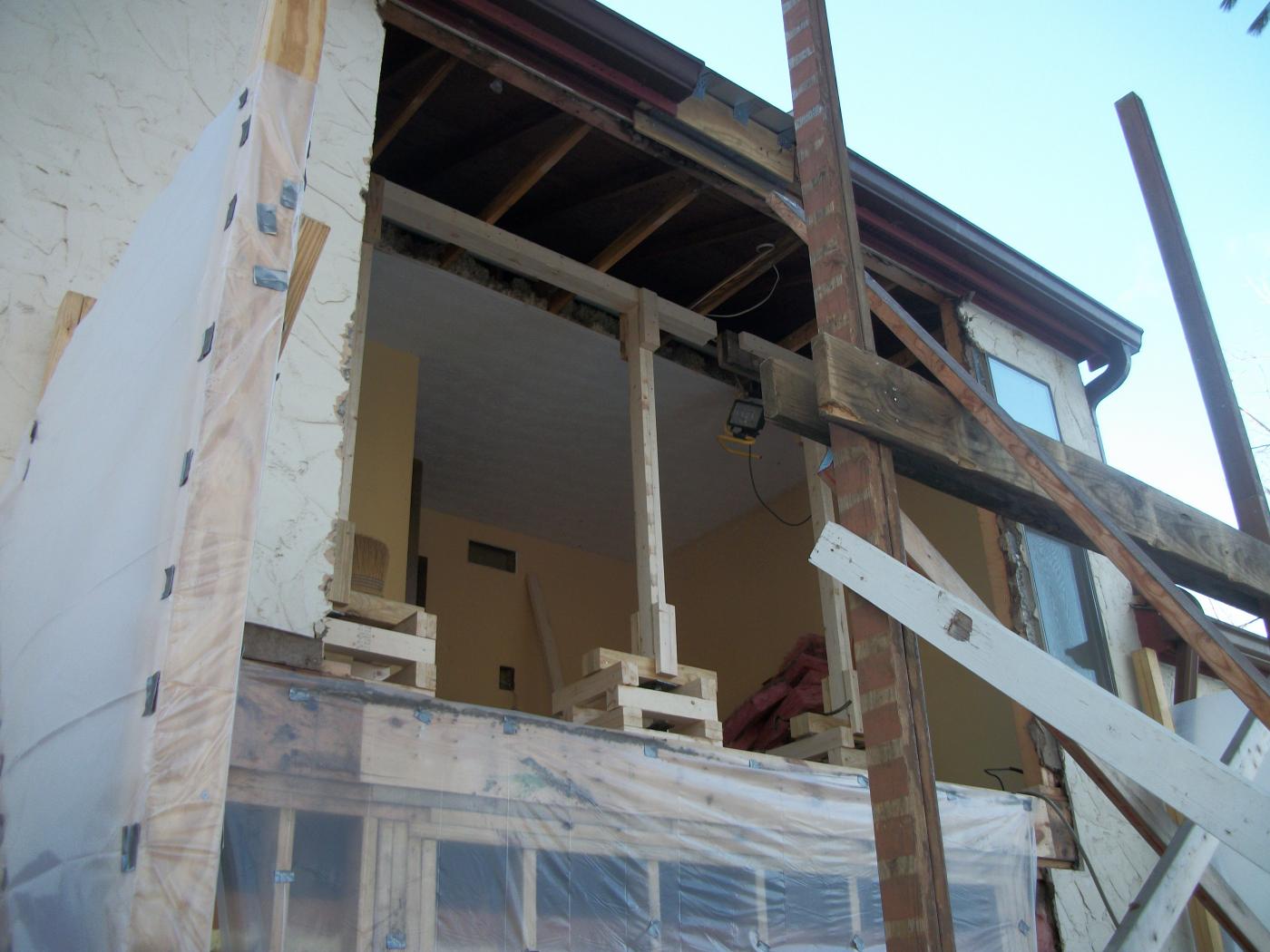

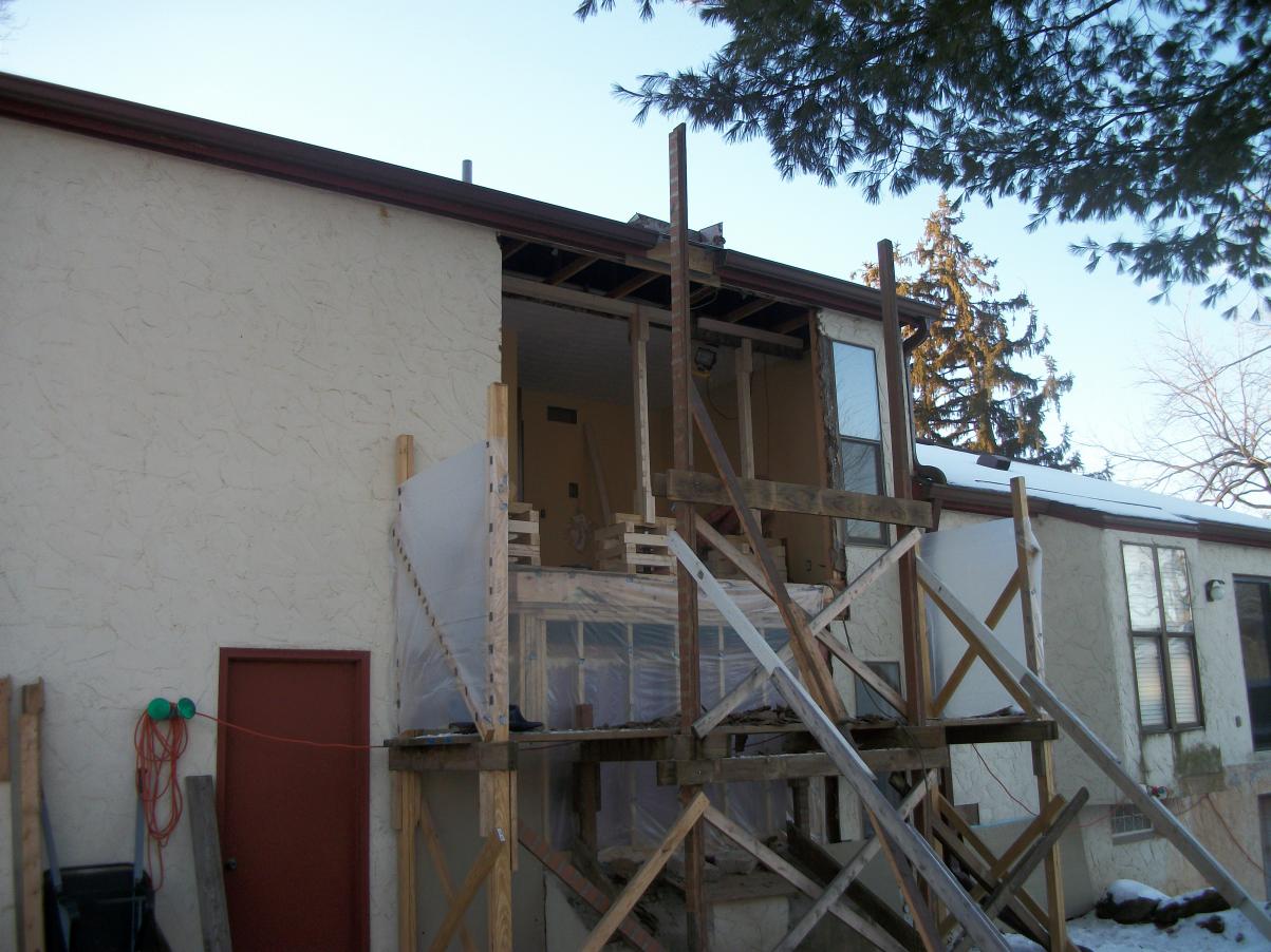

Platform and screw jacks placed into service with the necessary support cribbing.

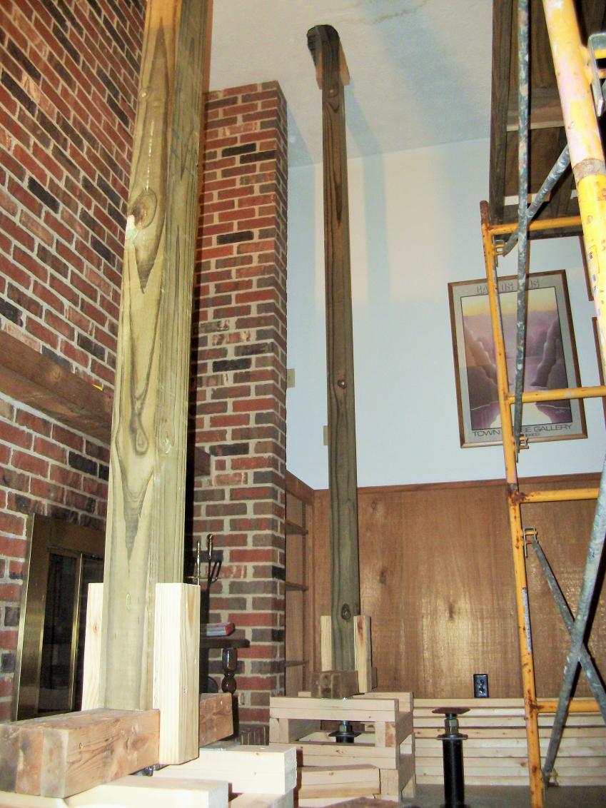

Bad news is the platform and platform-to-second-floor joist support isn't working out as hoped. Will be taking the platform out of the picture and going with straight up 12' posts. The platform will still be utilized for gaining easy access to the ceiling, however.
Attachment 12534
Platform removed and single 4"x6"x12' cut down to 10'6". The re-engineering is far more stable. Tomorrow the screw jacks get employed upstairs to support the roof truss system from the currently-supported second floor.

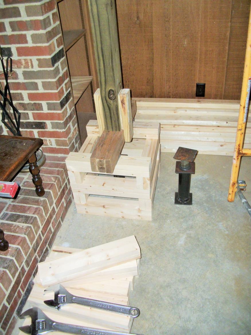

First photo is the cribbing tower (screw jack inside) and the single post setup.
Second photo is just the cribbing tower.

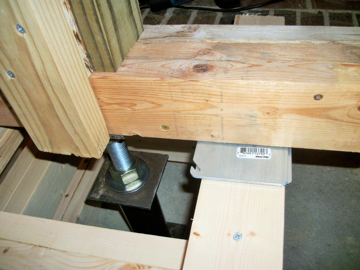

Third photo is showing the use of electrical box covers as shim stock and the extended screw jack performing its intended function.

A house with a *big* hole in the side...

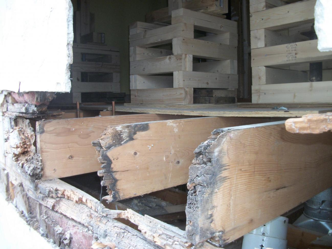

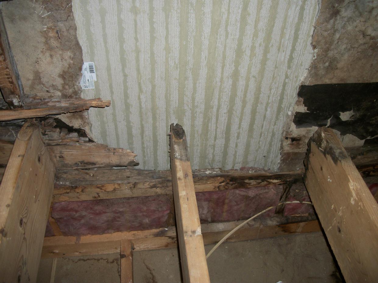

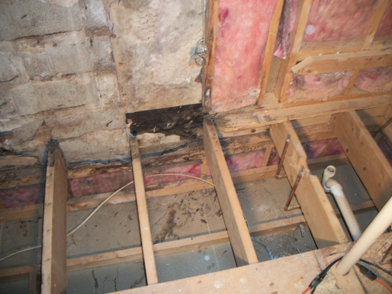

First photo shows the rotten second floor joists. The ends are completely eroded from their supports. In the second photo the bad wood in the floor joists has been removed.
The second photo demonstrates the deployment of the screw jacks in helping the house to stand even though there's currently no load bearing wall available while repairs are made.
You can see the cribbing towers doing their job in the second floor.

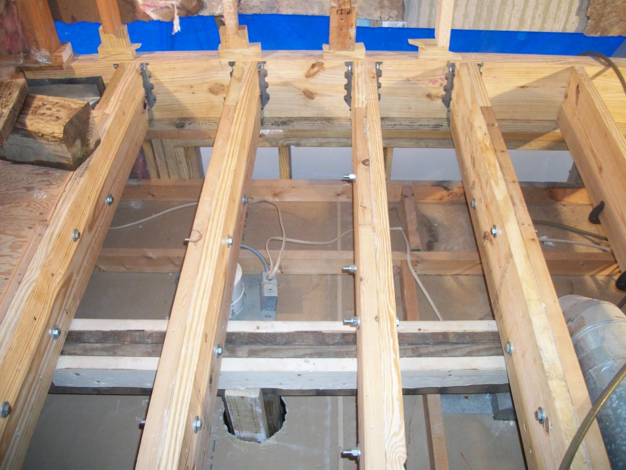

All floor joists now repaired. No more temporary support from the great room below. Building inspector has approved moving on to the next phase which is correcting the water damage rot of the second floor ceiling/roof-truss intersection.
The screw jacks and cribbing towers will be employed on the second floor to "lift" the roof truss system off the exterior load bearing wall to affect the repair.
First photo shows the temporary support posts from the first floor great room missing. The second photo shows the right-most remaining floor joist scabbed and anchored into place with hanger.

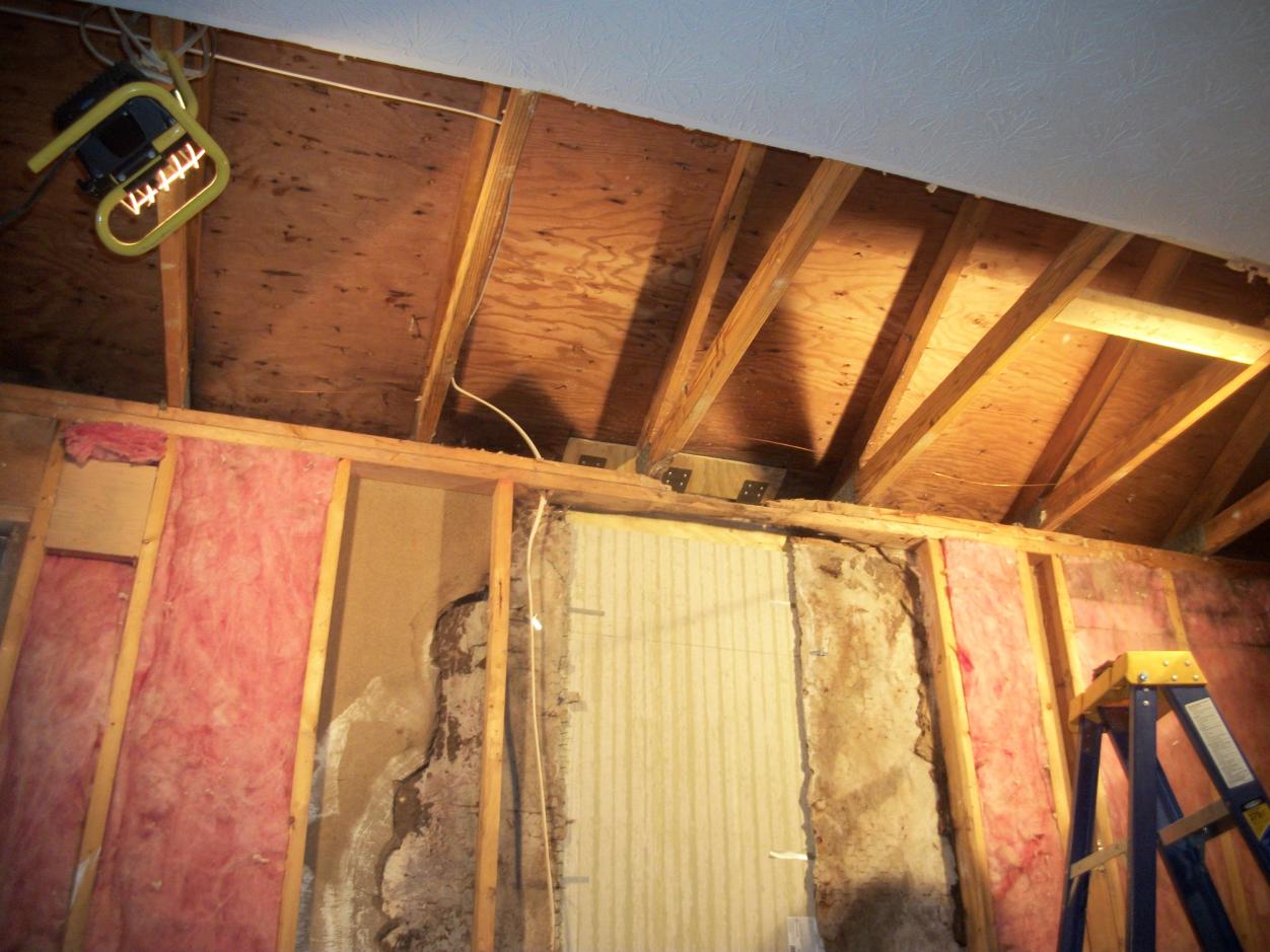

Second floor ceiling taken down to reveal the roof truss system.
The building inspector has stated that if there's *any* compromise of the truss system I'll have to spring for an engineering consult. Don't know how that's going to be less than $500.00.
Anywho, I hope I can convince him some plywood gussets will fix the problem without wasting the money on a "consult". Besides, gussets will be the solution an engineering firm would specifiy.

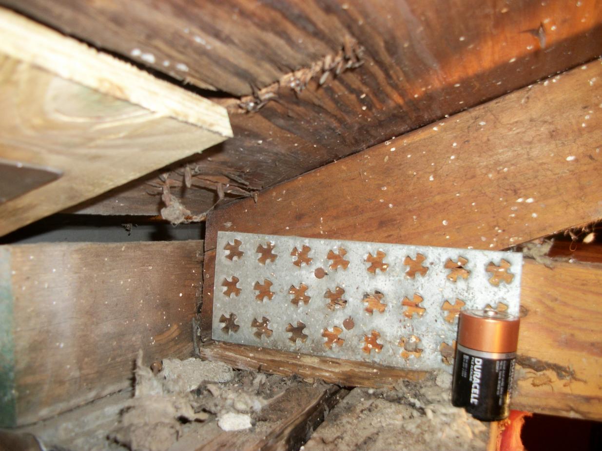

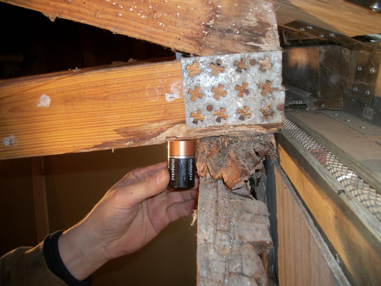

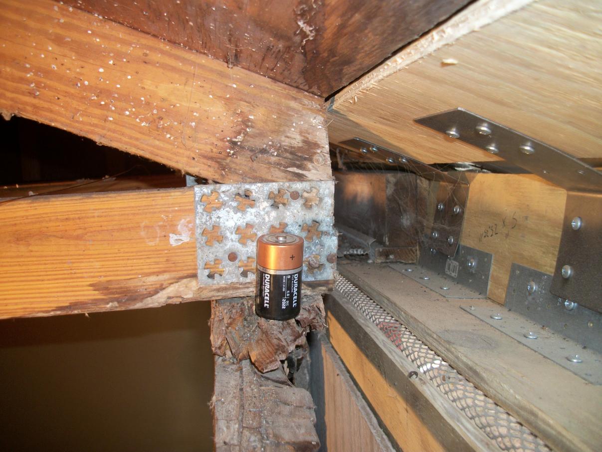

Photo #1. Ceiling dropped revealing the roof truss system.
Photo #2. Water damaged truss plus the original builder modification for chimney installation -- a no-no. "D" cell battery for scale.
Photo #3. What a normal truss looks like.
Photo #4. Another view of the bad truss. The fresh wood and metal to the right is the "quickie" roof fix for when I took down the chimney.

Second floor external stucco wall removed.
That's one big hole in the side of the house...
Attachment 12846Attachment 12847Attachment 12848

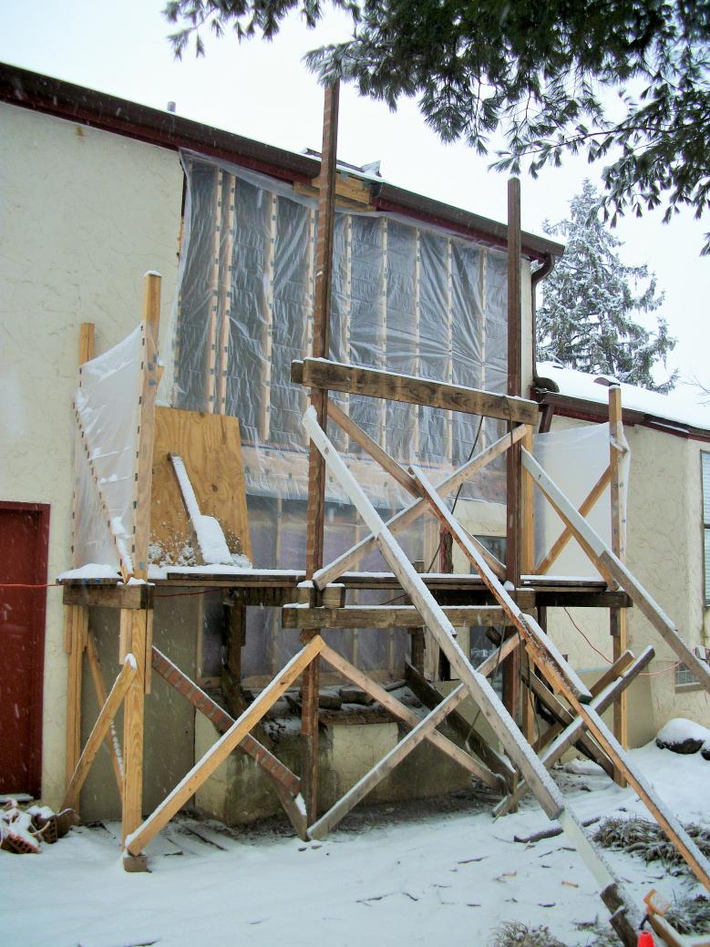

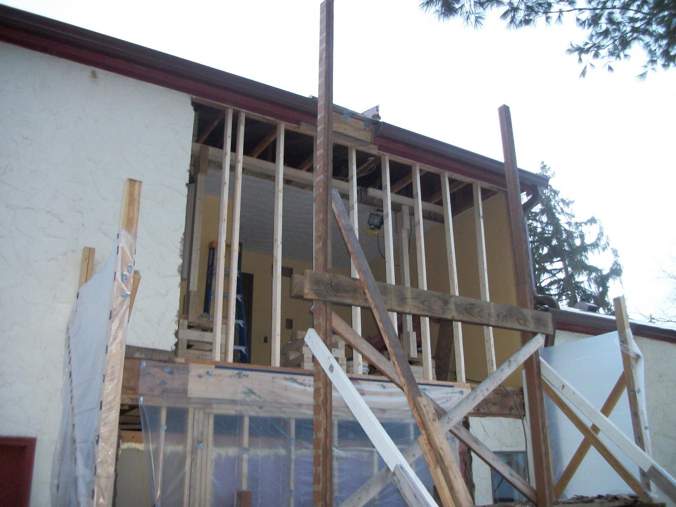

Original window on the right removed. The wall cap plate has been repaired and wall studs installed. The studs on the right are just temporary for the "weather proofing" Visqueen. Once the current storm moves through I'll frame for a new larger window in its near original location.
Another week or so and the screw jacks welded up last summer will have completed their work!
Photo #1. Original window removed on the right and wall studs installed.
Photo #2. Old water damaged wall top plate replaced.
Photo #3. The butt joints for the top plate were planned to have their seems above a wall stud. The joints are staggered across the whole wall.
Photo #4. Visqueen applied to keep the weather out during today's (02/01/2015) Midwest winter storm.

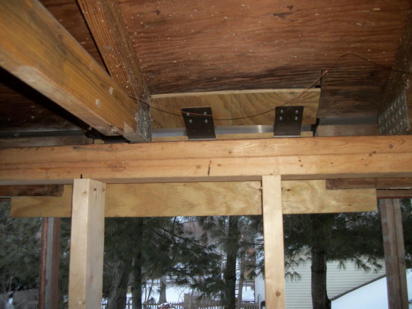

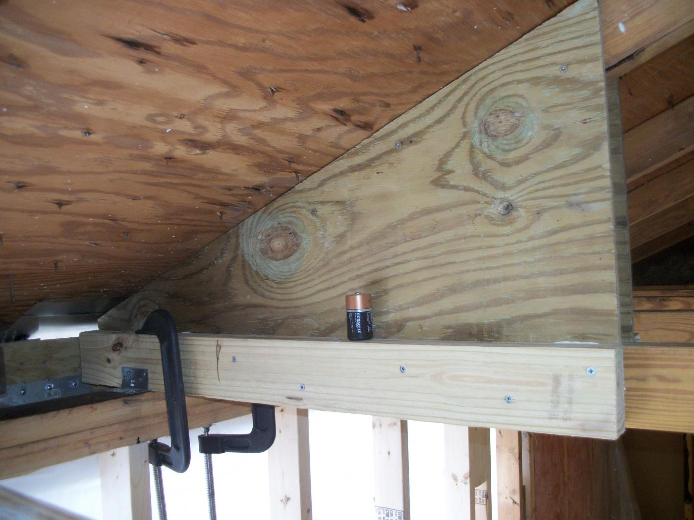

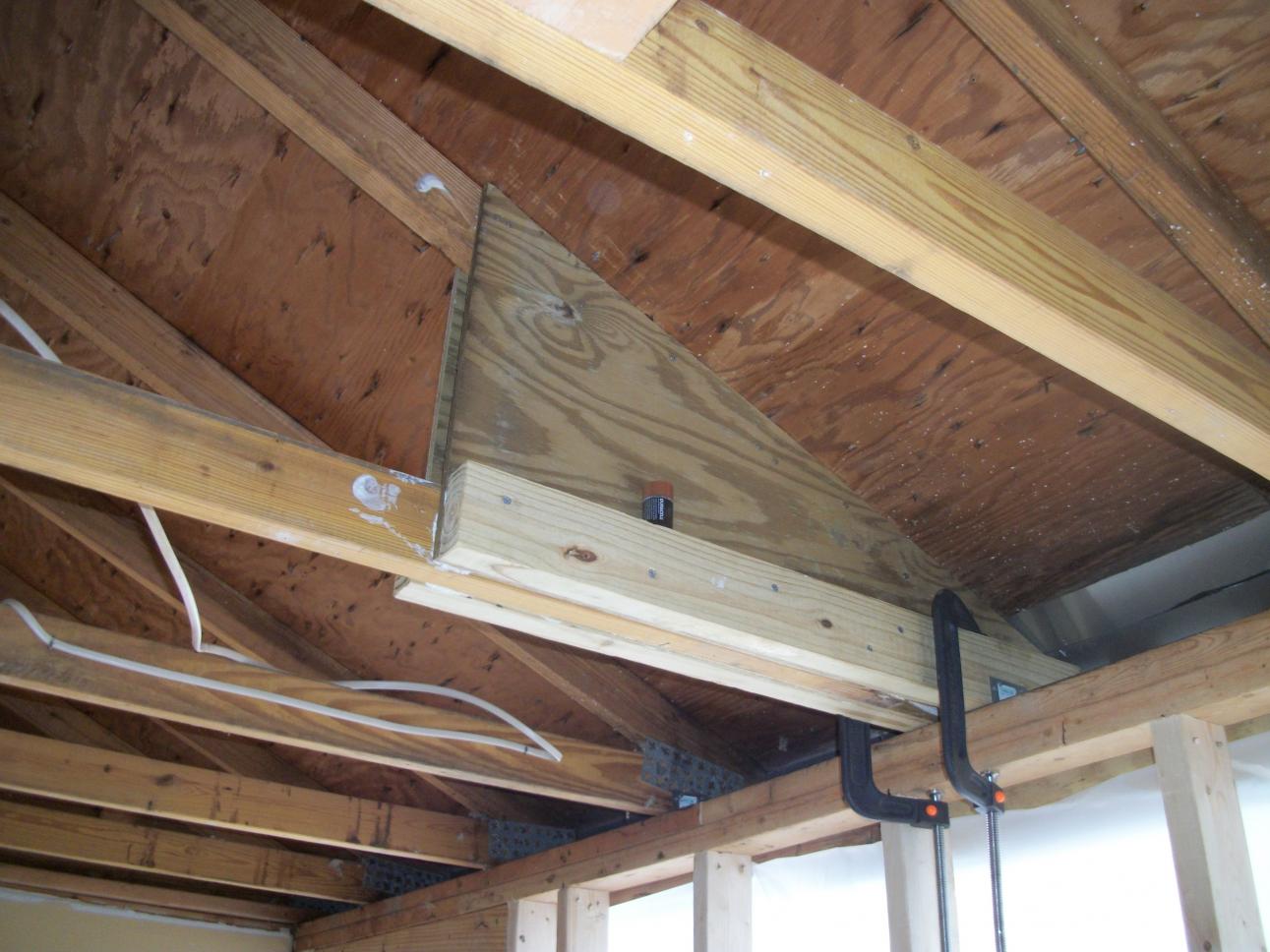

Today I repaired the faulty roof truss. Since this was the last repair to utilize one of the fabricated screw jacks I'll put an end to the thread.
My plans are to hold on to five of the screw jacks for possible future use and put the others along with the beams, posts, and cribbing up on Craigslist. I'd like to recoup my materials costs.

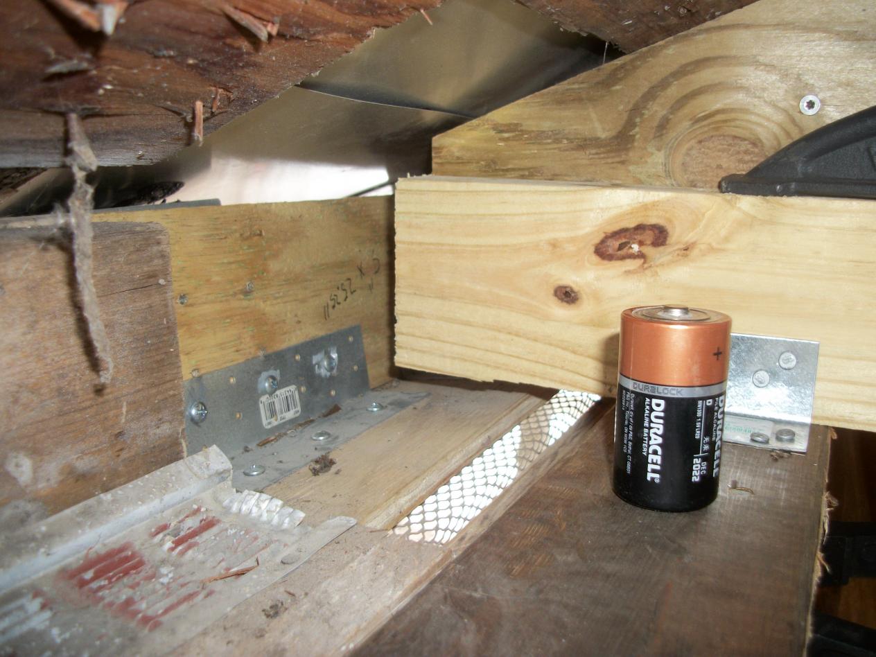

Photo #1. The "D" cell battery is for scale. Plywood gussets (each side) and 2x4 bearing surface installed. After jacking and repair the truss was sitting about 1/8" proud of the wall top plate. The C clamps will be in place for a number of weeks helping everything to migrate where it needs to be.
Photo #2. The fascia end of the repair.
Photo #3. How it looks from floor level on the other side.

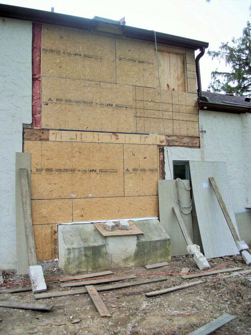

Window installed and tar paper put up just like roofing shingles to keep the weather off the OSB. Eventually, I'll get around to removing all the stucco and replacing with concrete fiber clapboards. So, for all intents and purposes, the structural work is complete.
The white squares are sections of Vinyl flashing used with stapes like button nails.
The edge seams of the stucco/tar paper are covered with concrete fiber board sections. Concrete fiber board is also used near the ground to keep mud and silt from splashing up on the tar paper preventing premature wear.

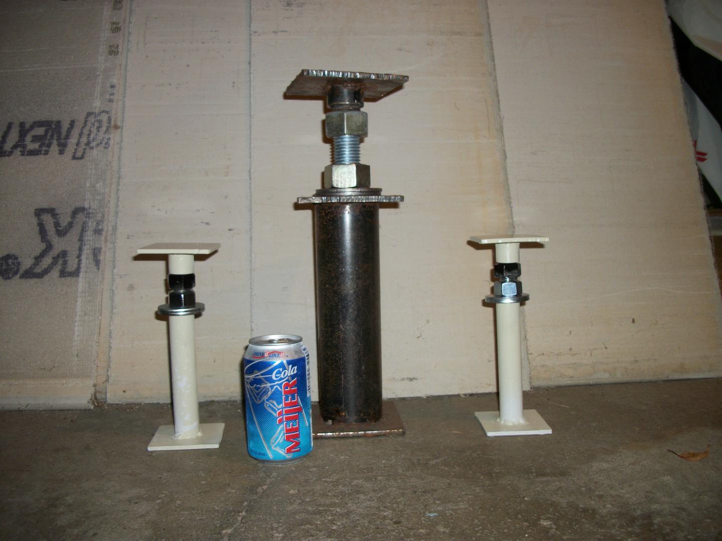

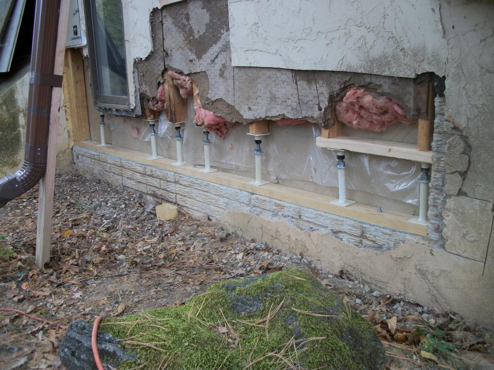

Mini screw jacks of the same design. However, rather than utilizing 3" schedule 40 steel pipe and 1-1/4" threaded rod, the dimensions are 3/4" threaded rod and 3/4" black iron pipe.
I have a wall section which has been settling and in need of motivating back into place.
The jacks will be utilized in an exterior location so painting was necessary.
Attachment 13501Attachment 13502
Mini screw jacks deployed.
Indications of interior settling/sagging have already improved.
