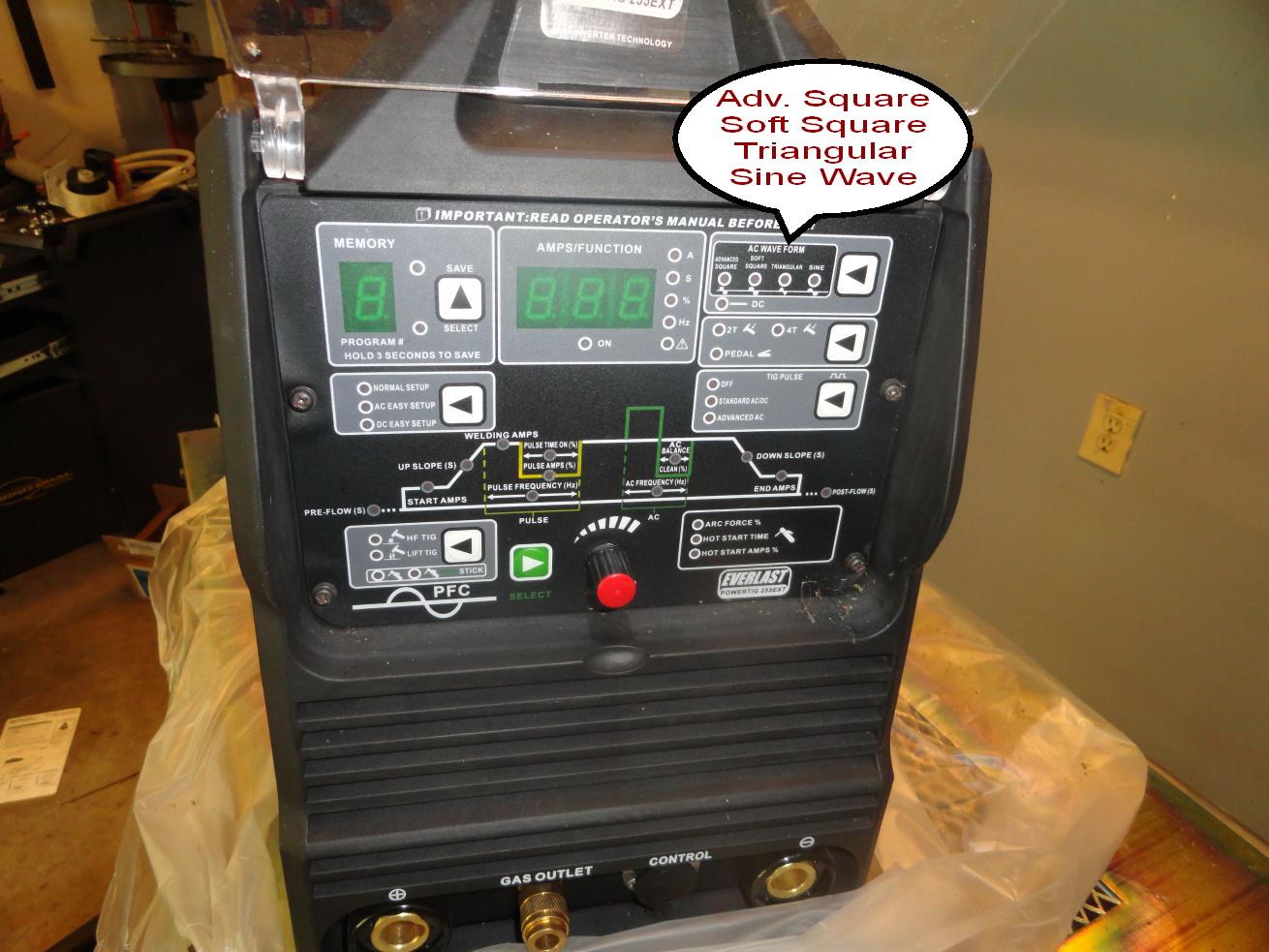

The PowerTig 255EXT has all the same wave forms to the Miller 280. also see Pics.
Attachment 10933
Attachment 10934
http://www.everlastgenerators.com/do...TIG-255ext.pdf
Looks like the mythological Dynasty 280 is ALIVE!!bawahahaha. It lives!!:O
