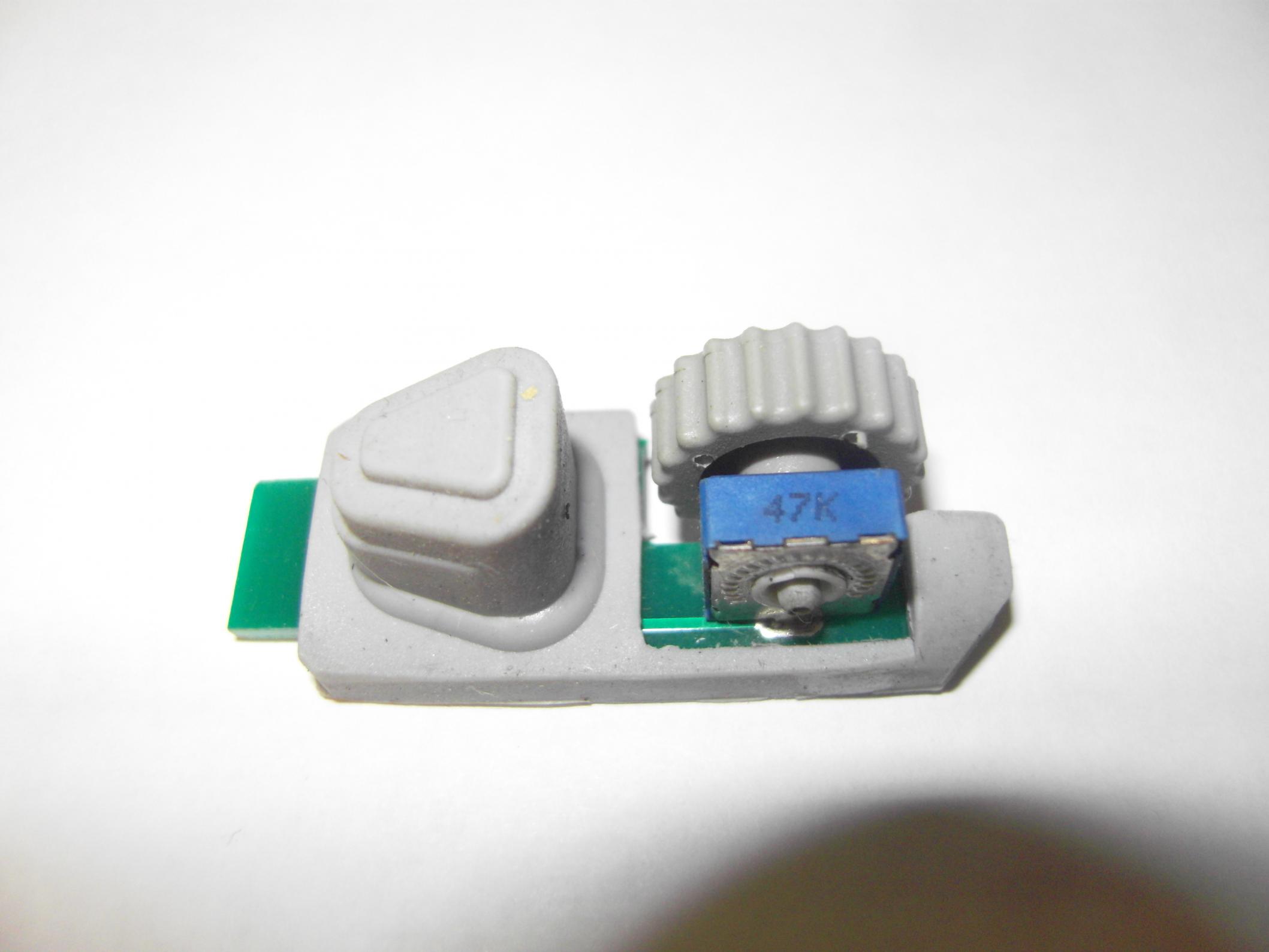

The Everlast Amptrol as Rambozo said it is designed for 4T not T2. The CK is for 2T it works like a foot pedal on the torch head it has a switch that turns the machine amps on and then goes to the pot at the same time like the foot pedal should. I think the 255EXT and the 210EXT will work with different K pots 10K or 47K (potentiometer) I also think the electronics in the EXT's will excepted most Pot's.
I have a CK 25K off my old Hobart I will try it to see if it works on my 250EX and 255EXT.
Attachment 11689
Everlast Amptrol unit out of the handle

I called and spoke with CK's tech support today. I was told that the current finger remotes will work with the Everlast EXT line, but they could not guarantee it to work with anything else in the Everlast line. I was also told they were "working" on a solution and have been for a couple of months, no time frame on when it would be done.
The 185 uses a 47k pot, so looks like it might be a make it yourself solution. I would like one that is shaped like a trigger on a pistol with a guard. Bet that would be easy to manipulate. Lots of ideas, but how to put them into actual use is the issue. Need some type of switch that will "turn on" the unit and gas valve at first movement and then leave it on for the full rotation of the pot, then as the pot is turned back to the minimum the switch is "turned off".

Pulled off the cover and just checked out the guts of the foot pedal. By the numbers on the back of the pot, it's a 50k ohm one. Here are some pics
Attachment 11690Attachment 11691
If you can't read the back of the pot, here is what it says
RV24YN20S
B503 (this is the code that means 50k ohms)
www.hungyun.com
Glenn
47-50 ohms makes no difference on our units. 22-25 k make no difference either. It's within the tolerance limits.

So if I'm reading you correctly, the new 185 can use a 25k ohm pot and it should work correctly?
CK makes a fingertip control for Hobart that is 25k ohms.
