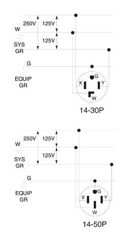

4 plugs? It might be a nema 14-50p. Does it look like this?
Attachment 9348
If it does you are in luck cus that's a dual voltage plug. You can run 240v and 120v with that cord. Great for having a grinder or saw handy where your welding.

The 240v is gotten from the red and black cables. They are both 120v with 180 degree phase shift. Neutral is not used on 240v and ground is for safety. The 120v should be taken from the red and white (neutral) wires. I say red cus it's convention to keep the same phase as the rest of the 120v in your house and that's usually the red wire. So a 20amp breaker should be put on the red wire going to the 120v receptacle. This means you should have 3 boxes. One for 240v, another for the inline fuse/breaker and one for the 120v. And since you'll be using the welder in a designated "damp" space (garage or outside) you'll need a gcfi for the 120v and the 240v Should have weather sealing. Here's a diagram that may help.
Attachment 9349
Just to make sure you know, it's not good practice to ground the neutral as a shortcut. If there was a case of a hot short the neutral would be live and so would any ground that on your equipment. Ouch! Hope this helps. :)
