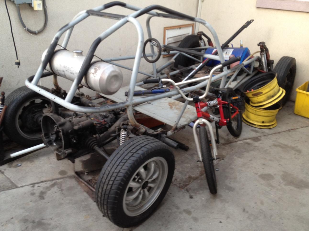

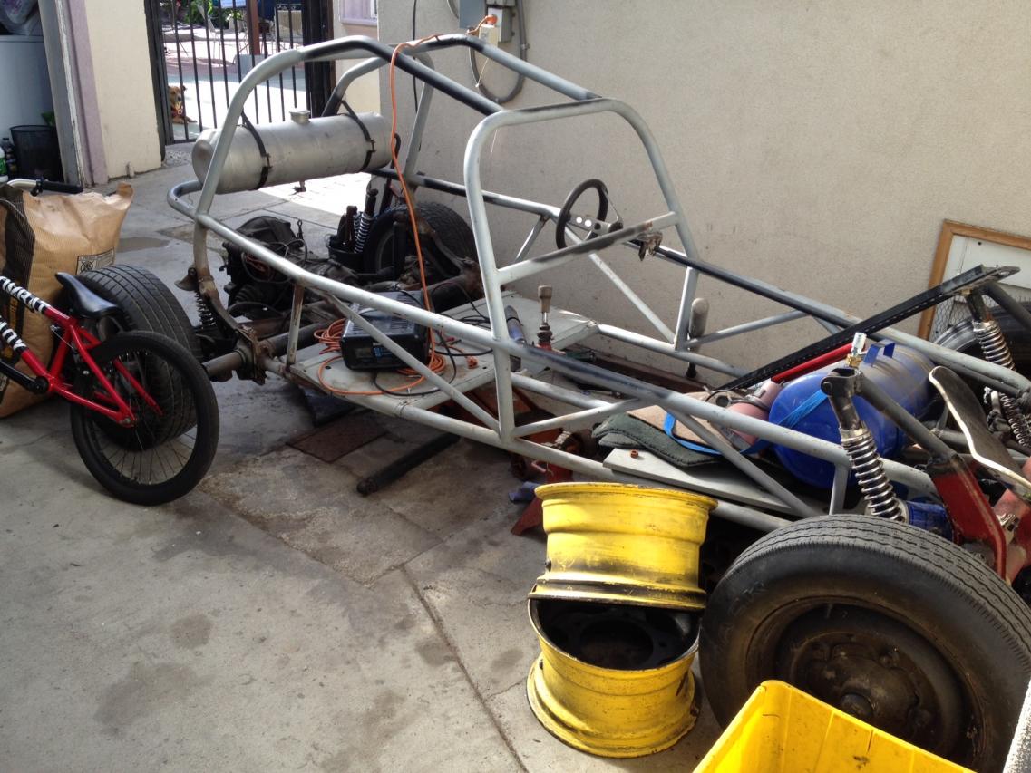

I picked up a sandrail frame for a project and am going to be building it up over the next few months/years. I figured I would start this thread now and use it as a complete build thread as I make progress. This is what I'm starting with:
Attachment 9227
Attachment 9228
Attachment 9229

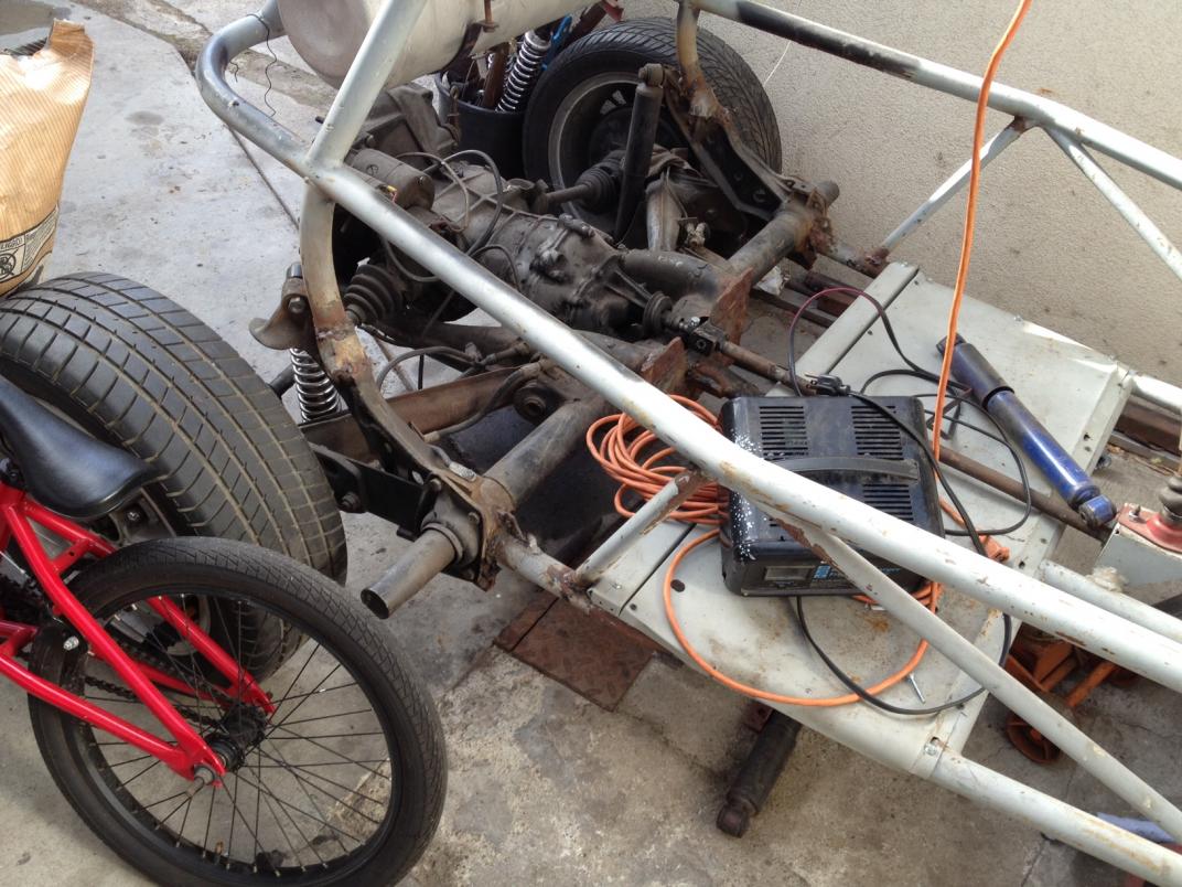

The front beam and complete rear end are going away. I picked up a set of A-arms for the front, and 5x5 trailing arms for the back that I need to modify to fit the micro-stub 930 cv's that I want to run. I also picked up a complete 1995 300zx motor for the back of it. Came with all sensors, wiring and ECU, so it should be relatively easy to get it to run. It will need an exhaust fabricated up though, because the headers point the wrong way right now.

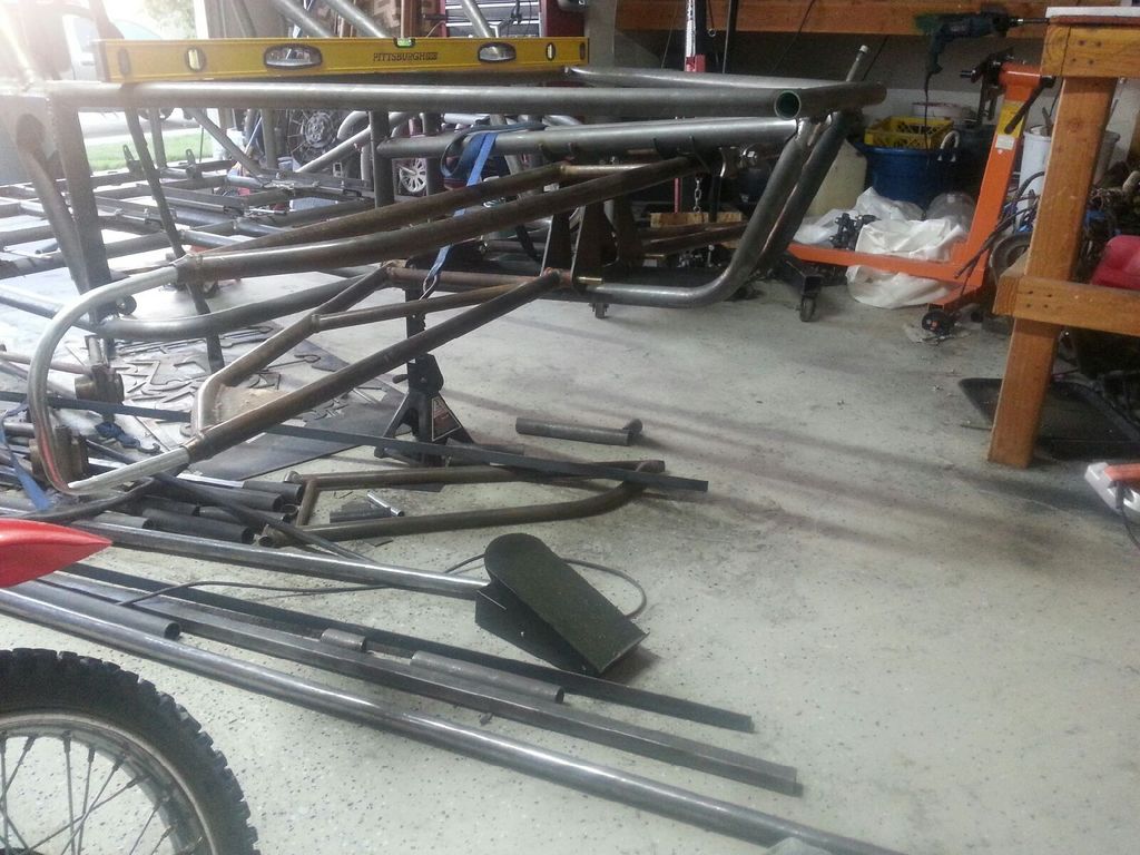

The next part of the project was going to be building up a frame jig out of 2x2 steel tube. Just so happens the guy I bought the A-arm from has one made for his rail and he is letting me borrow it. Its a pretty nice 4x10 foot table, all 2x2 inch square tube with leveling feet and castors built in. Will save me at least a couple hundred on tubing and a bunch of time not worrying about making a straight table. I should be able to start cutting and welding in the new frame next week.
EDIT* Also, if anyone needs one, I have a pretty stock 1600 dual port that I'll be selling with the entire IRS and trans in the pic. Let me know and we can make a deal.
