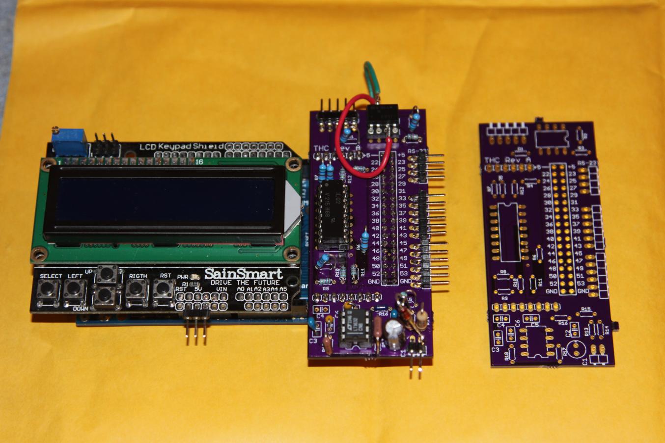

I got the boards back for OSHPark.com in less than three weeks. They look really good and I couldn't help myself and had to immediately build one. The assembled Arduino w/ display and THC shield on the left is a reasonable size.
Attachment 9052
As you can see from the picture, I did find an error that I had to run some wires for. It's for the serial port. With the wires the transmit from the Arduino works, but the receive doesn't. I had trouble with the receive wire and think I burnt out the chip. On the transmit side, the max speed of the serial port on the bench (not the noisy environment of the plasma table) is 38400. Going faster would require changing that opto isolator.
I checked out the control button wiring and that all works well.
I checked out the op-amp filter with steady voltages (I skipped the voltage divider so I could test with 3.3v and 5v) and that worked okay.
I also checked the Arc Good, Torch Up and Torch Down outputs to the CNC that are opto isolated and they all worked.
I still need to test the Torch On input from the CNC and the plasma signals for Torch On ouput/Arc Good input.
Once those last three signals have been tested, I'll be ready to start testing it on the table.

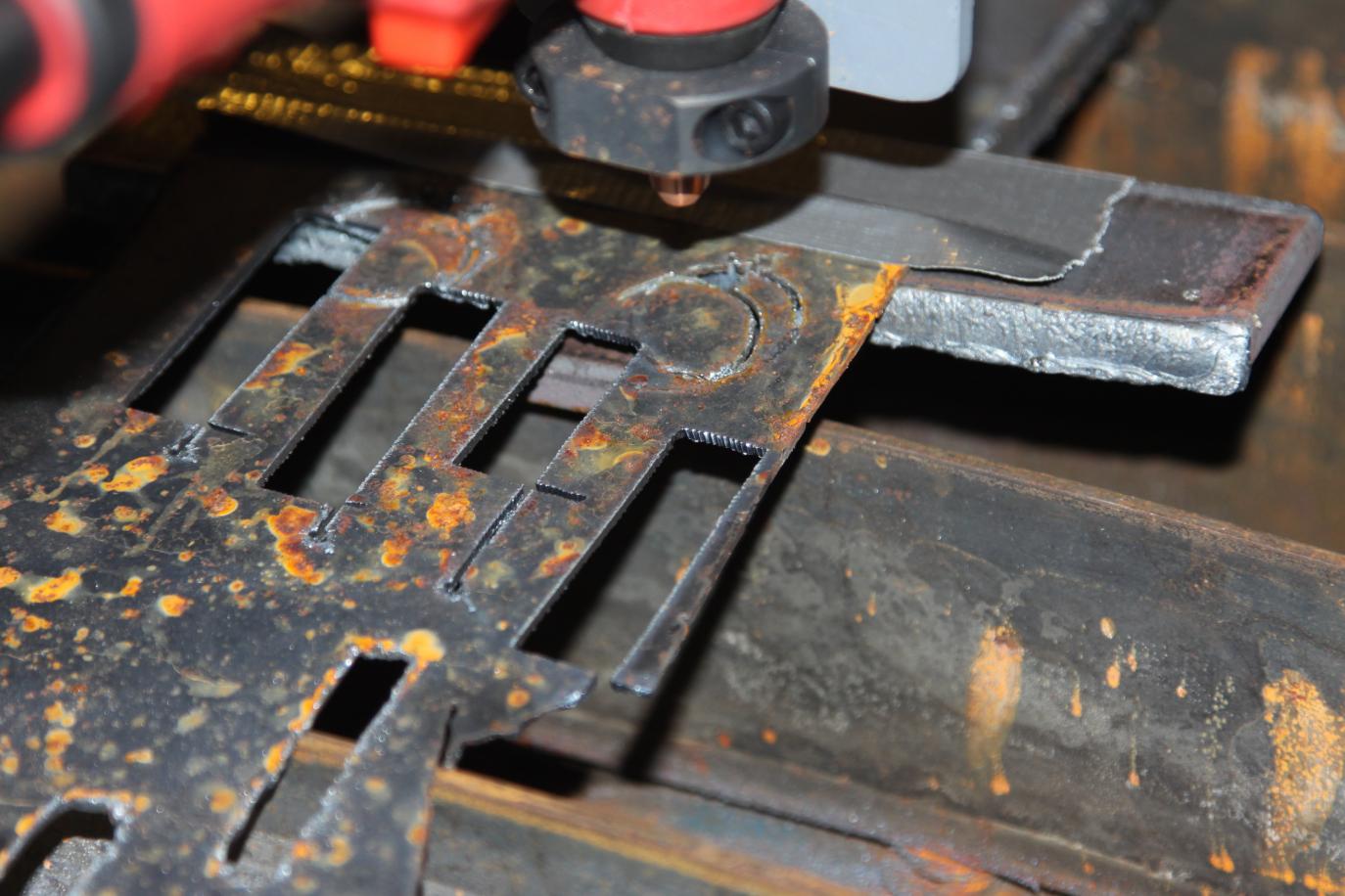

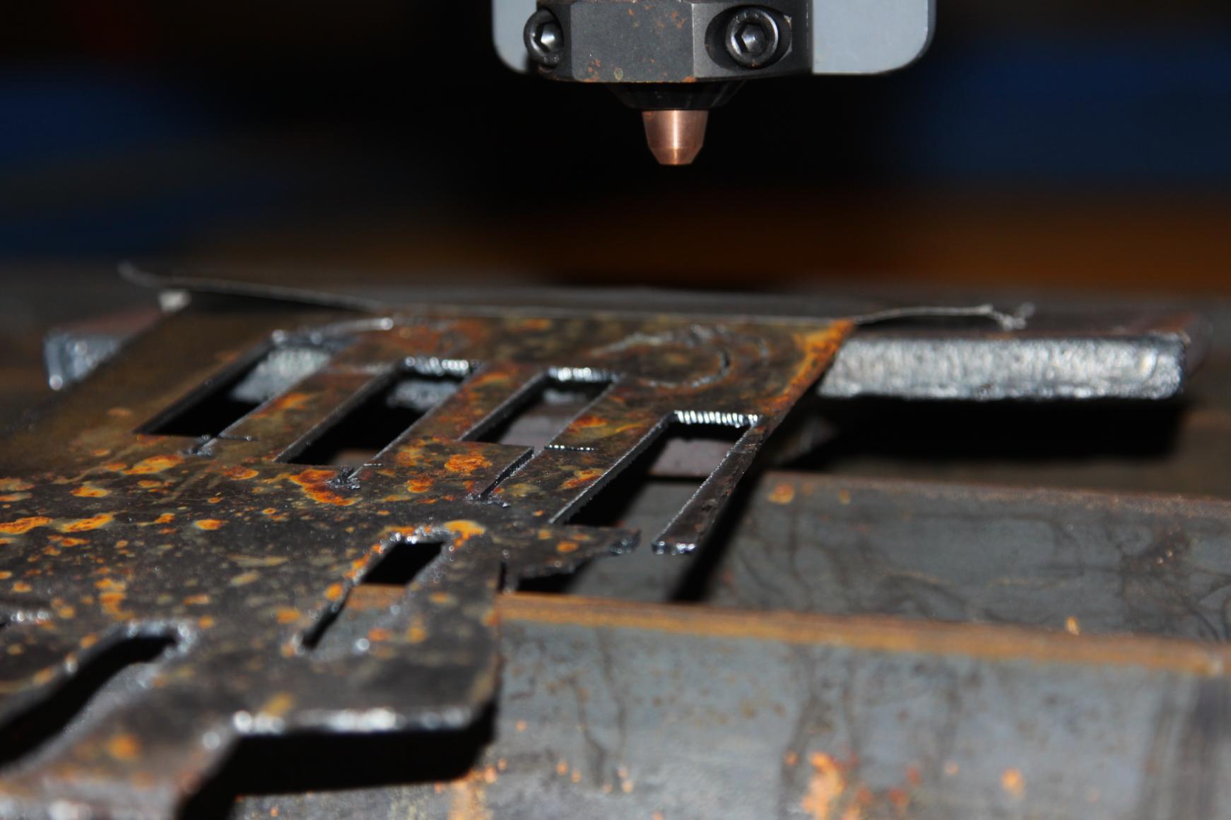

I tried some test cuts with THC control.
I started using a SheetCam post processor that would turn the THC off at corners when it slowed down. Then after the corner, it should turn it back on. For some reason, it turned if off and it never came back on.
I disabled the THC on/off in the G-code and did some cuts. It was "sawing" up and down a little too much during flat cuts. I ended up changing my control loop to tighter values to improve the sawing. I also increased the THC speed in Mach from 20 to 40, but I'm not sure if that was the right thing to do or made a difference.
After tightening the control loop to within 5 a/d counts (5/7 volt) it still "sawed" a little, but looked okay. (I think I need a better filter for tighter control.)
So, I inclined some sheet to see what would happen. I still have the problem that Mach won't allow the torch to go lower than the initial Z home value. So, I had to make sure the cut started at the lowest point. I was cutting 2" x 0.5" rectangles.
You can see the incline in the pictures. It is about a 3/4" elevation over 4.5". The right-most cut was the last one I did. On the very top of the cut you can see the rough edge from the torch going up and down.
Attachment 9221Attachment 9220Attachment 9219

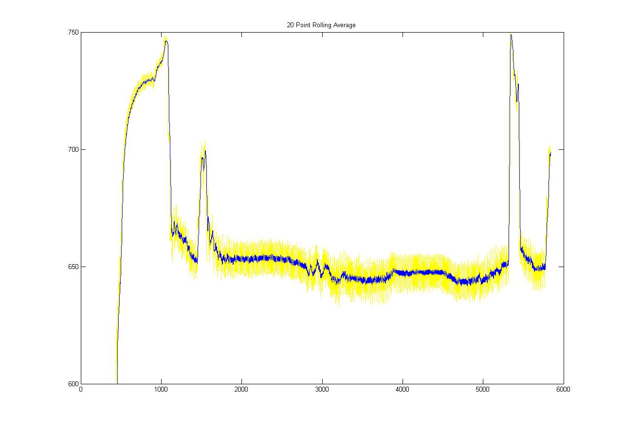

So after looking at your equation, I think you're going to have a harder time correcting for "being low" than you think. Its low because it started at zero, and if you only had 1/20 the value of the next point, it will take a long time to pull the value to the "true" value. However, if you started with a high count value, you would be biased high and would be trying to pull to a lower count value. The problem is, without more code, you won't know if you started high or started low and which way to offset to correct.
I would use either of the following options instead. I didn't bother doing the FFT, because after fooling around a little bit, I think you're right that most of your noise is ~60Hz. The first option is to switch from using your equation to a rolling average equation. The first plot shows a 20 point rolling average, the second plot shows a 50 point rolling average. Assuming a sample rate of 1000 Hz(1 milisecond), this will give you .02 or .05 seconds of lag. If you're cutting at 20fpm (4 inches/sec), that gives you a 0.2 inch lag. I don't think any material will change a huge amount of height in 0.2 inches.
Formula:
value = average(value(i-19):value(i)) - for 20 point
value = average(value(i-49):value(i)) - for 50 point
Attachment 9232
Attachment 9233
I think a better option would be to just create an analog low pass filter with an RC circuit. I used a 2 pole Butterworth digital filter to create the following two plots. The first one has a cutoff frequency of 35 HZ, the 2nd one has a cutoff freq of 80 Hz. You can see how much noise is left in the 80 Hz plot. Any low-pass analog filter with a cutoff below ~30 Hz should completely remove the 60 Hz noise without it falling in the transition band. Here is a link on how to come up with the RC values of various order butterworths. http://www.electronics-tutorials.ws/.../filter_8.html
I tried higher order, but the higher the order, the higher the phase shift of the data and the more laggy it will become. Using the analog filter will also allow you to remove the lines of code from the control software and free up some processor power for other things.
Attachment 9234
Attachment 9235
As a final note, you may have better luck going to an open loop control mode. Instead of trying to control between 0.5 and 1 volt, you may want to try setting an upper and lower bound, and when you hit the bound, just move it ~.010 inches to correct. This will also free up processor power and give you a more stable sample rate, as it doesn't have to monitor voltage constantly, but just check it every 0.05 seconds or so.

I had expected the op-amp butterworth filter to take care of everything, but it had a 100 hz cutoff (based on a recommendation from a "consultant"). After looking at some of the 2 pole butterworth filters I found a calculator that said for a 35 hz cutoff to use a 470 ohm and 10 uF. I can solder those on the existing board and just tie them into another analog input. So, I'll give that a try this weekend.
I had done some averaging over different ranges from 10 to 50 or 60. The problem with the rolling average is that to get a cleaner signal you ended up adding too much delay for high speed cutting.

I took Agent4573's advice and put in a 2 pole filter. I used a calculator I found on the web and it said for a 35Hz filter to use a 470 ohm resistor and 10 uF capacitor.
I put those on and did a couple cuts with data captures. They were worse then the previous cuts. I realized the only other difference on that run was I had my o-scope on the circuit both before and after the new filter. I tried another capture without the o-scope and it was really good. I guess the o-scope leads were just "noise antennas".
A blow-up of the raw analog to digital readings (no software filter) is below.
Attachment 9246
You can see that the signal is now typically +/- 1 count from the baseline. Couldn't ask for anything better.
A full trace of cutting a 1/2" x 2" rectangle is below:
Attachment 9247
I did look at the timing. I'm currently dumping data every time through the control loop. I have a delay so that it won't run more than every millisecond. The software currently waits 1200 ms from an "Arc Good" signal until it starts voltage control. In the capture it showed 1142 ms. between "arc good" and start of control. So, it's off by about 5%. I'm guessing that dumping all the data could have something to do with that, though, the display updates could also have something to do with that.
