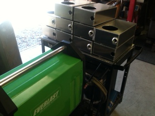

Attachment 8305these are some of the tanks i welded this week

these are the tanks i did recently and used a #4 cup to weld with and etching is almost completly goneAttachment 8564Attachment 8565Attachment 8566
Welds look great Nice work. Glad all the bugs seem to be gone.
