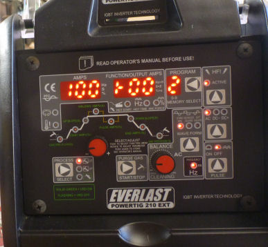

Just tried my new 210ext was working good (I think) now it's doing this

Your settings would help?
100A 0 balance
Attachment 8174
Do you have a clean ground directly to the piece you're welding ?
There are a lot more settings than that. One drawback to a multi-function digital display is one pic will not show all the settings. Sine-wave is a lot less tolerant than square for dirty material in general. TIG is a lot different than stick and MIG, if you won't eat off it, it ain't clean enough for TIG. Make everything bright and shiny, and wipe it down with a solvent like acetone. Use a stainless brush dedicated to aluminum and carbide burrs instead of grinding discs.

You have way too far of a standoff...and the metal you have, should be discarded. You cannot get a good weld on that metal....and your balance should be more toward -25-30. And put it in advanced square wave. Why on earth would you want it "balanced" at 50% positive, and 50% negative? What is your AC frequency? What sort of tungsten are you using.
Aluminum actually welds better once it's warmed up, but you can get it too hot when the whole piece gets to the point where it distorts and starts sagging and such. BTW not all aluminum is weldable, some alloys can't be welded by standard TIG process, for example 7075. You have so many things wrong that it's no wonder you are having trouble. There are some good videos explaining a lot of TIG settings on www.weldingtipsandtricks.com. You might have a look and do some practice on clean material of known alloy to better learn what each things does.

Also, by not cleaning the spot where you are grounding to (which you said has adhesive on it) you already likely caused some pitting/damage to your ground clamp surface where it contacted the dirty surface. Inconsistent arc starting could be caused by a combination of this, and too much arc length. I'll bet you have a nice burnt carbon build up on your ground clamp, which is contributing to your inconsistent arcs. You should clean this back to shiny, conductive metal before trying again.
And like others have said, study what are good settings to use, (at minimum good "general purpose settings"), and apply them. And, do some studying on welding technique. There is so much good information on weldingtipsandtricks.com, as just one source. It is so much easier to learn now, than ever before.

The only problem there is technique, and once again, and the settings. What is part of the problem is that you have "ground" the glue into the metal. It may look clean, but not under a microscope. No software problem there or reported on those units. If it was, it would not suddenly start working. Not sure who told you not to use it. Again, turn up the frequency and use a clean, fresh piece of metal. Also set your background menu AC arc transfer amps to about 20-25 unless you need to weld thin metal. You can ( and from the look and sound of it) get the settings so far out of synch with each other that the unit will be difficult to start an arc...ie too low of frequency on AC..too much AC+ etc. The problem with extreme adjustability is that it takes considerable knowledge in how to set it up right and make it work for you (or against you).

I just installed the new circuit board two days ago and my 210 ext is working just fine now. It was some time before I narrowed down the cause to be machine rather than setting. I only noticed the issue on AC when welding AL. It shut down after crackling and popping. It is working fine at this time. Now to get some good information about smaller compatible torches. Apparently tec support is constrained on what they can say about 9 or 17 torches that work. The dinse connector is the issue I have had with two separate torches I have ordered from Everlast.
