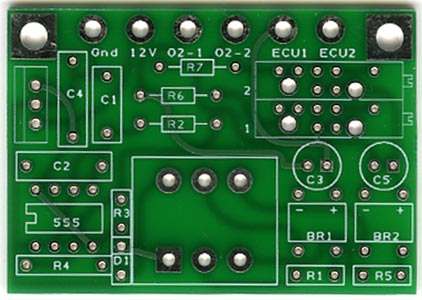

Was it this board:
Attachment 7712
Here is a link for the EFIE schematics http://www.alt-nrg.org/efie.html
