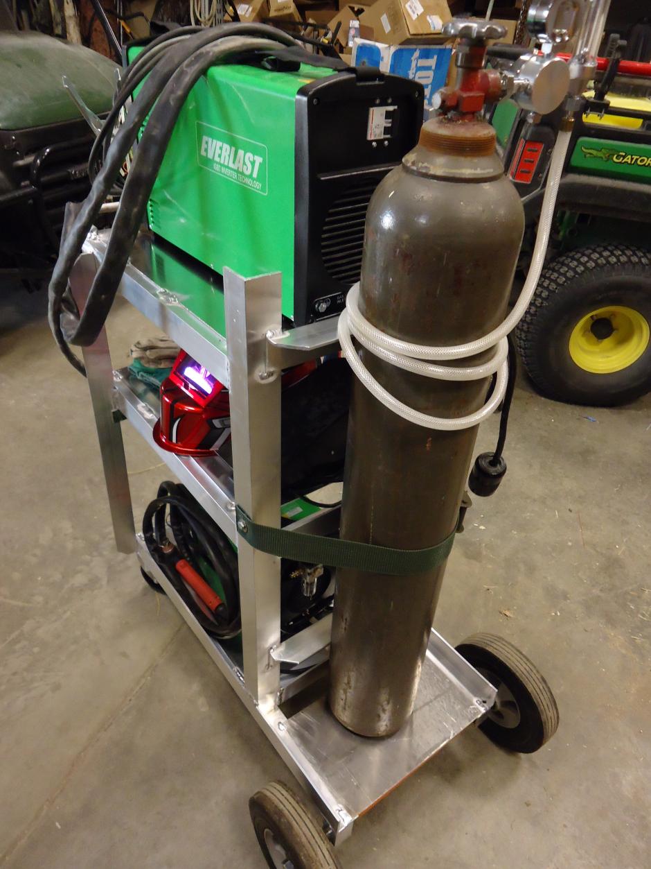

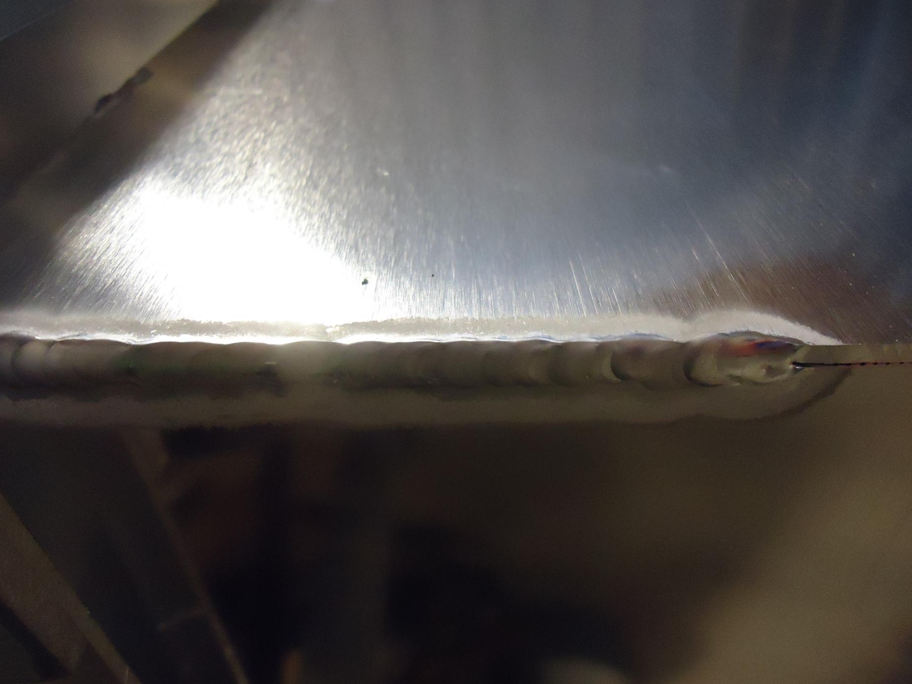

Here are a couple of pics of the new cart i am building, I used 2x2x.200 Aluminum angle for the frame and .100 aluminum sheet for the shelves.All the angle and sheet was cut in the wood shop on a 16" radial saw or 12" mitre saw,sheet was cut on a 10" table saw with 80 tpi blade. I made the tank brackets out of angle also and cut a half moon shape in them to hold the bottle. Used a new military strap with a spring loaded latch to hold the bottle.The tires i have had for years and figured i would use them someday.I used a piece of pipe for the axle and inserted a 5/8" bolt in each end and welded it to the axle to serve as a spindle, a locknut was used to hold the wheel on the spindle.Had to go to HF and get 2 casters for the front mine all mounted different and would not work.Some of the welds were to say the least difficult my nerves are gone due to disease and i am not as steady as i used to be but they all worked out and after a little bit of fine tuning everything is good.Attachment 7543Attachment 7544Attachment 7545Attachment 7546Attachment 7547
I will post more pictures next week as this cart is long from done i have some interesting things to add next week.My old hospital cart from the earlier pics is now back to its original use short steel and clamps is what it's for.Hopefully i can get some welds that allow you to rest your arm and not be free hand.

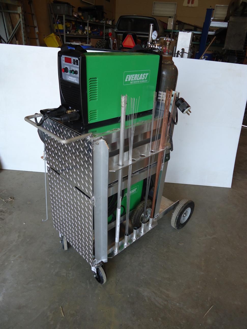

]Well i have finished with my cart, i added many other options to a standard cart design that i needed for my use. The cart was built from 2x2x.200 aluminum angle and .100 sheet, I added a drawer and got it functional.The next step was to make the plasma portable also for the simple reason it will go places like outside.I added a fold up door combo ramp and a couple of magnetic catches to hold the door closed. A little cart was fabricated from some angle and a couple of pneumatic tries i had and 2 casters added a removable handle to pull it around outside.I added some .060 6061 tubes to hold small amounts of filler rod on the cart. The to 2 angles on each rear upright were notched to make a place to hang the torch and the cord. I had a couple of SS Steel coated hooks with wood thread on them removed that and threaded them 3/8" -16 to hang cables on.My cost is less than $65.00 as the aluminum sheet and angle came from the scrap dealer.Attachment 7620Attachment 7621Attachment 7622Attachment 7623
