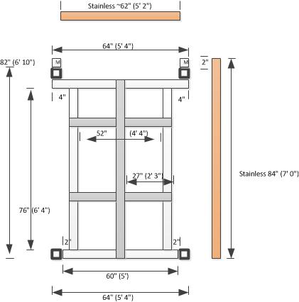

I'll post the drawing I did for my table when I get a chance (it's in Visio and I only have that at work).
I'll post pictures and prices since I'm trying to build a "hobby level table" at "garage project prices".

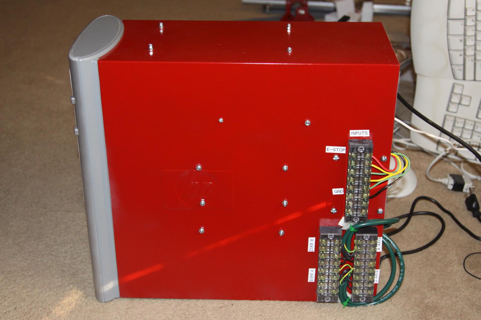

I'll go into more detail on the electronics side, since that information is harder to find when you try to do research on the internet.

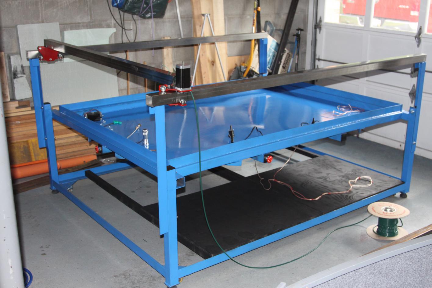

OK - this is starting to get exciting....
Got the gantry rail adjusters and gantry rail installed. All the adjustments went well and it was easy to get everything square and level.

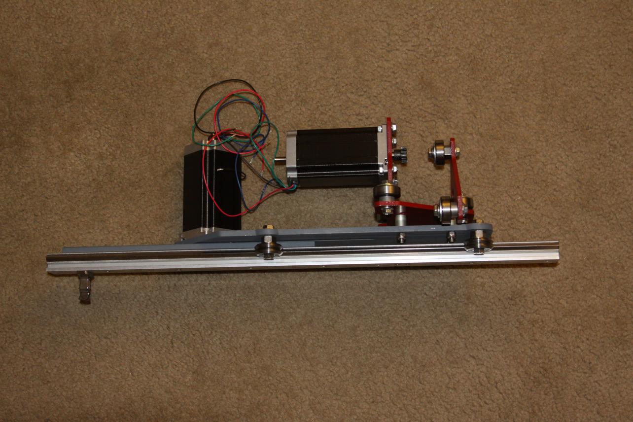

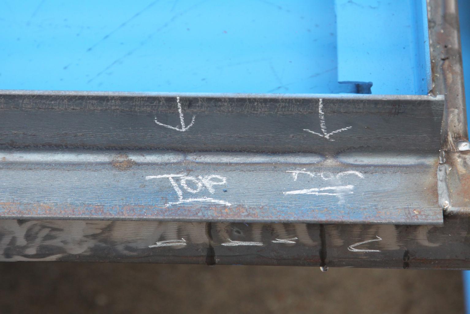

1 Attachment(s)
Oversight on carriage assembly.....
When I welded the carriage, I didn't think about the cross tube between the two x-axis.
I ran a weld bead along both the top and bottom of each joint. The top of the top joint is where the y-axis bolts on. The weld bead would have prevented any adjustment in length of the y-axis (it's a slotted plate).
Attachment 7772
A little bit of grinding and the situation was fixed.
