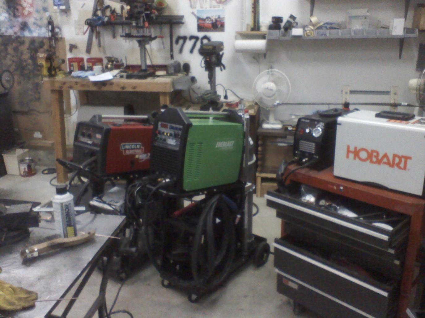

Fantastic ... thanks ... here is how my welding station looks nowAttachment 7196How cool is this?

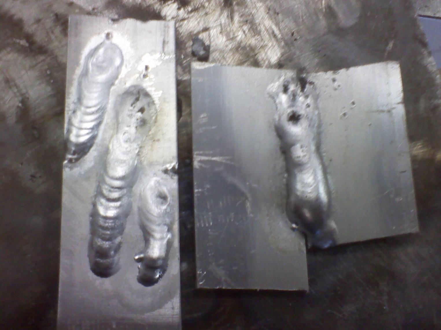

Here are my first ever attempts at aluminum tig welding ... I know they aren't pretty and I need to clean my aluminum better along with my first beads is my first butt weld ... I'll get it figured out eventually but I must say this machine just blows me away!Attachment 7197:O My DCEN on mild steel looks much better ... but I've been doing it for a while ... this AC TIG on aluminum stuff is brand new to me.
An old saying, practice, practice, practice. It takes time. And A/O does not always make aluminum come easy on TIG.
I would bump up the post flow or at least stay over then end of the weld and let the gas shield it at the end of the weld (one you release the power). Looks like you are pulling away when the arc dies.
You will want many beads to get the feel and see how aluminum melts and flows, not quite as colorful and clear as steel.
Keep at it man.

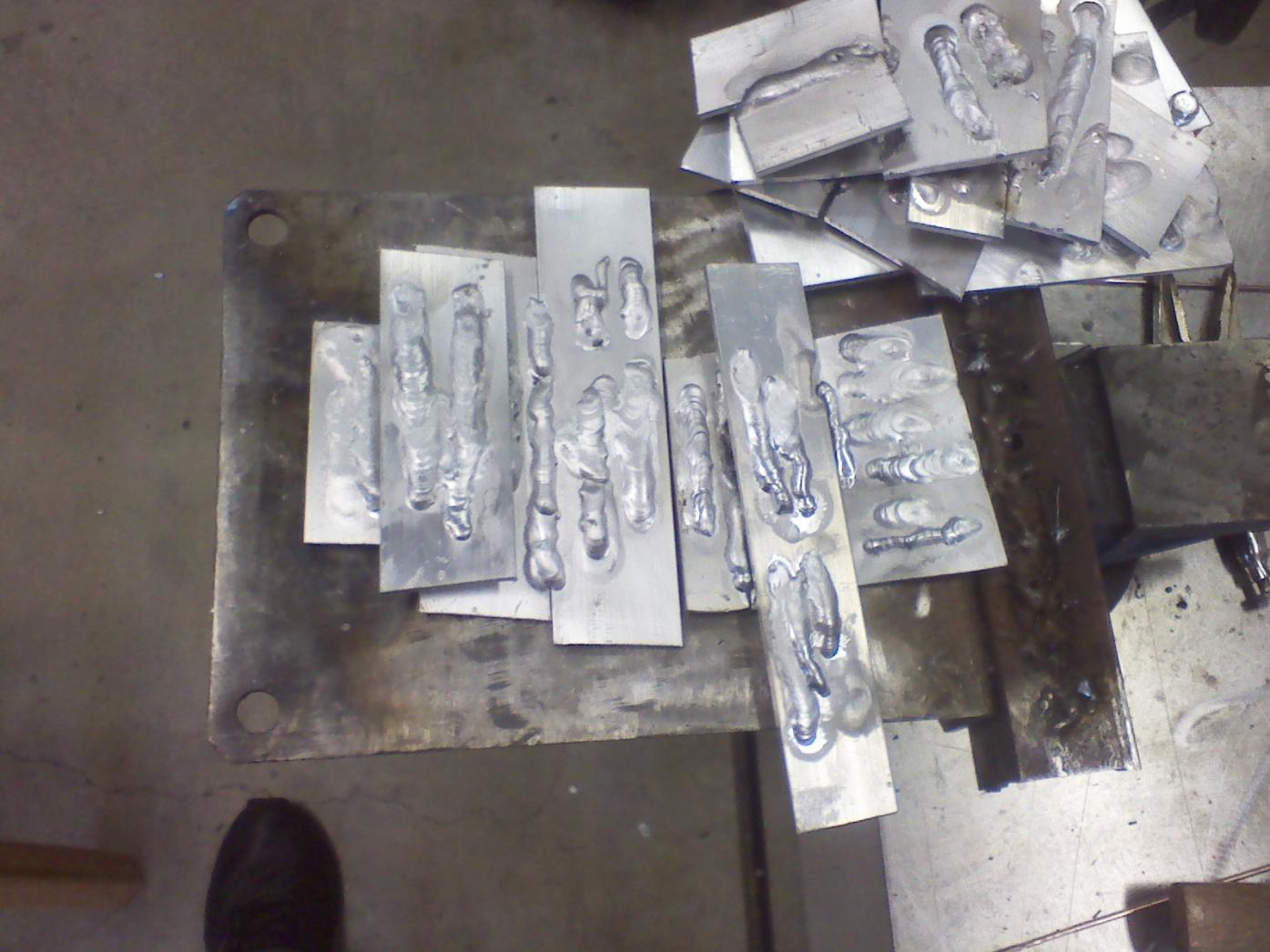

I know these don't look all that gr8 ... but no one can say I haven't been practicing ... I have to go get some more argon now lol.Attachment 7209 This is just a fraction ... I've been stacking beads all over the place.
My, my, you have been very busy! How's the welder's performance? Everything you expected? Certainly looks like you are having fun.
Are you getting some aluminum time in because it is new or because your next project will need it?
Winkey, I can say you are 100% right lol. It takes time if you jump into the harder stuff.
I would think about going back to steel and practice and get the feel of TIG there, then back to aluminum. You can see a lot better with steel and get the feel. Aluminum is not easy.
