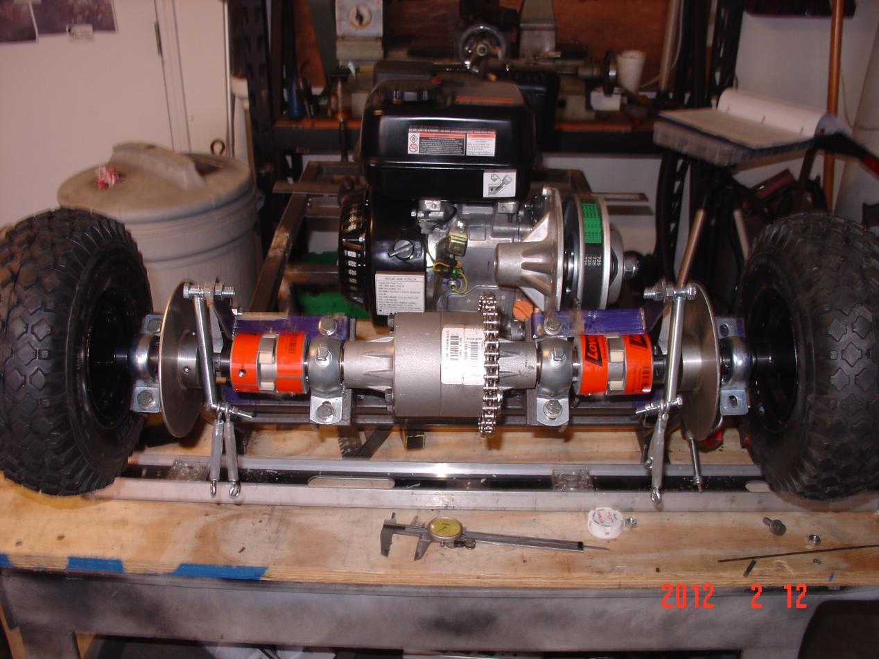

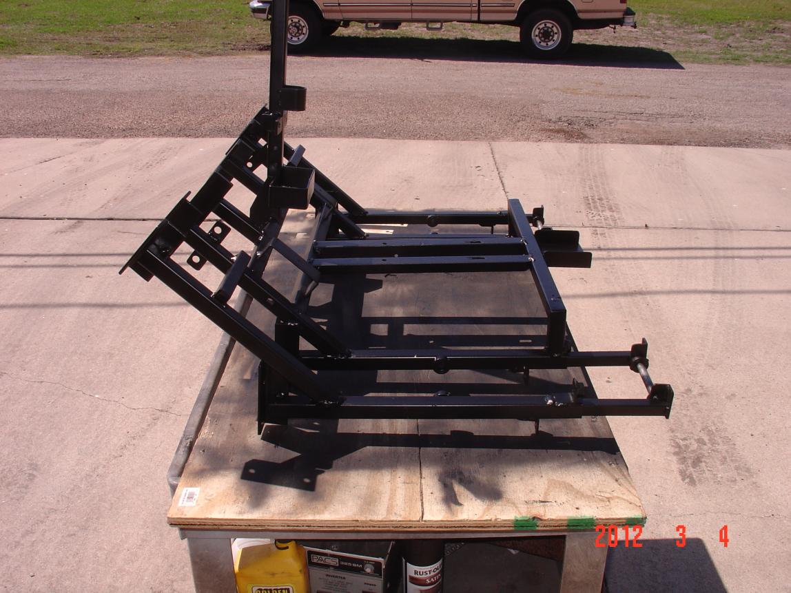

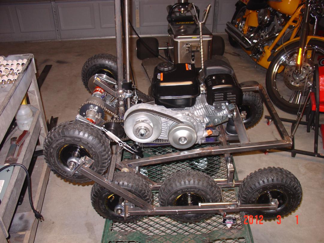

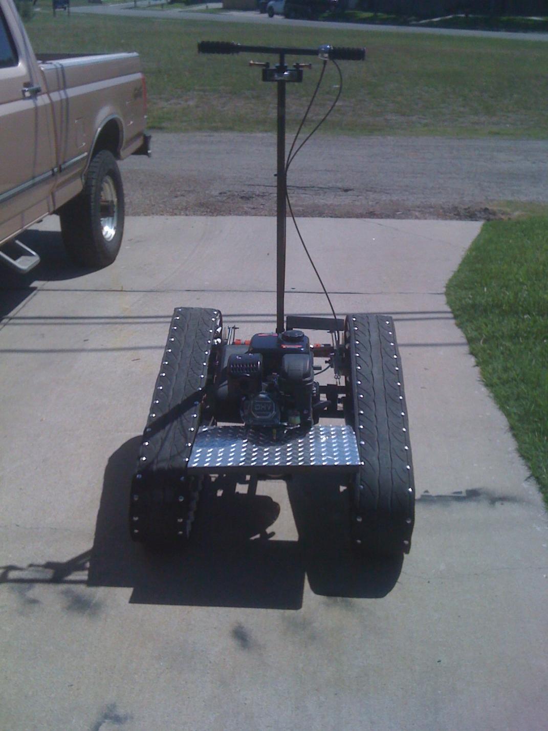

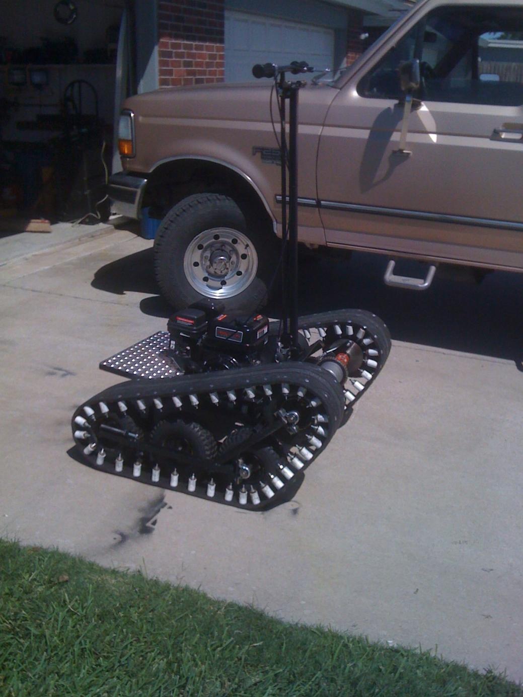

Here is a project I have been working on. Still working out the bugs,but it is a lot of fun!
http://www.youtube.com/watch?v=XBq3MO0eQ1cAttachment 7029Attachment 7030Attachment 7031Attachment 7032Attachment 7033

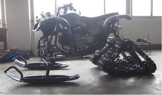

http://www.atvtracks.net/atv-tracks/tjd-atv-utv-tracks , I haveAttachment 7063 seen quads and some sand rails running track kits up in big bear California there cool

The tracks on the personal tracked vehicle are made from used car / truck tires.
Interesting project,,but I wouldn't drive the stand up model without a helmet,,driven too many tracked offroad vehicles in my lifetime to know that sudden turns or bumps can lead to problems,,,Have thought about making something similar for moving a small portable auger around,,to simplify to the drive system I would use a hydralic pump and orbital motors,,,the advantage there is you can reverse one motor and forward the other at the same time for super tight turning,,,basically the same as the drive system on my minihoe..tracked vehicles are always exciting to drive,,,but they can be deadly cause of the lack of suspension...neat toy,,,would be good to have it remote controlled for doing yard work..

Your bottom wheels need to float on a dolly to accomodate bumps and rocks...and it would be a monster. A little bottom armor and front armor, and it could be a modern military chariot, for the infantry. Moves fast and light. But I am still thinking it needs to accommodate bumps and rocks better by a floating undercarriage.

Is it just me or does the center of gravity seem really far back on the unit. Looks like the rider just has to lean back a bit and the front lifts right up.
