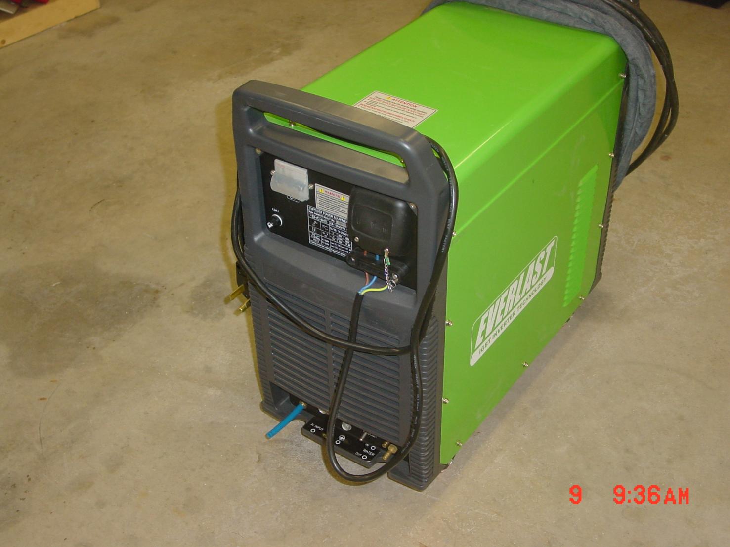

I just fired it up once. This thing is smooth and has a nice clean ark. I need to get a new welding helmet because I have a cheep auto dark helmet that works fin for MIG but did not like the pulsing I played with on the TIG. I am waiting for a gas regulator and could only make it work with a small leak. Could not get the fittings to allow a hose barb on my current regulator.
Anyway this thing his huge. Check out the size compared to my Millermatic 252.

Nice ! It's a much larger machine than I had imagined. Thanks for the pics.
Umm... someone's sewn their trousers round ya torch lead. :P
Yes those that is a genuine dungarees.

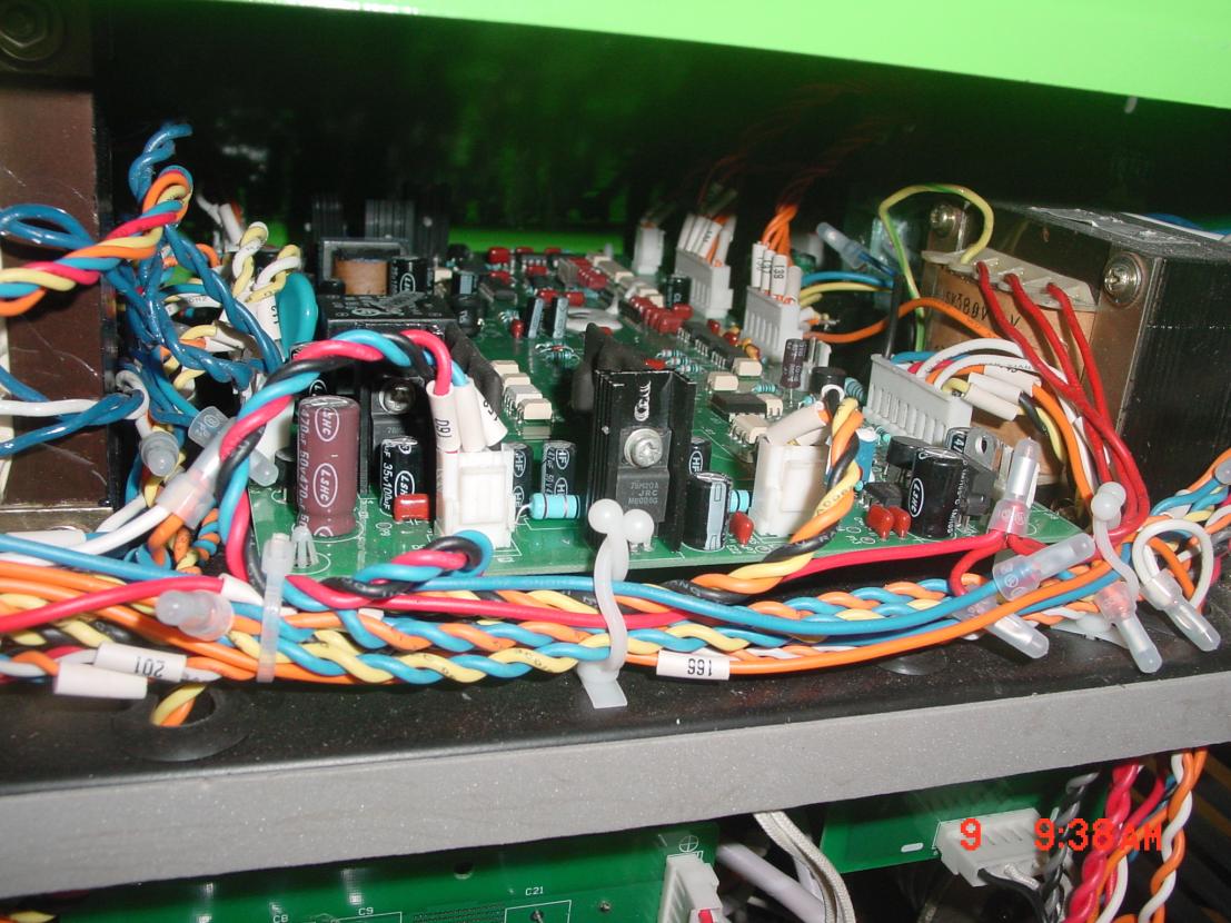

I opened up the top to see the plug gound (did not get a picture) and the boards fill the entire width of the welder. I suspect it is to make the control boards common among the 250+ amp EXTs. From my memory I thought Everlast had the 315EXT and a 400EXT were going to come out at some time. If that were the case, the room would be needed for the extra boards.

So my welder came with this orange tube about 1/8 inch diameter, anyone know what this is for?

Mine just arrived, a few questions-
1- what are the orange tube, the blue tube, and the 2 prong thing with the chrome ring?
2- where is the pedal and the flowmeter/regulator?
3- Is this the proper power cord? It is marked 16amp-250volt.
the cord itself is marked 2.5mm. that is between 12 and 14 gauge
4- should the individual strands be exposed on the power cord where it enters the welder?
5- There is no switch on the back for remote control / panel control, how do you switch?
I was going to put on an 8 gauge cord, how do I fasten the ground???

Couple quick notes of explanation... The unit does not come with a cord as a factory standard item and was a point of confusion that we identified before they shipped the units. They threw it in in a hurry to get things shipped. It'll work though. Notice the effective current draw. That combined with the NEC's specifications for derating their standards for duty cycle limited machines means it should be well within the standards. The I1max is a temporary start up demand not likely to heat up the wire or cause issues. Where you see it connected to the rear, that is where it was originally intended for the customer to take over. When we figured out what was going on, we asked them to put a cord on the end of the machine. Its a first shipment and there is always going to be minor issues like this. The cord is fine if you cut the plug, but I'd suggest that customers put their own on the unit, tying in at the back. Green/Yellow is the ground on this line. Other two are hot. This is a european plug. Wire is fine though. The piece of plug you have in the box WAS the original plug that was used for the orginal test design, without a foot pedal. They included it because they were going to include it anyway. The line I believe, is for installing the water line back into the unit, which we deleted...for safety concerns. Other than that, I have no idea and should have no bearing on the operation or use of the welder.
The switch missing on the rear was a last Second change quite literally before they shipped. We sent our specs on our foot pedal and they had a different one they wanted to use. Theirs needed a switch, ours do not...ours are wired so that the plug itself acts as a switch when the unit is plugged in...
Edit, yellow wire is connected internally inside. It should be screwed to the case inside...however, originally the third slot there was going to be for customer attachment of ground, but when they put the plug on it, they just went and connected directly. If you see the manual, that is how it should/would have been connected and it should still be capable if you'd like. 8 gauge is a suggestion, not a requirement. Post up pics IF you do decide to change it.

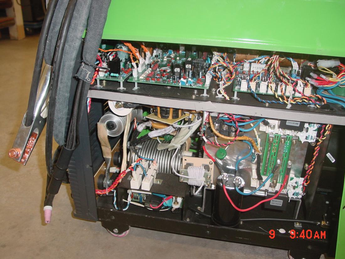

Also, anyone got any pictures of the inside? I'm sure others would love to see what it looks like under the cover as well. ;)
I'm curious which components are substantially contributing to the 140lb rated weight of this thing... Big transformers? Massive heat sinks? Thick gauge steel frame? All of the above? That mass is coming from somewhere.

By looking in the front of the lower portion of the welder there are some thick conductors. I will work on getting some pictures of the inside when I change out my cord.

It is a larger unit, but there is no wasted space, it is built very industrial. One of the heat sinks is a solid machined aluminum block 12" high 10" long and 1/2" thick with huge fins hanging off the back. The other heat sink is almost as big. The fan is large, about 10" diameter, it's louder than I would like, but I am used to my silent sycrowave, where the fan only turns on once in a while. The fan is a little louder than the syncrowave when its on, about the same as a millermatic mig and quieter than a hypertherm plasma. With the wind tunnel design, I can see why there is a need for constant air flow, but a 2 speed or variable speed blower would be great for when the unit is sitting idle.
There is a flow switch in the water line that has me scratching my head, I've only been using the unit with a gas cooled torch until my cooler arrives, but I am curious to the function of the flow control, it must be some sort of torch protection.
The cover is a neat 3 piece design, any one panel can be removed while leaving the others.
Here's a bunch of pics -
Attachment 4111Attachment 4119Attachment 4118Attachment 4117Attachment 4116Attachment 4115Attachment 4114Attachment 4113Attachment 4112Attachment 4120

NOW as for the orange tubing, it is for use with an argon regulator. The tubing slides over the rear hose barb fitting, and the brass fitting screws to the base of the regulator. This helps prevent that "burst" that we see sometimes with the softer tubing. It is something they threw in. I do believe from the looks of it, when you receive your regulators, that this will fit up to the base of ours.
