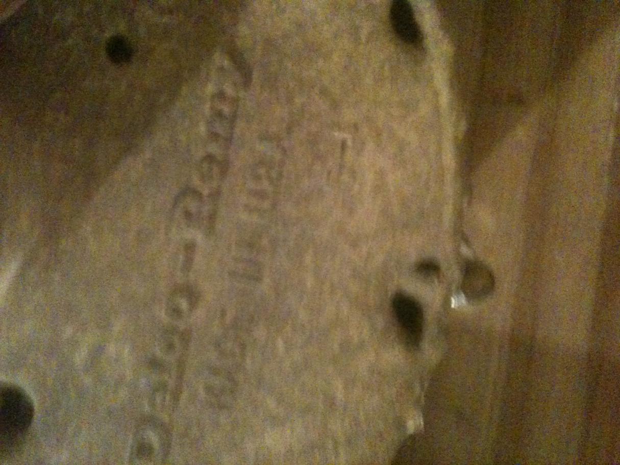

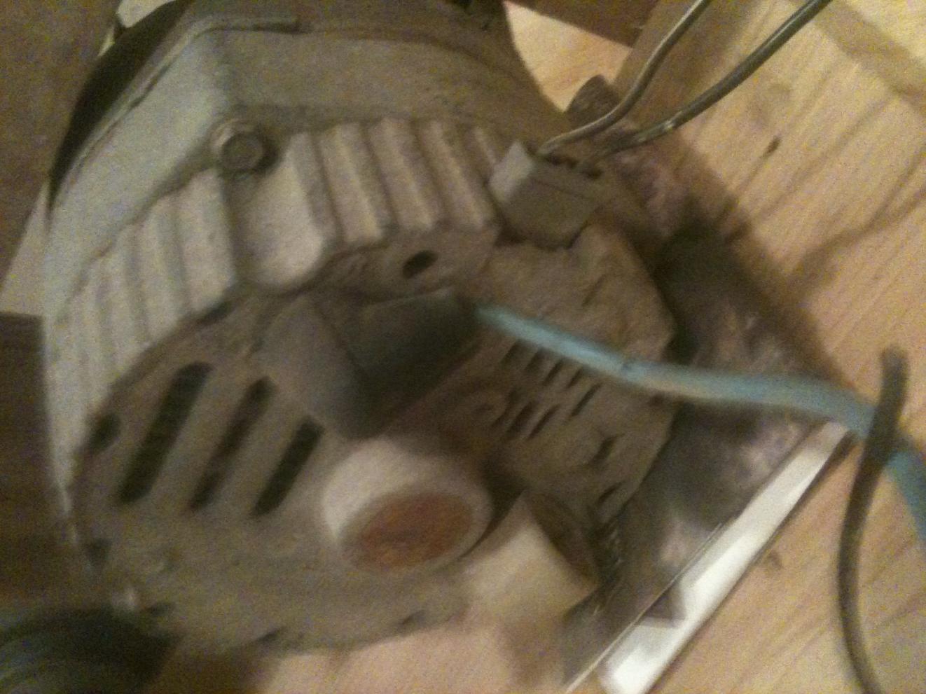

Well I dont know if this one is internal or external regulated, so heres some pictures, Im guessing its internal. Its pretty old. I dont even know how many amps it is or anything.
Attachment 3281Attachment 3280
I don't think any of the AC Delco's put a amperage stamp on it. Just a guess, 60 or 70 amps. I have a 119 amp ac delco remy on my "roach" It has a much bigger power + lead. I just searched my self mad trying to find any specs on it..nothing really. except they are selling a "guaranteed fit" alt that is 60 amp. I believe your alt should be relatively close to that. Looks really close to mine. Kinda does look like an internal unit..

I dont think so either. My guess is its about a 50 amp or so. But thats still enough to burn 3/32 6011. Be good just for field quick repairs and suck. So the first step is seeing if it still works though. So i built a stand for it, its hooked to a moter. So which wire powers the field then? And does anyone know what the other one does.
It should be external. You see the two wires coming out of that plug on the side. Those wires should go strait to the brushes to control the field. That looks like an older GM unit. I've no idea how many amps they are but I'm thinking they're not very much. I could be wrong though as I'm not up on GM alts. But yes, your battery charger or 12v supply(will need to put out 10 or so amps to get full power from the alt) would hook to the wires on the side, I used an old dash-light dimmer switch(it's a rheostat not a potentiometer) to handle the current from the charger, and vary the input voltage so I can vary the output current. Your TIG torch would hook to the case of the alternator(The Negative) and your work clamp would hook to the positive post on the back of the alternator where that heavy blue wire is now. Then you just need a beefy engine to keep it spinning under load. Good luck!
Good question. I'm not sure, because mine is one wire so it obvious. They both may be power wires. Or one may be for 6volt and the other may be for 12. When I was researching it, I found a lot of those trucks had alts that were for both 6v and 12v. IDK how close you are to any town...but you could try a generator alternator repair shop. Or a garage that's been around more than a week. The repair shop should be able to tell you. If not, PM me everything you know about it and I can call my guy up here. or i can PM you their number whatever works sweet for ya.

That one looks like an internal regulator. If memory serves, the way to tell on the old GMs is to look at the orientation of the plug terminals. If they are parallel with the shaft, it's external, if they are perpendicular, it's internal.

The picture of your alternator seems to indicate that's it's internally regulated. If so, you do'nt need to remove the regulator. Just bypass it.
See that little D shaped hole in the back of the casing just to the left of that 2 wire connector ? Have a look inside that hole, with a light if need be. You should see a small metal spade lug, just like the ones that your above-mentioned connector plugs into.
Those three lugs are part and parcel of the regulator and the one behind the D shaped hole is to test the alternator output. If you short it to ground, (the alternator case) with a screwdriver, you effectively bypass the regulator and maximum output is produced.

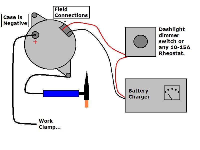

The diagram posted by Blasphemy000 above is correct.
So if you have an internal regulator and you disable/bypass it as above, and you hook everything up as per the diagram, it should work fine.
Yeah. The motor im gonna put it on is a 11 hp. My idea is just make it to where I can drive the mower over where i need to weld. Engage the altornator. Be able to weld something and go on. And yeah im not gonna do anything more than i have to. The only hard hard part on it is if its internally regulated then Taking it apart and undoing the regulator.
Ok rivets your just saying to ground out whats behind the hole and it will bipass it. Would you have to keep the screwdriver in there. Im confused?
Wiring Diagram:
Attachment 3286
Before you go ripping into that thing, I would seriously wire it up like the above picture and check the output voltage. If it is internally regulated, since it has two field terminals it might require external voltage feedback for the regulator to work. If it is wired up as the picture above there is no feedback voltage going to the regulator. If it has an internal feedback you shouldn't get that much voltage from the output terminal to the case when it is wired like the picture above. With mine wired as above and 12v going into the field, I'm getting around 100v between the output terminal and the case. That will be a very quick and easy way to tell if you're going to need to defeat the regulator or not. Another thing I would do is find out for sure how much amperage that thing puts out before you go putting a lot of work into it. If need be just go to the junk yard and pick up a 90A Chrysler alternator from a mid 90s Caravan with the 3.0L engine(that's what mine is from) or figure out what kind of Ford vehicle their 130A externally regulated alternator came from then you'd really have some power to play with.
yeah im definatly gonna hook it up first. See what she will do. If i had to guess from what it was out it will be about a 50 amp. Because it was out of a 70s truck. So it didnt have a whole lot of power consumption. And o i see what you mean. Without it hooked to a battery where the positive goes it might not activate the regulater. And I would really like to do that. Be really nice having that extra power.

My last post above has a significant OOPS, so you can't hook up as per Blasphemy's schematic, because I forgot about the diode trio.
Unfortunately, you'll have to open up the cases and dive in.
See schematic below. (The 12 Volt Doctor's Alternator Book - Edgar J. Beyn - Spa Creek Inc.)
Remove the diode trio, and while you're at it solder a lead to the test lug and route it outside the case where you can easily ground it. Then you don't need a threaded hole.
Also, the + charger lead goes to lug #1 and the - charger lead goes to the casing and NOT to lug #2.
You can also remove the regulator, but then you'll have to connect leads to the slip rings and bring them outside the case.
